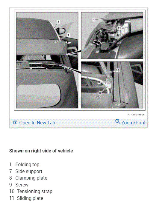

Has an issue when closing and i found one of the cables is getting interwoven on one side, in order for me to fix it i need to unlatch the back portion of the top. First the two moves back like a sunroof, and then it is supposed to unlock the back portion, i am trying to find if there is a way to do that manually.

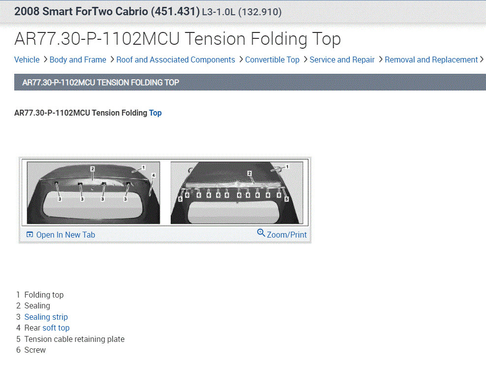

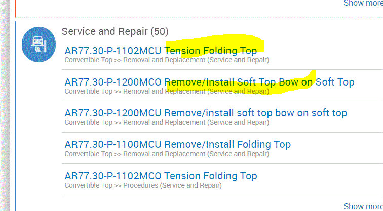

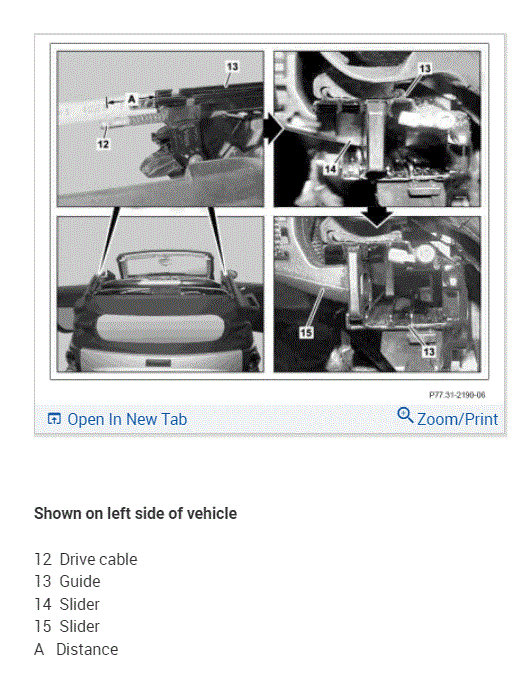

I tried to find the directions in my manual, but it's providing a few options. Could you take a look through the pic below and let me know which you feel would be most beneficial for you.
See pic below.
May 20, 2022 at 8:28 PM
DIVIDES
  • 903 POSTS
No idea, but 1st, 2nd or last may be it.

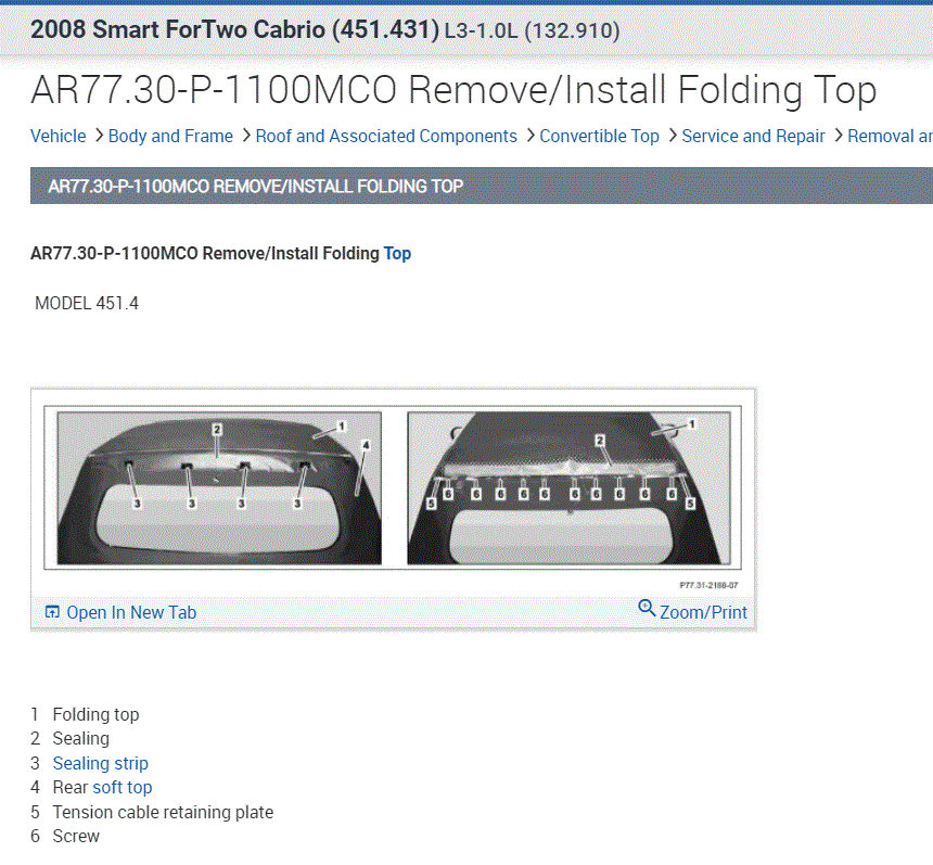

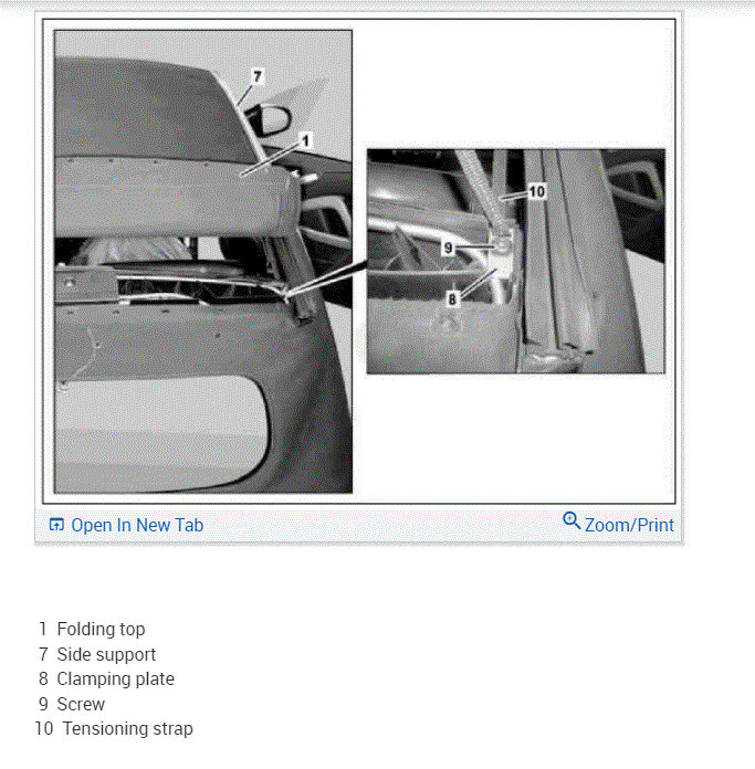

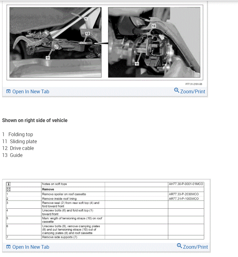

I attached the first one below. Take a look through it and let me know if this helps.
See pics below.
May 20, 2022 at 9:58 PM
DIVIDES
  • 903 POSTS
That doesn't.

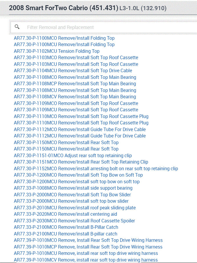

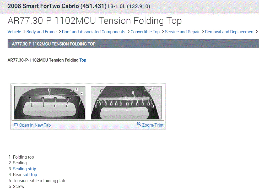

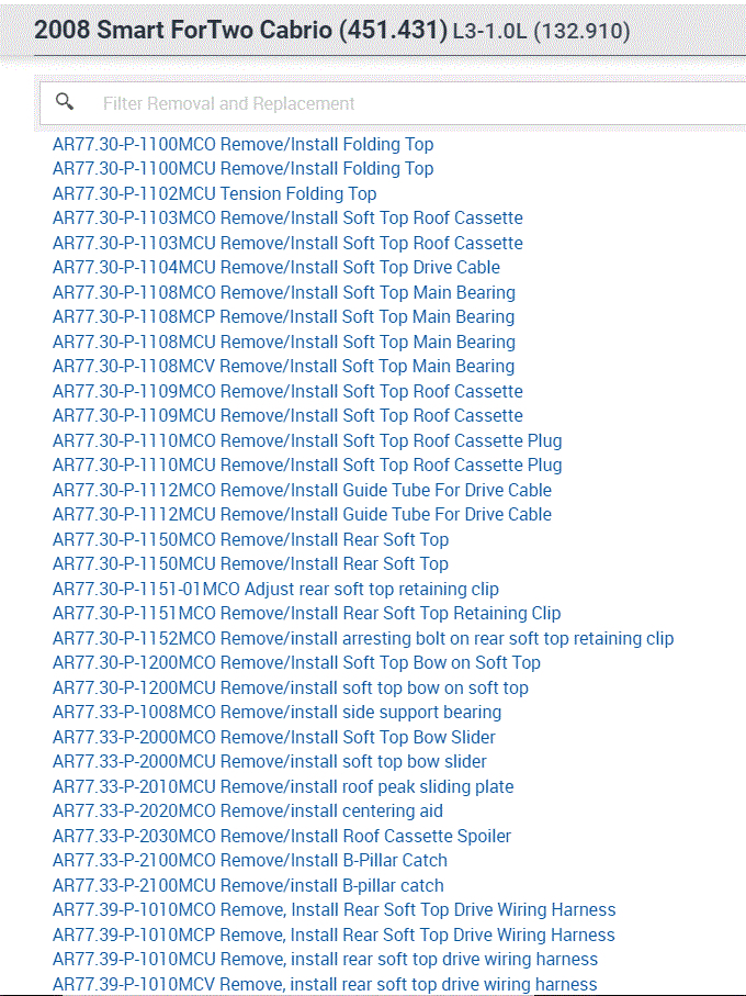

I just looked through the others, and don't see how they would be better. So, I had to break it down further. Take a look at the pic I attached below. It covers everything I have. Do you see anything there that would help?
See pic below.
May 21, 2022 at 8:31 PM

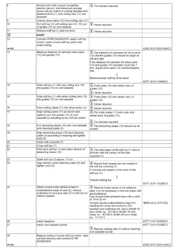

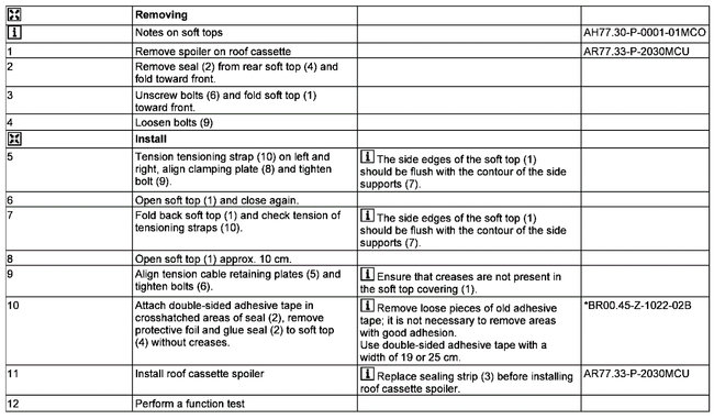

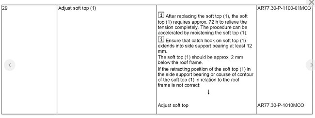

How about how to replace the whole top?
May 26, 2022 at 7:33 PM

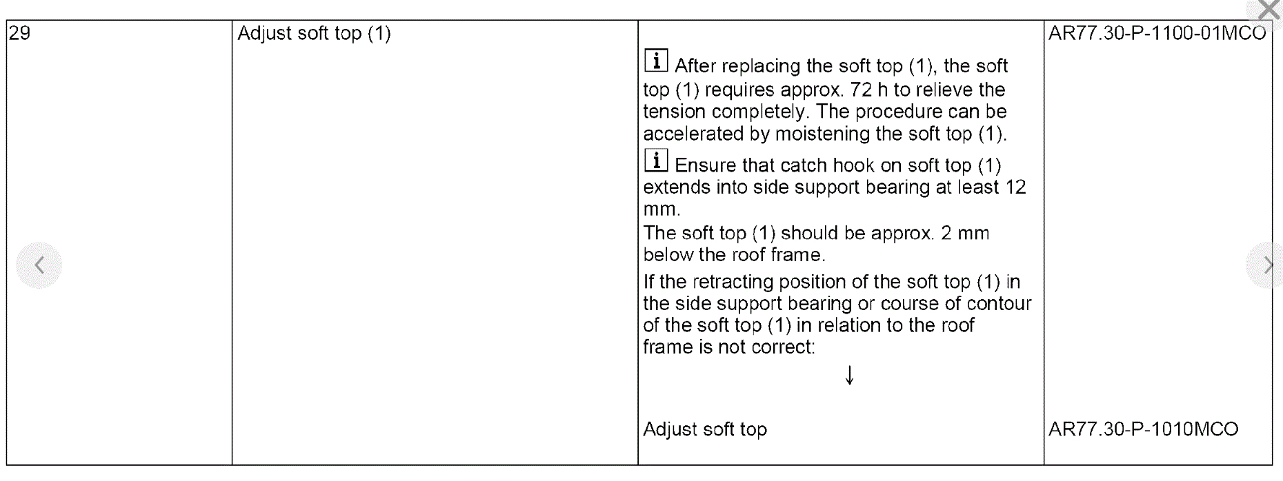

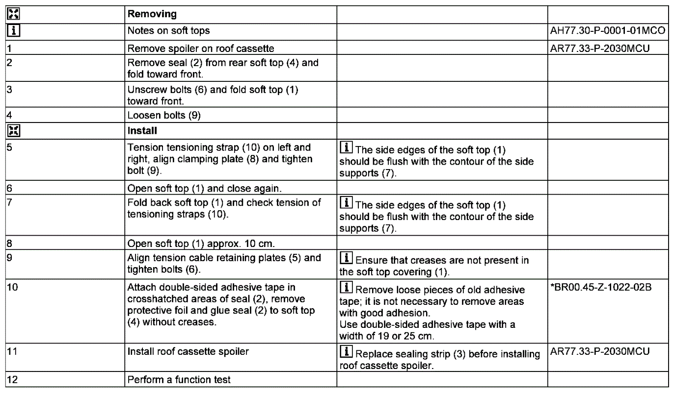

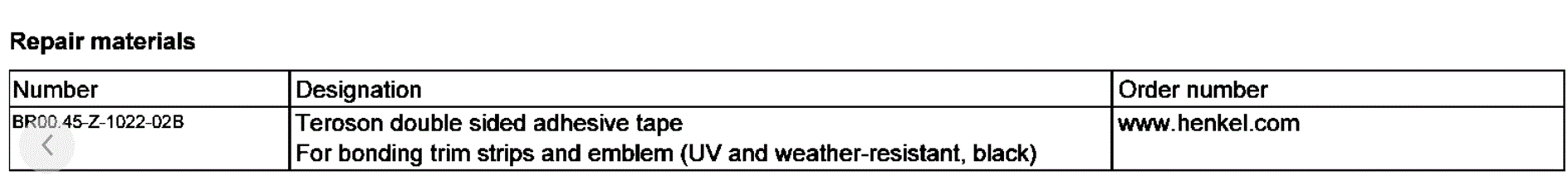

Here are the directions in my manual. Take a look through them and let me know if they help.
See pics below.
May 27, 2022 at 7:56 PM
