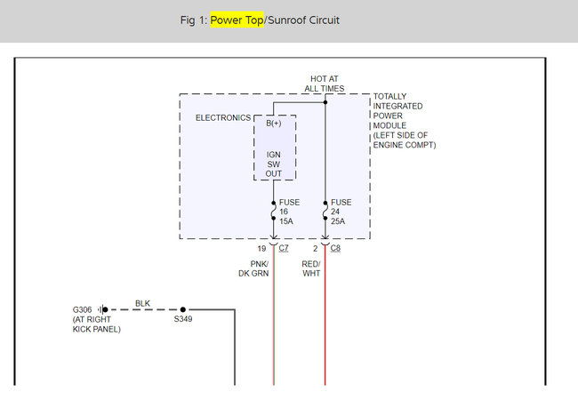

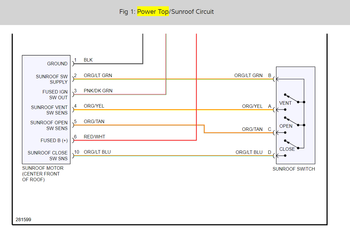

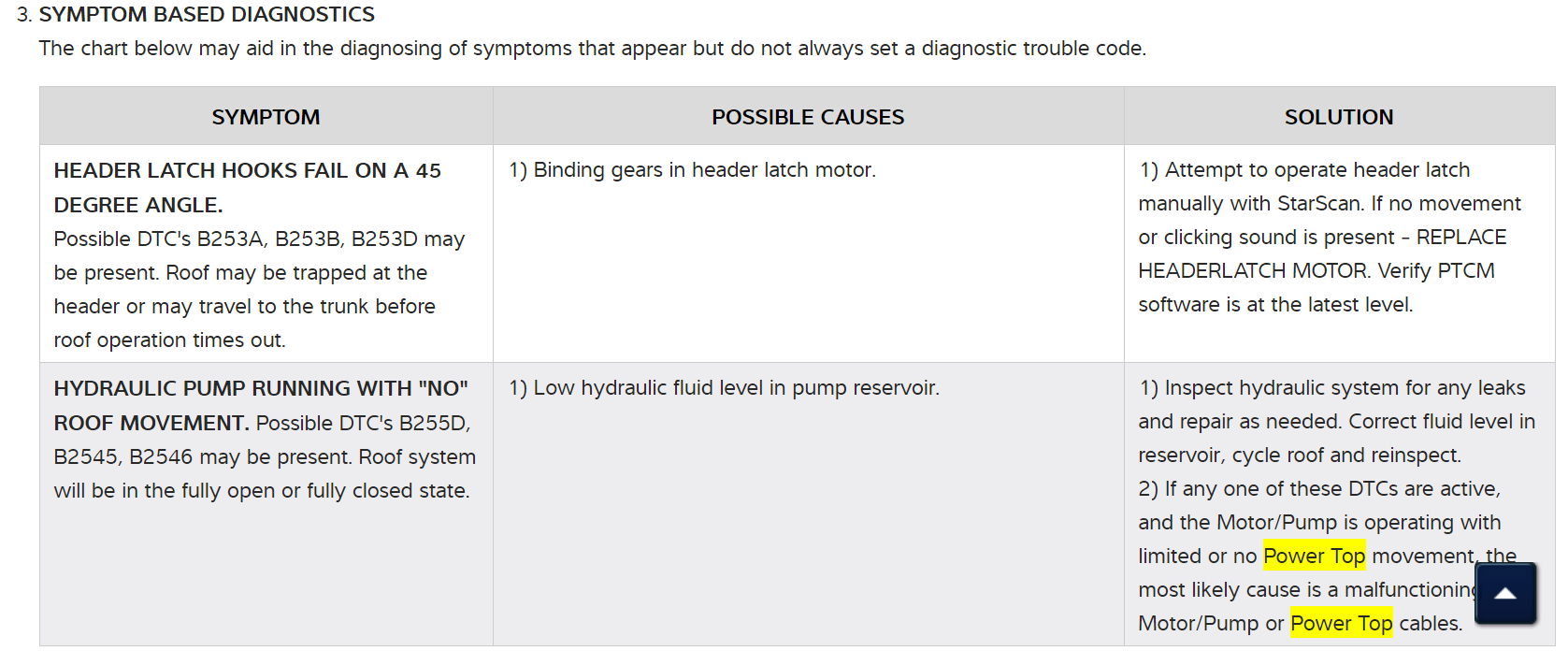

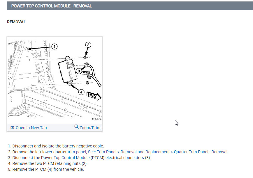

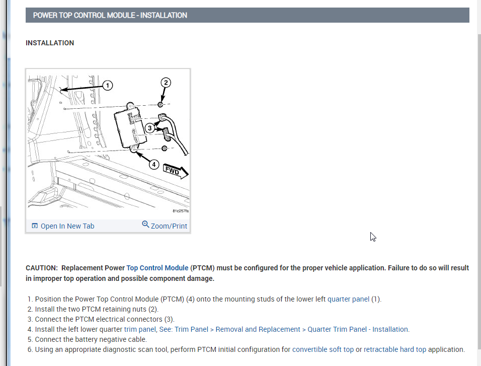

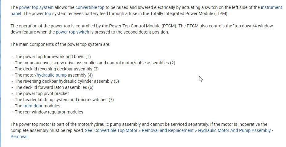

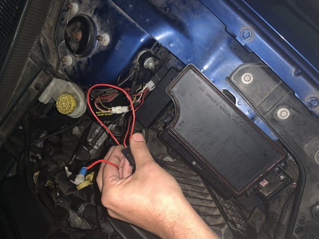

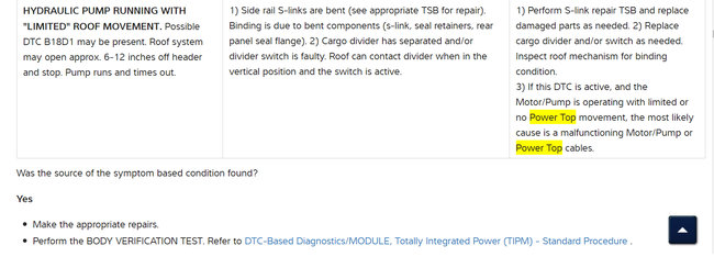

I've replaced the hydraulic motor in the truck. The up and down power switch on the dash. The overhead latch assembly motor and nothing happens/ works. I've plugged in the old latch motor and press the button and it doesn't turn the motor. The new motor will not turn either. I've checked the fuses and the looked good. Even replaced a few, still nothing. The windows are suppose to go all the way down before the top lifts but the windows only go a 1/3 of the way down. I'm stumped!
