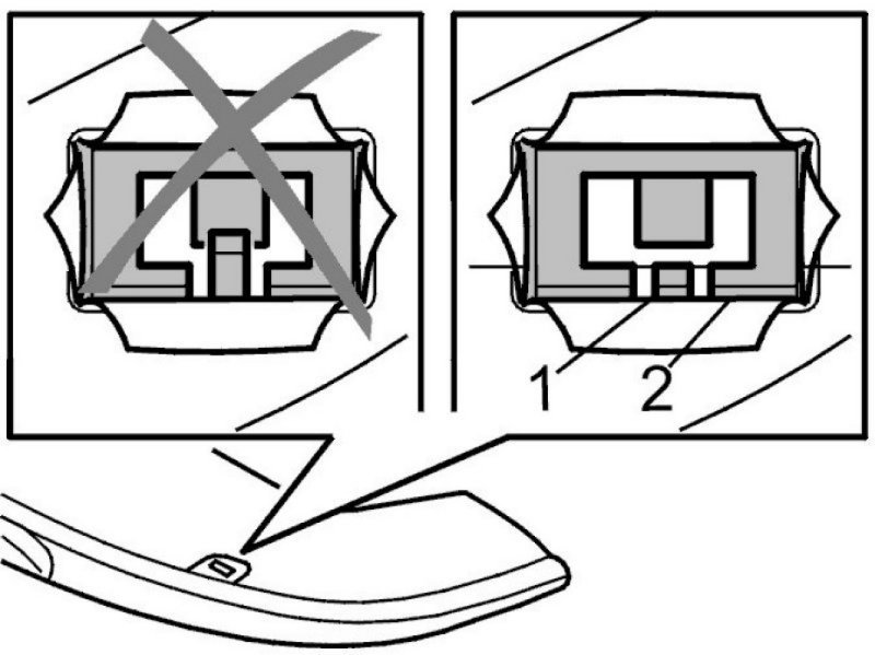

Adjusting the engagement position
- In the engagement position, the front edge of the lock catch and the edge of the tensioner rib lock side piece must be parallel
- Save this position by pressing [YES] , press [NO] to move to the next or press [EXIT] to end the calibration

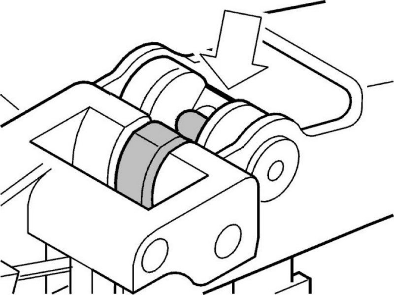

- Lower the tensioner rib
- Tension the convertible top by operating the rear latches.
pic 3

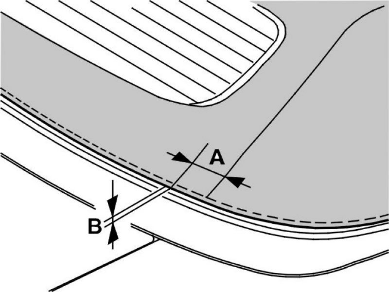

- Measure the distance between the fabric and the plastic strip at the lower edge of the rear of the convertible top
- The measurement points are 80 mm inside the longitudinal seam on both sides (A)
- To achieve a seal, there must be a gap of approximately 4 mm between the fabric and the plastic strip (B)
