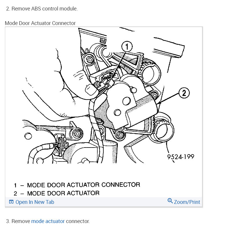

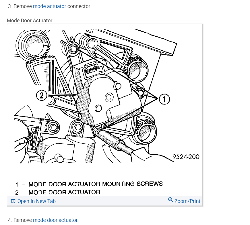

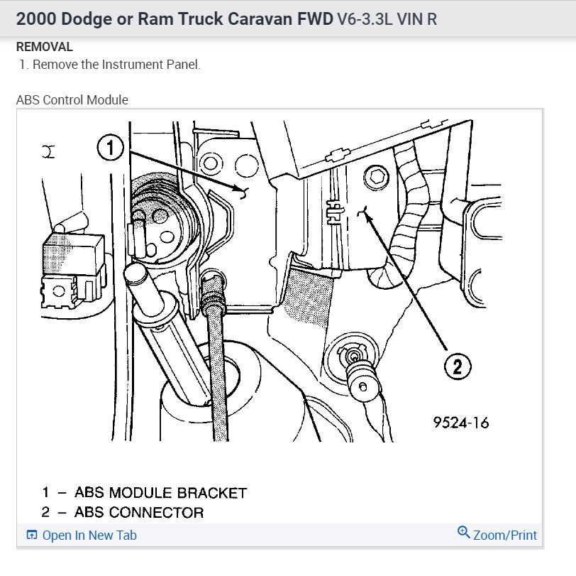

This sounds like the mode actuator is not working. but to be sure let's remove the actuator and turn the blend door pivot by hand to see if that fixes the problem. Here is the location of the unit that controls the mode function. This guide can help as well:
https://www.2carpros.com/articles/low-or-no-air-flow-from-vents
Check out the images (below). Let us know what happens and please upload pictures or videos of the problem so we can see what's going on.
