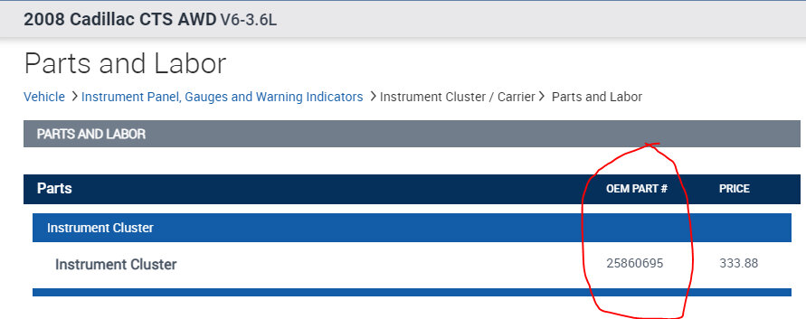

When you say control panel, are you referring to the instrument cluster? If that is the case, pic 1 below indicates the OEM part number.

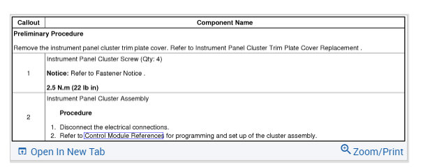

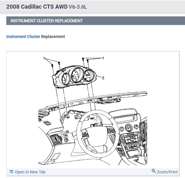

I'm not sure if you need them, but the last two pics are the directions for the removal and replacement of the cluster.
See pics below.
