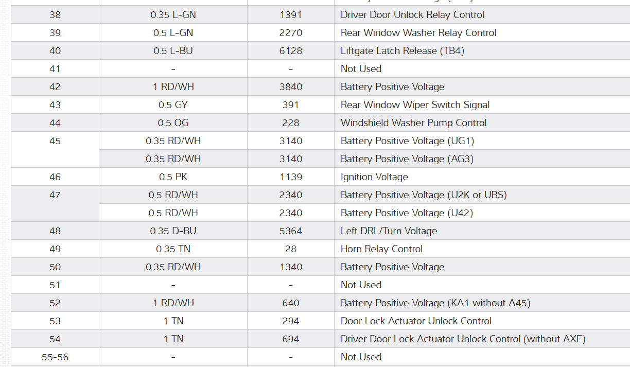

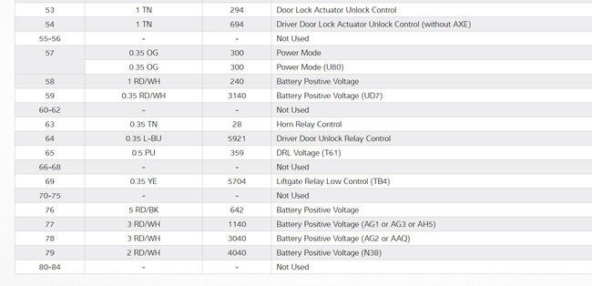

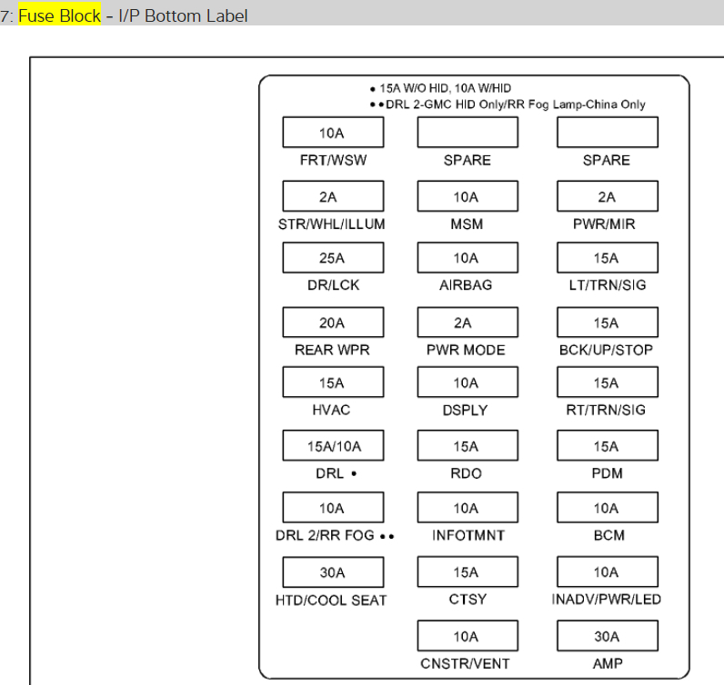

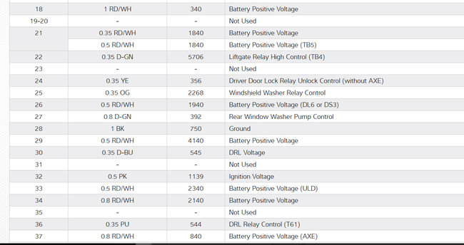

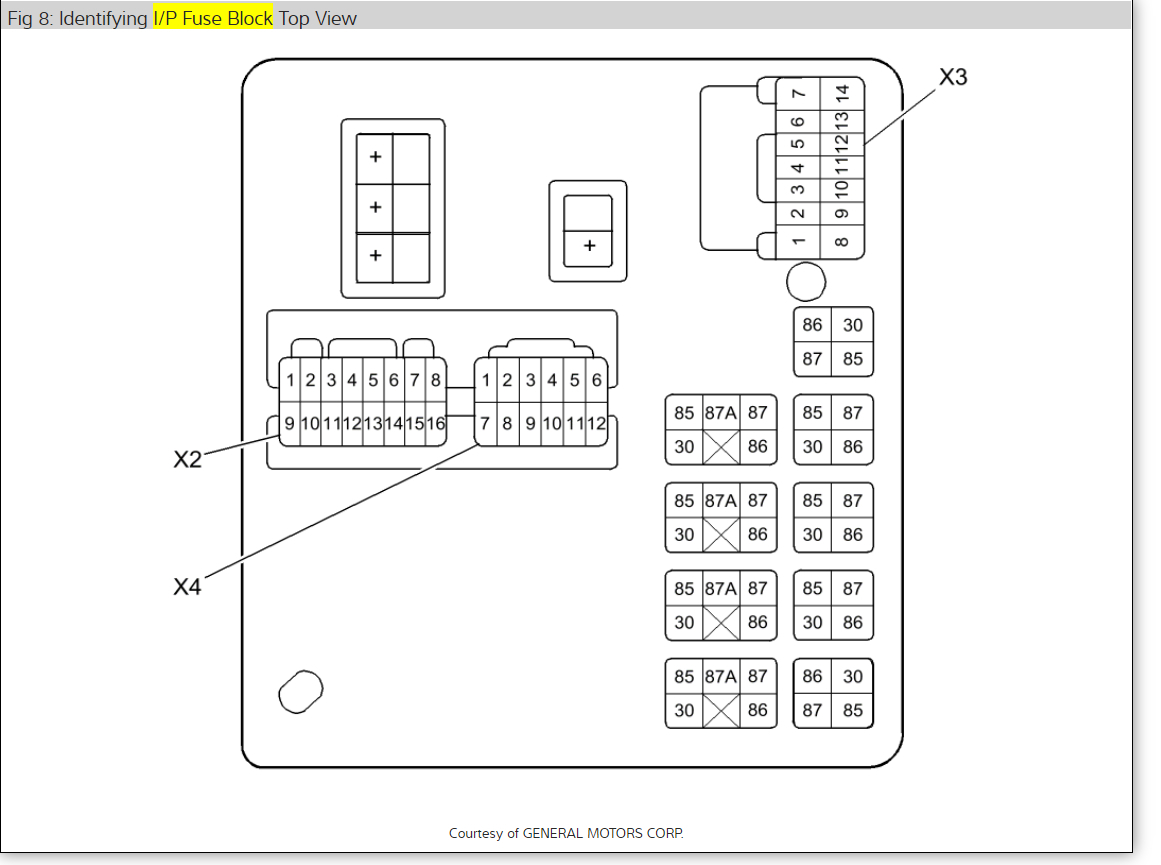

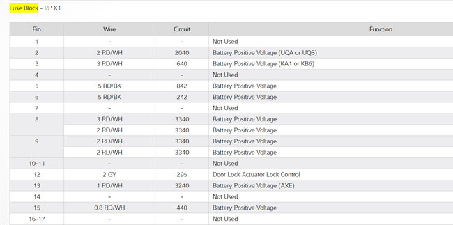

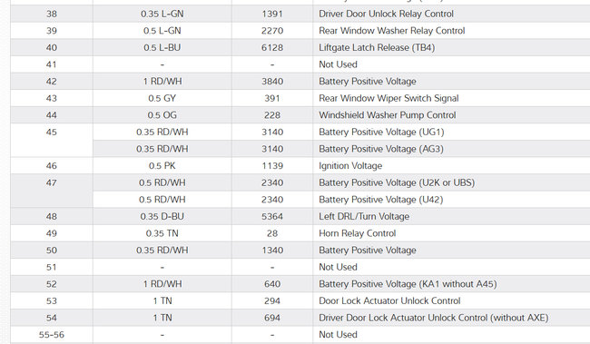

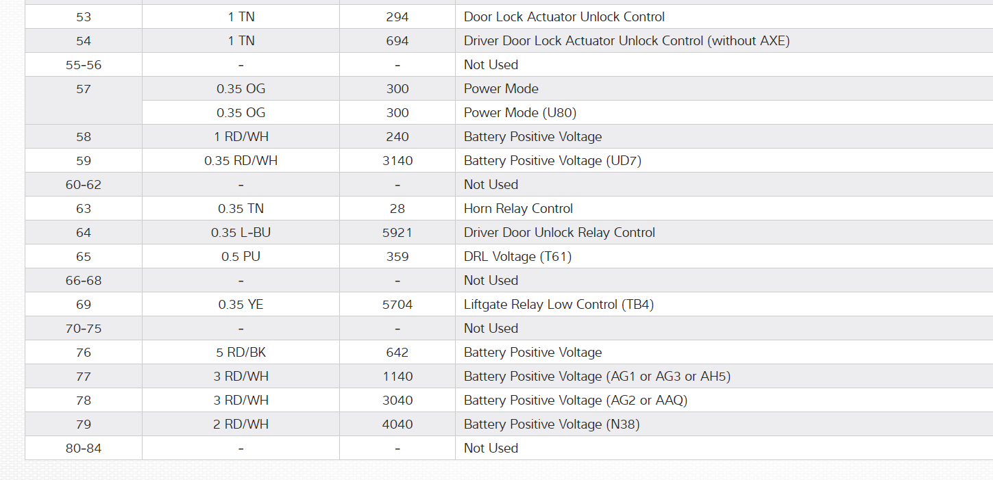

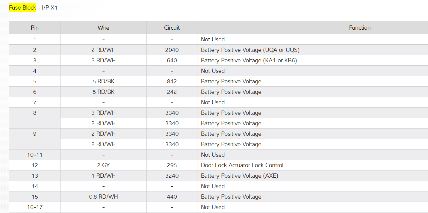

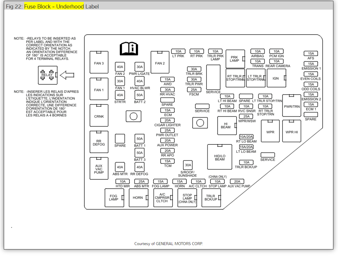

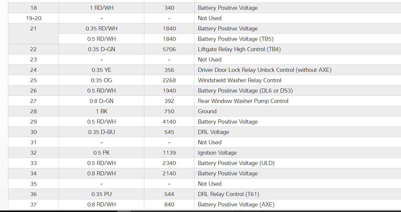

This codes mean bus A is not working which is the communication between computers is not working. This could be because a fuse let go or the PCM or BCM is out and needs to be replaced. Lets start by checking the fuses.
Here is a guide to help us get started:
Check out the diagrams (below).
