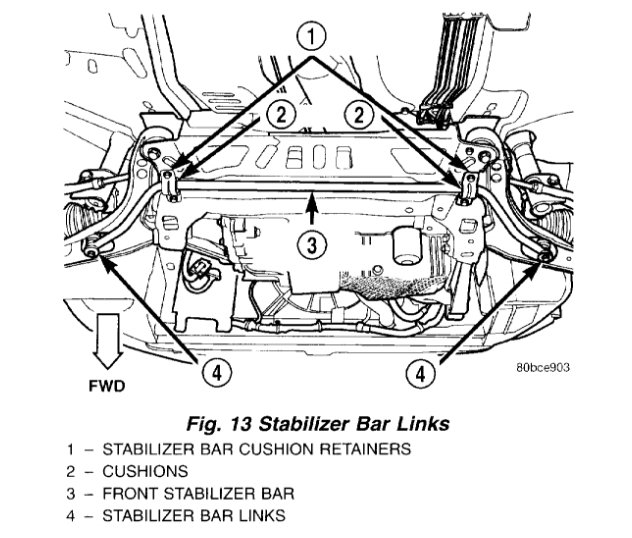

3. Remove both stabilizer bar links from the vehicle. Remove each link by holding the upper retainer/nut with a wrench and turning the link bolt.
4. Rotate the forward ends of the stabilizer bar downward. It may be necessary to loosen the stabilizer bar cushion retainer bolts a little to ease any turning resistance.

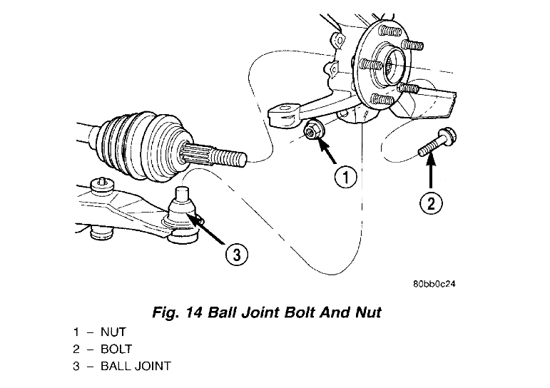

5. Remove the nut and pinch bolt clamping the ball joint stud to the steering knuckle.
CAUTION: After removing the steering knuckle from the ball joint stud, do not pull outward on the knuckle. Pulling the steering knuckle outward at this point can separate the inner CV joint on the driveshaft.
NOTE: Use caution when separating the ball joint stud from the steering knuckle, so the ball joint seal does not get cut.
6. Separate the ball joint stud from the steering knuckle by prying down on lower control arm and up against the ball joint boss on the steering knuckle.

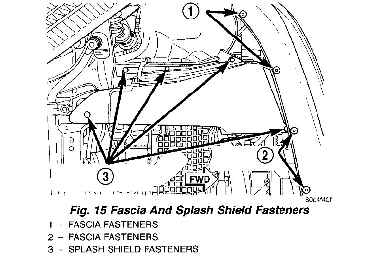

a. Remove the screws fastening the front fascia to the reinforcement as necessary in order to access the drive-belt splash shield forward fastener screw.
b. Remove the drive-belt splash shield fasteners. Remove the shield.

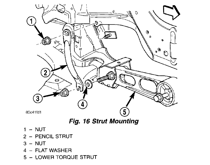

c. Remove the pencil strut from the right front corner of the crossmember and body of the vehicle. Remove the washer behind the strut from the torque strut bolt.
d. Remove the bolts mounting the engine torque strut in place, then remove the engine torque strut from the vehicle.

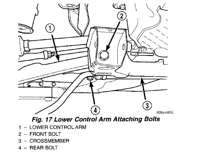

8. Remove the front pivot bolt attaching the lower control arm to the front suspension crossmember. Remove the rear pivot bolt attaching the lower control arm to the front suspension crossmember and frame rail. Remove the lower control arm from the crossmember.
