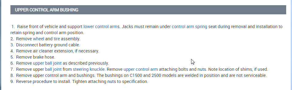

i just replaced my upper control arm bushings. the stock ones were welded in, do i have to weld the replacements in too?
Mar 29, 2019 at 5:05 AM
No. There is no welding as part of this process. I am sure someone welded that in because they either didn't know what they were doing or trying to prevent it from coming out.

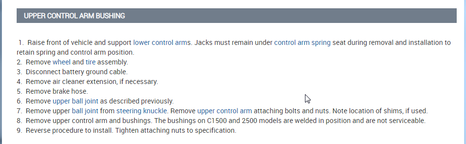

I attached the process for this for your review. Plus here is a guide that goes through this as well:
https://www.2carpros.com/articles/upper-control-arm-replacement
Let us know if you have other questions. Thanks
