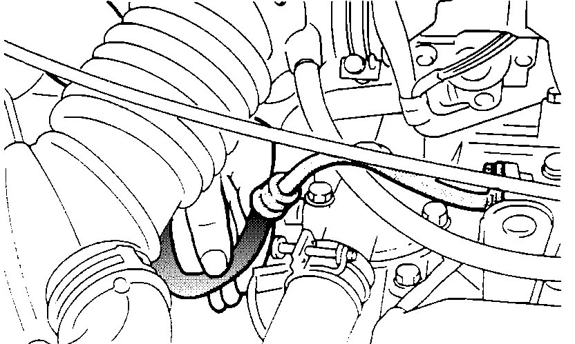

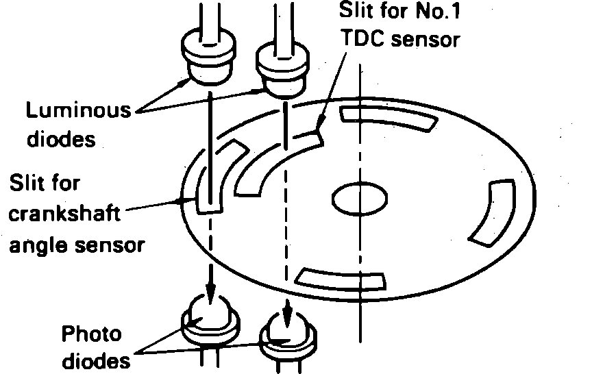

Distributor/Coil Assembly
Picture 1
The Crank Angle Sensor and the Top Dead Center Sensor are located within the unit housing. These sensors are incorporated into one unit, and consists of a disc and a pick-up unit. The disc is affixed to the main shaft and the light-transmitting unit is mounted stationary in the housing.

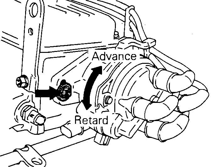

Crank Angle And #1 TDC Sensor
Picture 2
The disc contains 4 large slits around its circumference to indicate the crankshaft angle. An additional light-transmission slit located inward from the edge is used to indicate number one cylinder's top dead center position. The pick-up unit assembly uses two luminous diodes and two photo diodes, in order to detect the two different slits. There is a very slight clearance between the luminous diodes and the photo diodes, and the disc rotates within this space.
As the main shaft rotates the slits at the discs edge pass between the light and the optical reading part of the unit. The light emitted from the luminous diodes passes through the slits to the photo sensing diodes. When the photo diodes receive the light, they become conductive and generate a signal, which is sent to the Control Unit.

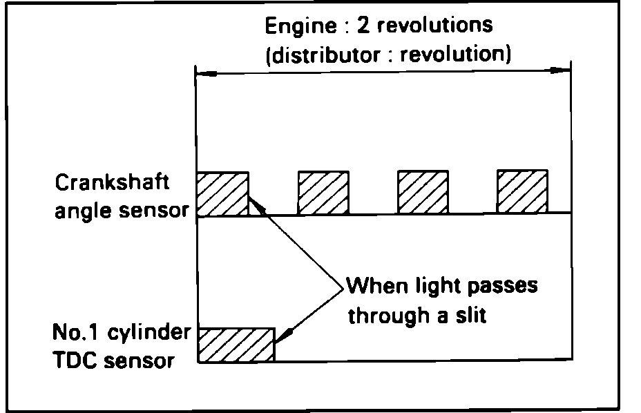

Photoelectric Signal Pattern
Picture 3
No.1 Cylinder TDC Signal:
Top dead center is detected by the signal obtained through the one inner slit of the disc. The MPI controller, based upon this signal, determines which of the four pulses from crank angle sensor is the signal for the #1 cylinder.

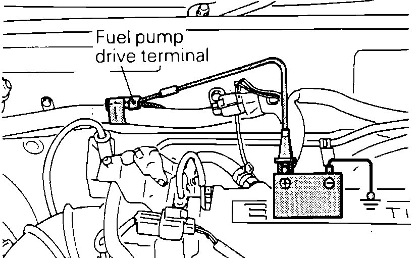

1. Turn the ignition switch OFF

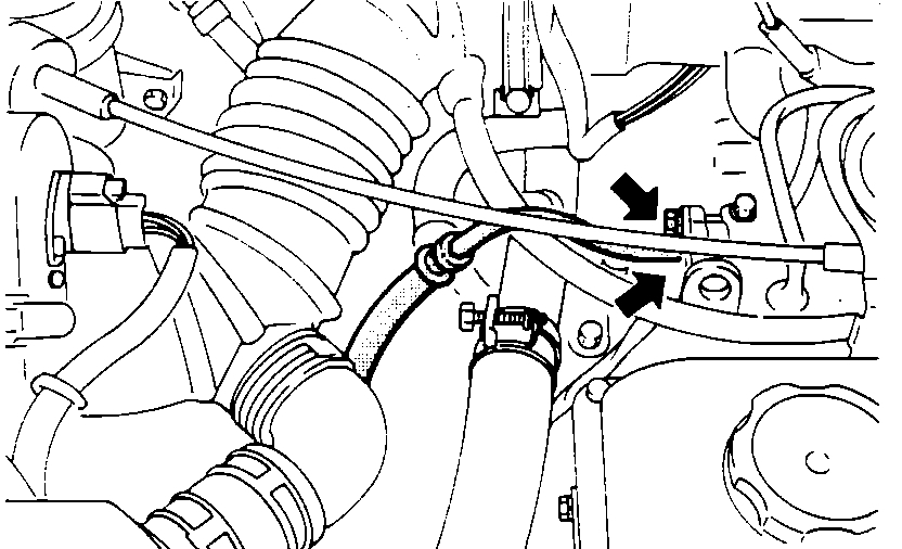

Fuel Pump Power Hook-up
Picture 4
2. Apply battery voltage to the fuel pump drive connector to power the fuel pump.

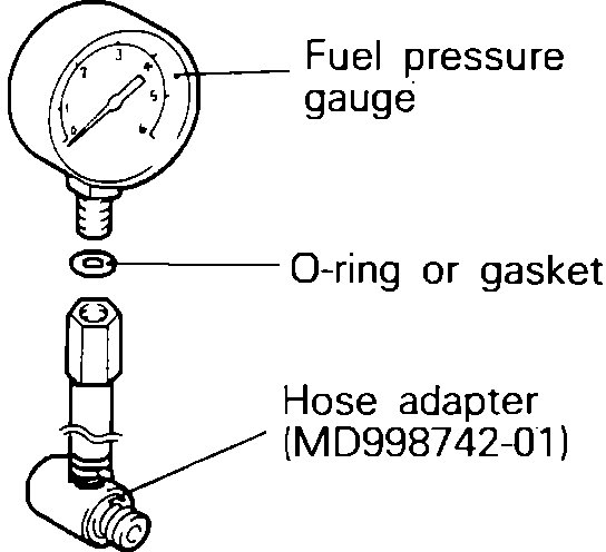

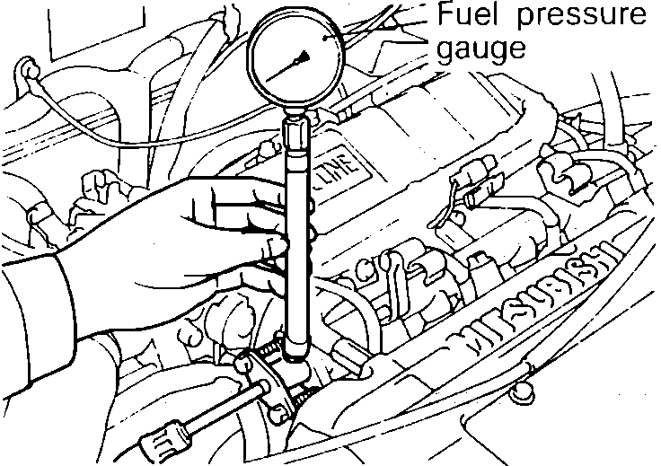

Fuel Pressure Testing Equipment And Adapter
Picture 7
Fuel Pump Pressure Test Equipment Installed
Picture 8
3. Using the fuel pressure gauge adapter (MD998742-01) or equivalent, install the fuel-pressure gauge to the delivery pipe (fuel rail).
4. Connect the battery negative terminal.
5. Apply battery power to the fuel pump drive terminal to activate the fuel pump. With fuel pressure applied check that no fuel is leaking at any of the connections.

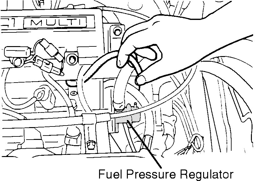

Fuel Pressure Regulator W/Vacuum Line Disconnected
Picture 9
6. Disconnect the vacuum hose from the pressure regulator, and plug the hose end. Measure the fuel pressure at idle.
Standard Value: 47-50 psi (330-350 kPa)
7. Measure the fuel pressure when the vacuum hose is connected to the pressure regulator.
Standard Value: 38 psi (270 kPa).

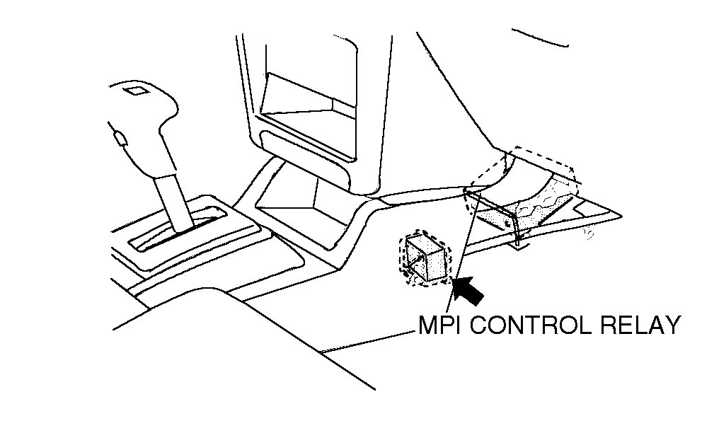

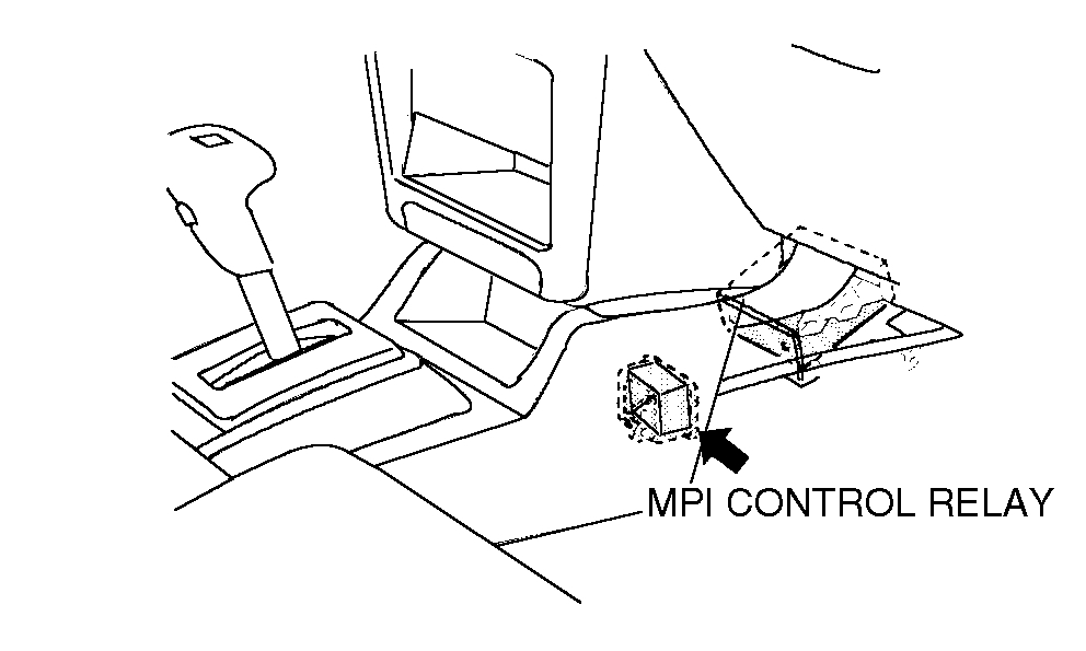

Let me know if this helps or if you have other questions. If you want to try the relay, it is located behind the center console, passenger side. See the last picture I listed.
