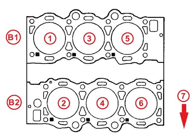

Cylinder six misfire. I want to replace one ignition coil and all six spark plugs, but i do not know the firing order to know which is number six.
May 1, 2018 at 2:49 PM

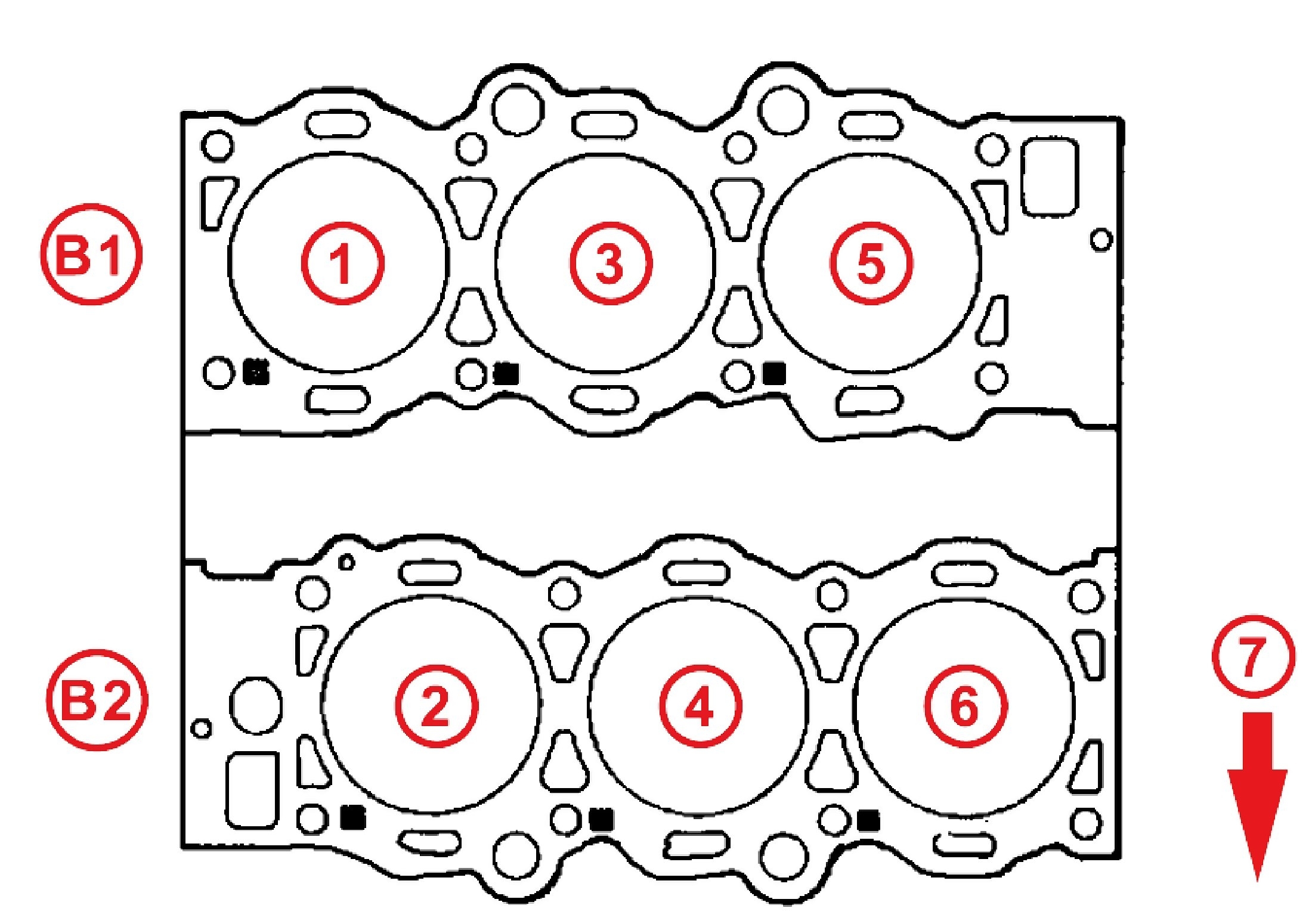

I have attached a picture for you. The arrow points toward the front of the vehicle.

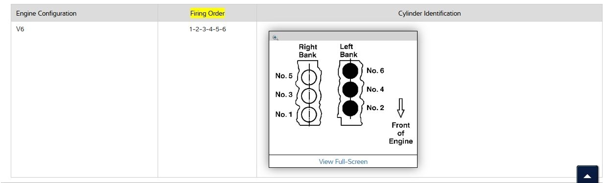

Please see the attached image. It is a pull from Prodemand and contains the firing order and cylinder layout. Hope it helps!
