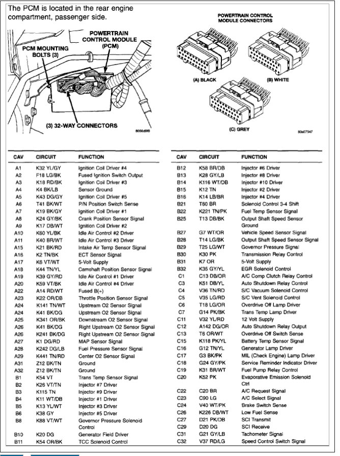

My truck has constant fuel with the key on but no spark. I have changed crank sensor, cam sensor, cap and rotor, coil. Checked all grounds and fuses, still nothing. Has no power to the coil. Please help. thanks in advance.
