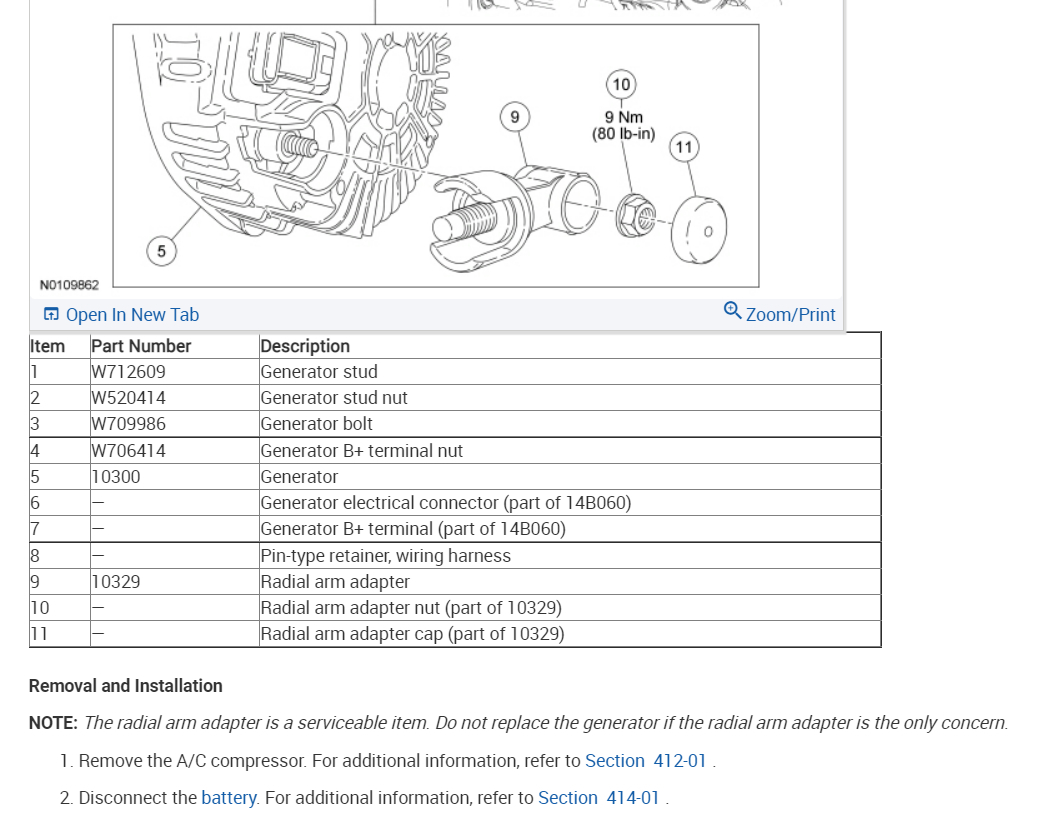

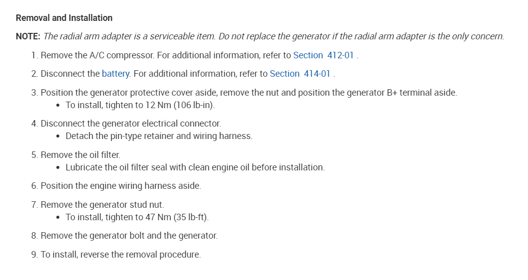

I would start the engine and hold the RPM at about 1500, then use a voltmeter to check the alternator output which should be about 14.5 volts max. if the voltage is up around 16 or 17 the voltage regulator has gone bad and is over charging the electrical system causing the overheating of components and connectors, here is a guide to help with the test and I have instructions for the alternator replacement below just in case you need it.
