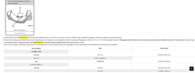

I'm replacing my connecting rod bearings and on one rod there is still up and down play, all of the other rods are fine. What could cause this issue and what is the next step i should take?
