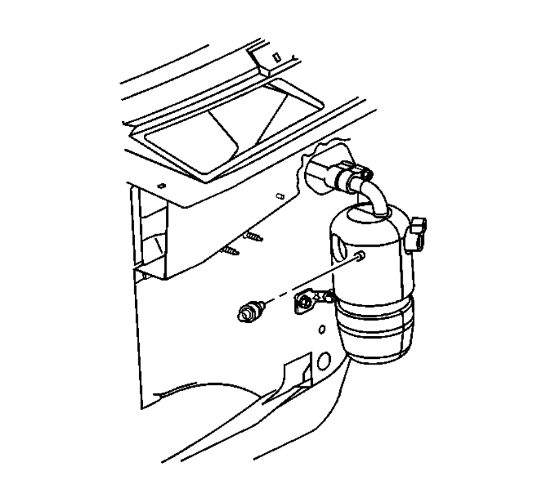

The evaporator freezing up is the issue. Can you give me the high and low side pressure readings while it is running to be sure the pressures are correct? The low side pressure switch should kick out the compressor before the system freezes up.
There is also a cycle switch for the compressor on the dryer that should disengage the compressor before freezing up.

Cycle switch
Air Conditioning Cycling Switch Replacement
Removal Procedure
1. Disconnect the electrical connector from the A/C low pressure switch.
2. Remove the A/C low pressure switch from the accumulator.
3. Remove the O-ring and discard.

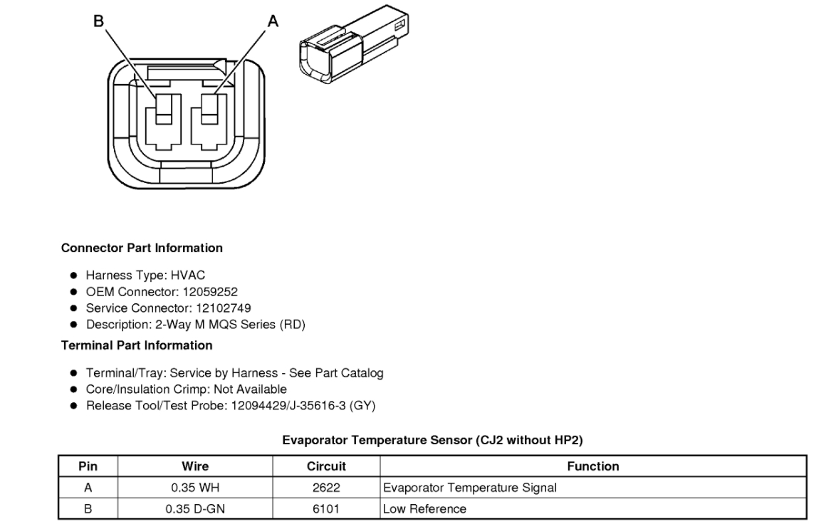

Thank you for your help! I learned that the gauges that auto parts shops loan out are not very accurate. I got readings from a shop and my Evaporator Temperature Sensor was reading 145 F instead of around 45 F. I replaced it over the weekend and it's working great now. Thanks again!
