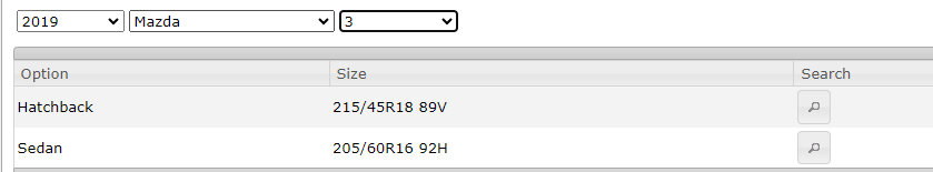

So, l just bought my first car listed above GX. I'm very excited about learning about the car, especially it being manual. I have some plans for modding the car already. The first thing I was looking at doing was changing the rims/wheels. The wheels on my car are the stock wheels and they don't look so great.

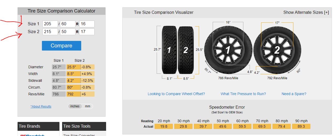

The OEM tire/wheel size is 205/60 R16. I was looking to upsize the wheels to 17", but I know I need to change the tire size. So, I was looking at 215/50 R17. I heard that I need to go 10mm + for the width, minimize my sidewalls etc... I really don't know if this size of tire will fit my car. So, what do I do next?
