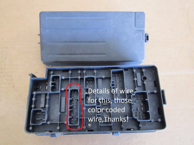

Greetings. I have the following problem: in the fuse box the connectors were destroyed and I can't get how to put the cables in their correct position so I can start my car.

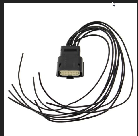

If I understand correctly, you need to replace the connector that connects to the fuse box? If that is correct, it would be better to find what is called a pigtail connector which is a new connector with wires already connected to it. Then you just need to cut each wire off the old connector one at a time and put it to the same position on the new connector. I attached a picture of this below so you can see what I mean.
If you cannot find one of these then I would go to a salvage yard and find a similar vehicle and just cut this connector out of that vehicle. This may be a little more leg work in finding it but it will be much easier then trying to match each wire to the pin.
