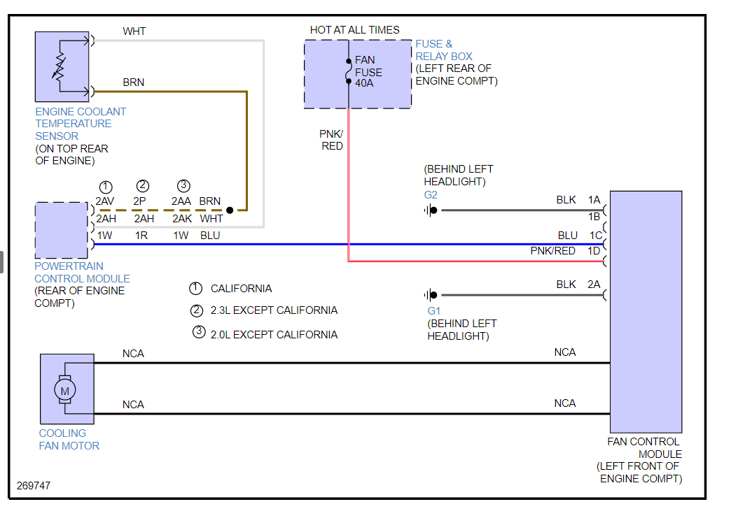

It sounds like the control module is bad which is common. Here are the cooling fan wiring diagrams so you can see how the system works. Here is a factory procedure:
