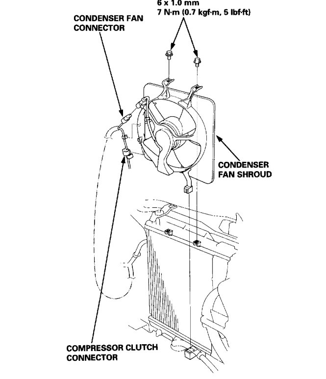

The Ac stops working and the condenser fan fuse keeps getting blown. I noticed that at cold engine temp the ac will work with a new fuse but until engine temp goes up then the fuse fails. While at high temp , putting a new condenser fan fuse will blow immediately once ac is turned on. Could it be a bad clutch relay? Checked blower fan and it spins freely. No obstruction.
