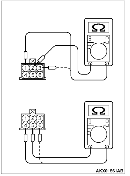

Here is the test for that part number IACV:
On a cold engine 20°C (68°F) you should hear the UAC move if you turn the key on.
Disconnect the idle air control motor connector.
Measure resistance between terminal No.2 and either terminal No.1 or terminal No.3 of the connector at the idle air control motor side.
Measure the resistance between terminal No.5 and either terminal No.6 or terminal No.4 of the connector at the idle air control motor side.
Standard value for both tests: 28 - 33 ohms at 20°C (68°F)
If they pass this test then it is likely in the driver circuit. Unfortunately they never sold that engine in the US Lancer so I do not have a good wiring diagram.
