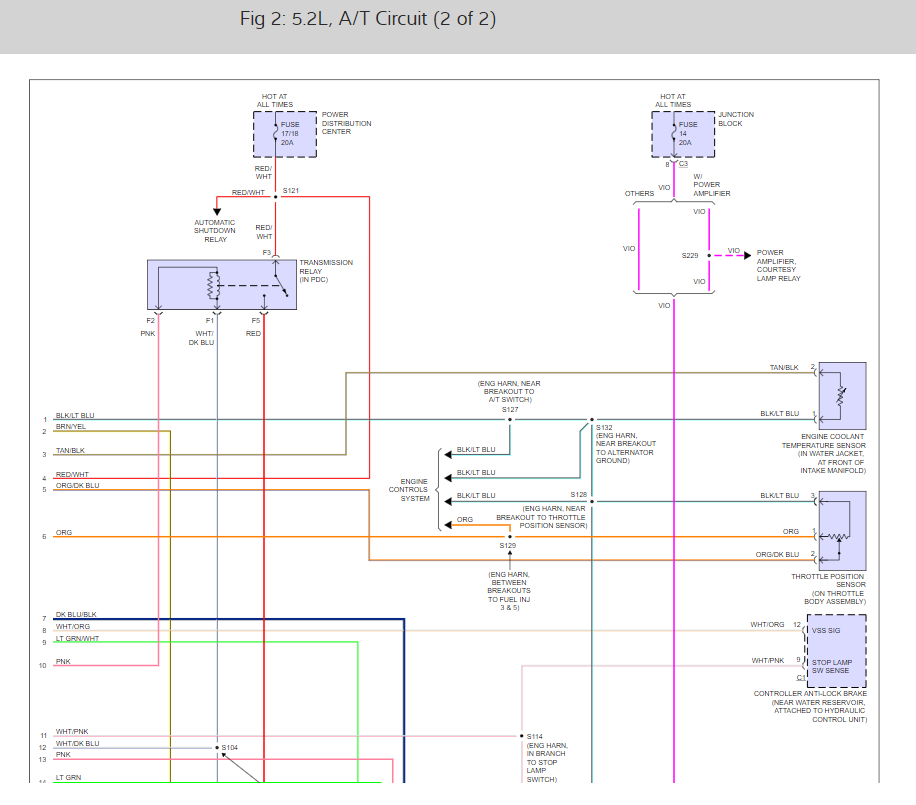

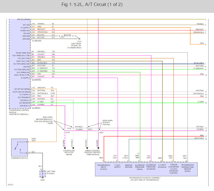

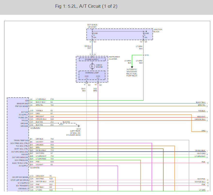

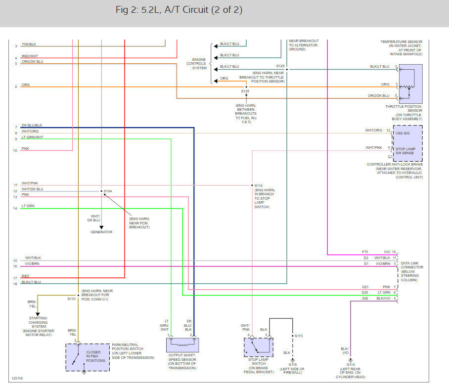

Check first that you have all the same color wires in both connectors. Here is the transmission wiring diagrams so you can see how this system works and a guide to help run tests:
Check out the diagrams (below). Please let us know if you need anything else to get the problem fixed.
