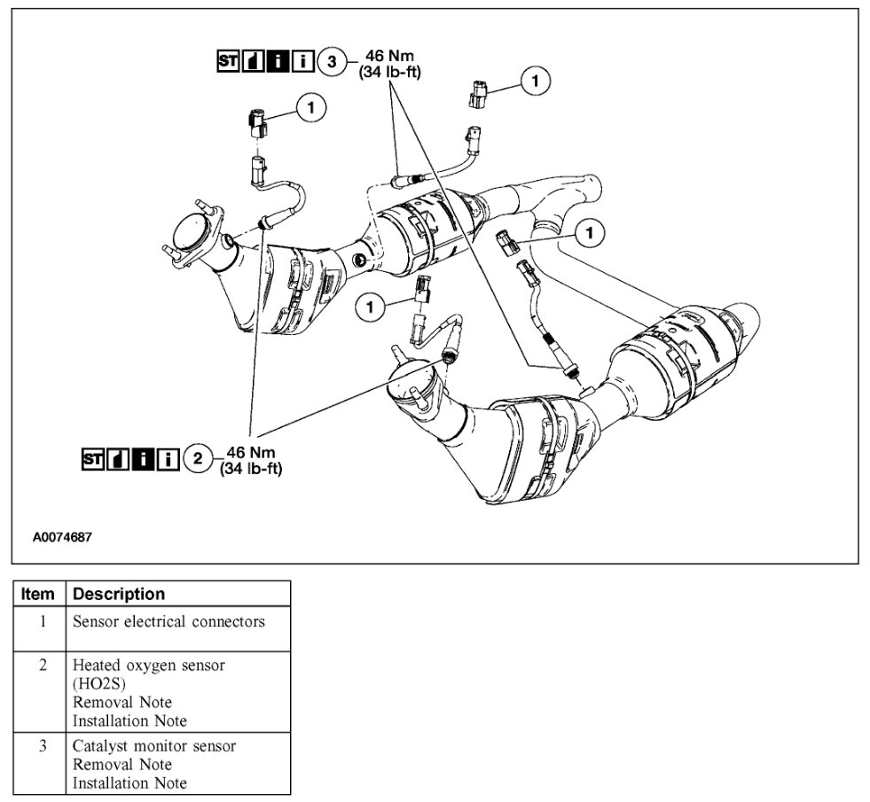

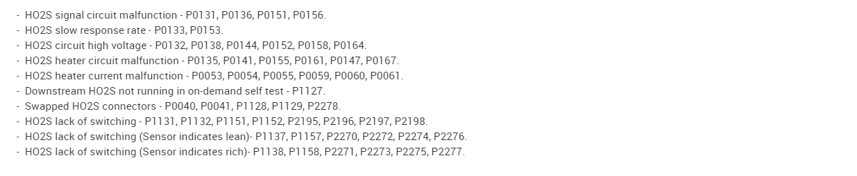

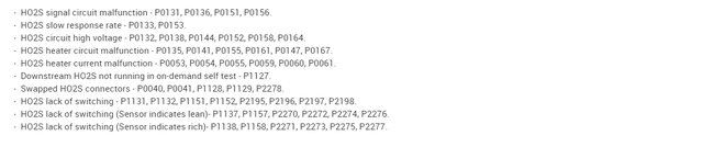

Hello, what codes are the PCM setting? If it doesn't pass the IM Readiness monitors for the Oxygen sensors after 2 drive cycles, it will set codes. So, there must be something stored in the PCM. If the oxygen sensor switching time or the sensors are hanging high or low voltage, it won't pass any monitors, Ill post the list of codes, but also checking the exhaust back pressure to determine any Catalytic Converter failures would be good to know as well.
But any codes we'll need to know first. That will give some direction for diagnosing the issue.

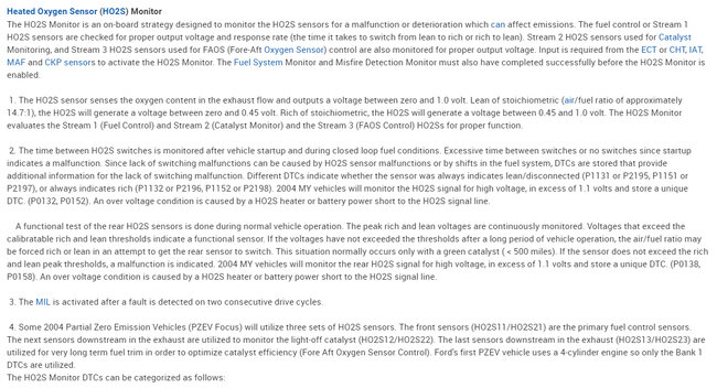

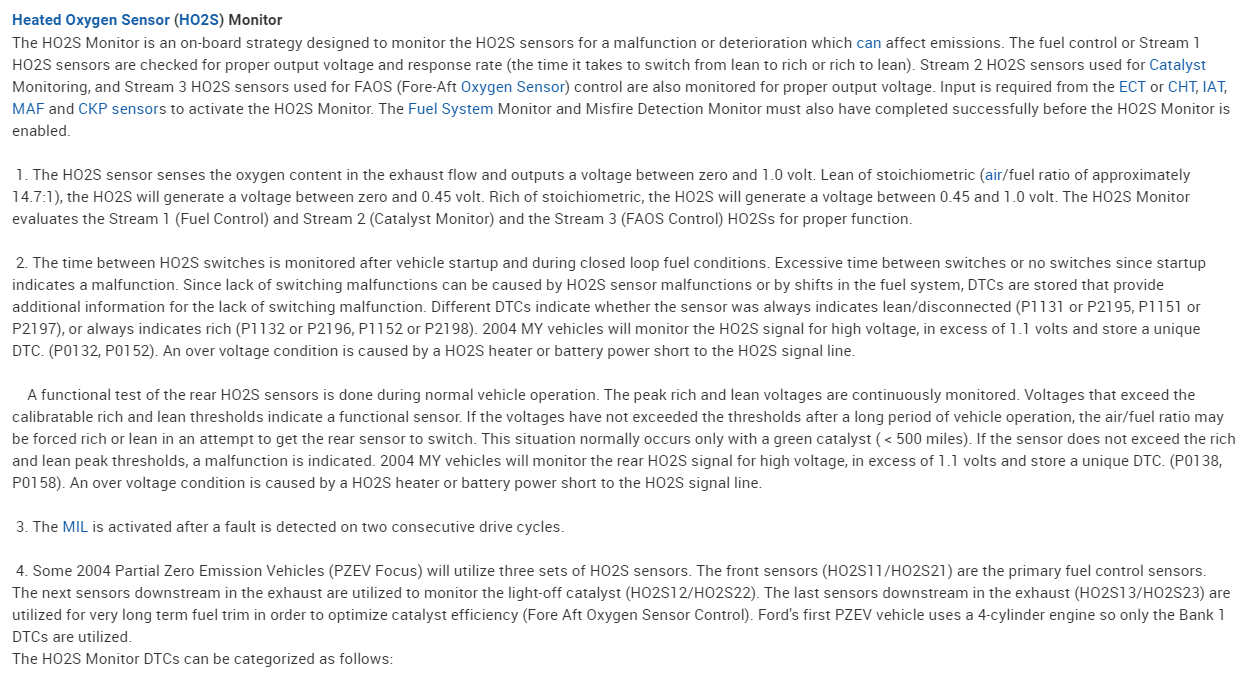

If you have a scan tool, and can check the live engine data, you can take a look at the Oxygen sensors voltage levels and see if anything looks off. If any of the oxygen sensor heater circuits are not working, it will prevent the sensors from functioning correctly. I'm not sure what kind of shop you've had it at, but they should have given you a more in-depth answer about what exactly is wrong with the PCM. Such as if the memory circuit is losing or has no power. There is a battery feed that keeps power to the PCM to retain memory, which might be something they were meaning, but they should be more specific with the issue so you can get things fixed up right, instead of just replacing a computer.

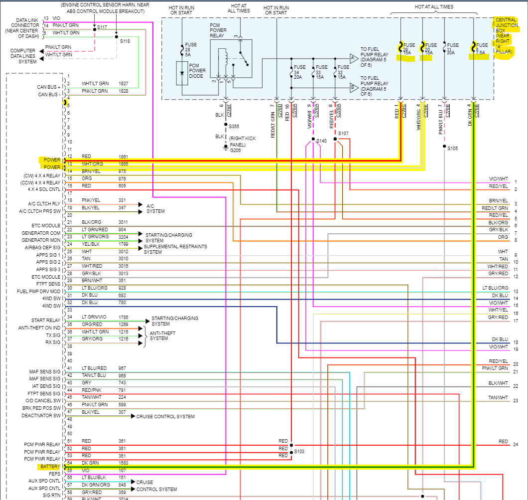

But here's the service info on the IM Readiness monitors you need. So, if the PCM is not storing any codes, which almost sounds like what is happening, you can check that the PCM's memory circuit is okay.

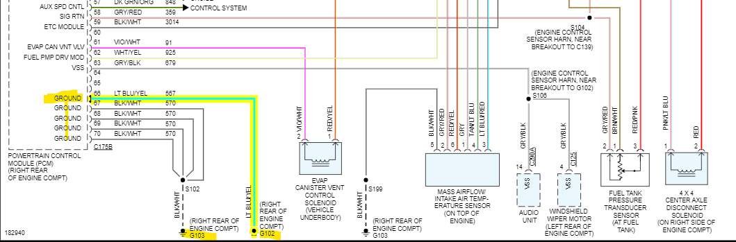

Here are the fuses that are permanent battery feeds that retain the memory, Fuse 29 15amp, Fuse 20 15amp, and Fuse 5 7.5amp. They are kind of difficult to see on the wiring diagram. The 6th diagram shows the PCM Grounds, if there are any broken grounding straps or corroded grounds to the frame or body, or any voltage drop from the engine block to battery negative, or the frame to the battery, this can have the same effect as a bad PCM ground. So, check those fuses for power on both sides, here are some guides to help.

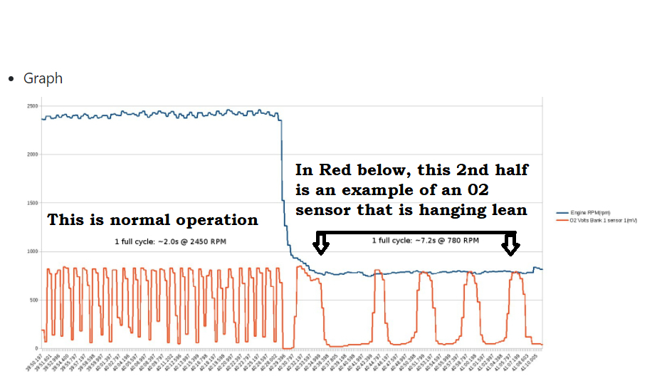

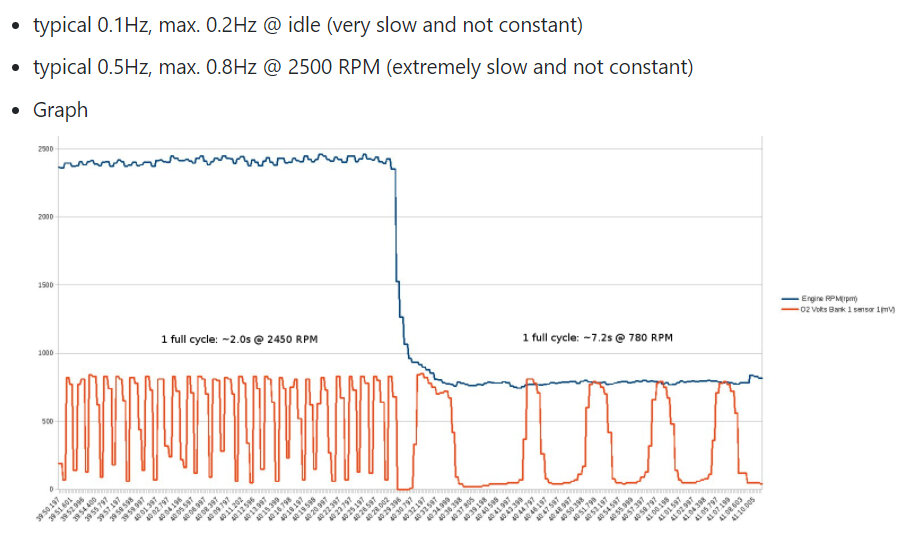

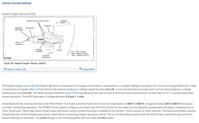

Have any codes been stored in the PCM? There must be some, if not let me know, and do other Readiness monitors pass? As for the Oxygen sensor voltage, the Bank 1 Sensor 1 and Bank 2 Sensor 1 voltages should be swing from about 0.2 volts to 0.8volts, in that range, the Bank 1 and Bank 2 Sensor 2 oxygen sensors (these are the sensors after the Cat) should be semi steady in voltage and not be swinging in that voltage range.
Below is an example of the Oxygen sensor voltage switching, you can see the first half of the waveform is normal switching, whereas the 2nd half is a slower (lazy) oxygen sensor, it is also hanging low voltage, this is a lean exhaust type of sensor signal.

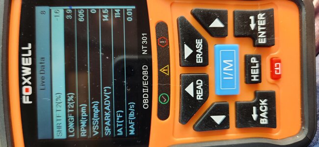

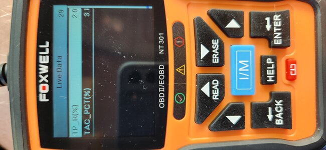

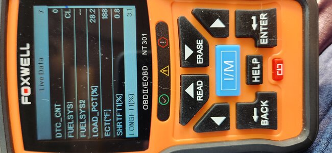

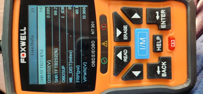

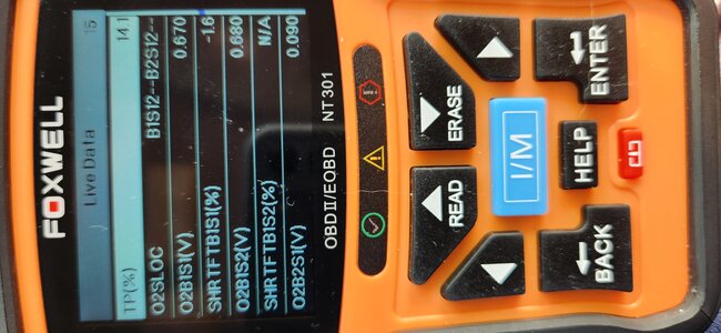

Hi, I could not find LTFT or STFT I just took pictures of my live data maybe you can see it.
Thanks,
Jeff
Jul 8, 2023 at 5:51 AM
AL514
  • 5,465 POSTS
The bottom 2 in the 11st picture SHRTFT1% and LONGFT1%. the 1 stands for Bank1 of the engine, so there should be a SHFTFT2% etc., as well, was the repair done already?

Take a look on Rockauto com. They have decent prices, but things get more expensive if you have a California or Federal emissions vehicle, the tag under the hood should say which one it is. California has much stricter laws when it comes to emissions. I'm not sure how accurate the scan data is on that Foxwell scan tool. I see that it's in Closed loop so it must be up to operating temperature. But I would expect the Fuel trim numbers to be more negative than they are. Did you inspect the converters yourself and see the actually broken apart? And is this the F-150 5.4L heritage edition? with or without a Turbo? If you're unsure I can look up your particular vehicle better by the VIN. I'm seeing some different service info depending on model.
