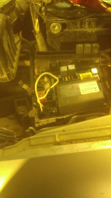

Is there a fuse that I am missing for the power to the PCM? I have checked all fuses and all are good the car will not start and run at all but if I take out fan relay and run a positive power wire to the pcm terminal for the fan the car will then start and run. so is there a fuse that I am not finding that is bad?

Looking at the wiring diagram that back feed goes to a splice that leads to another splice that feeds the PCM. But because it runs with the feed in place I am thinking you have an issue right in the fuse box circuit board. The splices feed multiple areas as well as the PCM so if the splice was bad those would not operate even with the jumper in place.

The splice is inside the PDC, it feeds the pump, PCM, Fan and a few others that all allow it to run. The jumper you add in bypasses the broken area and feeds the power "backwards" into the other side of the connection. so the pump and PCM get power.

THE pdc doesn't have any circuitry board to it it's all wires going to each fuse and relay is there possibly a fusible link that is bad

I would check the connectors in the PDC, It shows fuse 14 as always hot PCM feed, to splice S104 inside the PDC and that feeds the PCM and the auto-shutdown relay.
Fuse 12 - low/high fan relay and A/C clutch.
Fuse 11 - switched power PCM fuse
Fuse 10 - ignition switch fuse that feeds fuse 11
