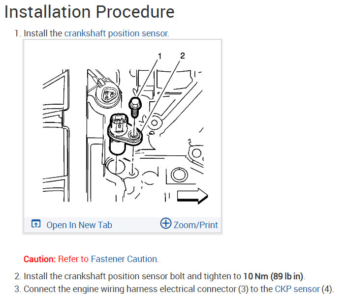

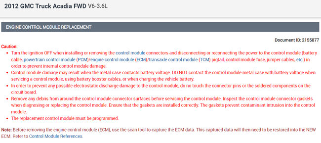

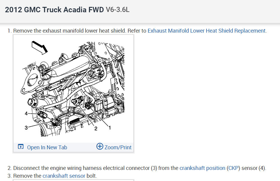

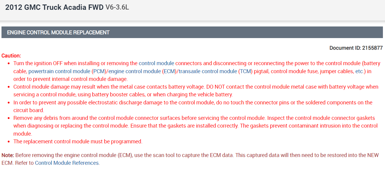

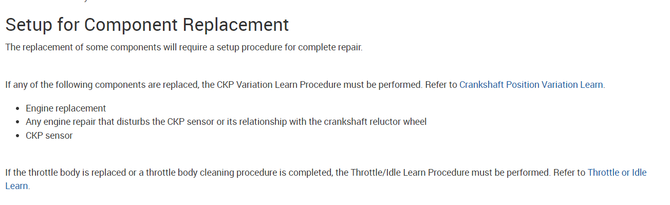

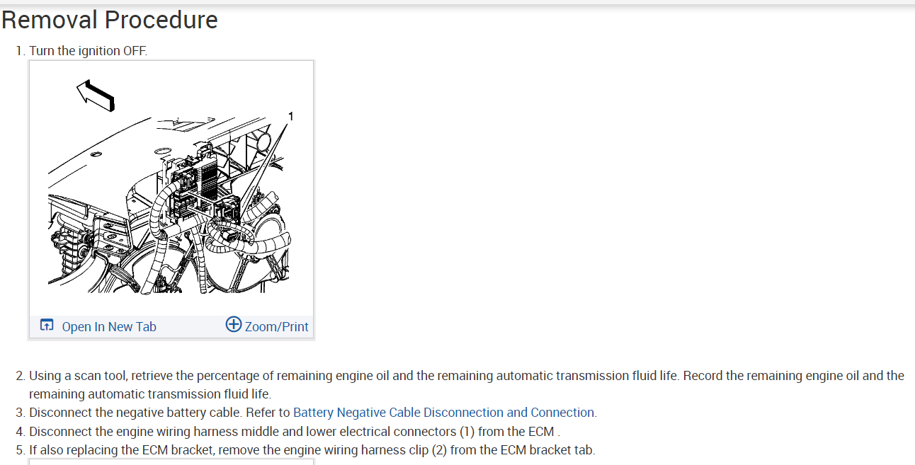

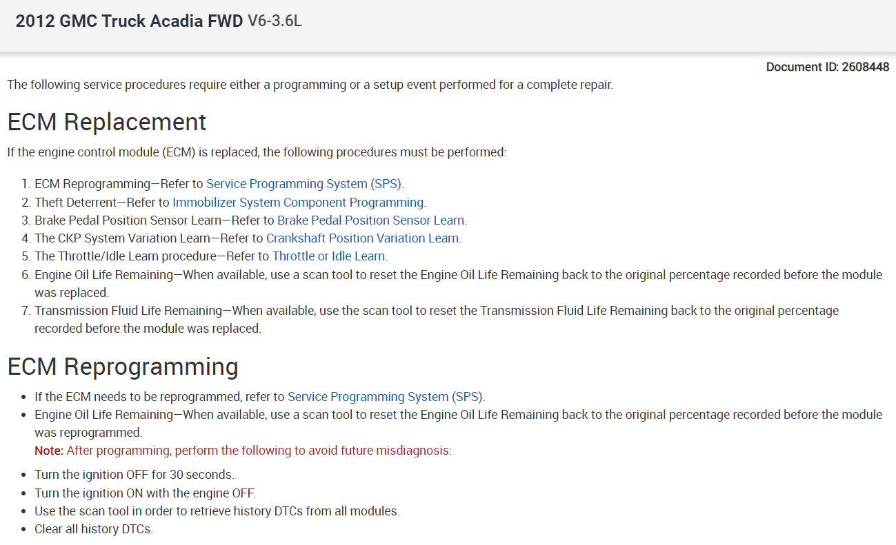

I have a message after the car had been running for around 15 minutes saying: oil pressure low stop the engine). I have replaced the PCM in the car because I got code p062 ECU error. I got PCM refurbished and reprogram with vin number.so here I got check engine light and code P0315 crank shaft position sensor not learned. What is going on with this car? are the computer needs to be programmed being installed on the car or is the computer is bad?
