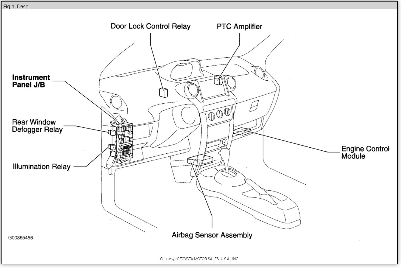

Where IS that computer anyway?
May 25, 2017 at 5:59 PM
Yep really sounds like a computer problem, it is located on the passengers side. Here is a diagram to help you find it. (BELOW)

Thanks. So is that diagram for an '05 xA? I can't seem to locate the ECM. Also, do I have to use a dealer to program it? Who else can do it?
May 27, 2017 at 9:13 AM
Yep that is the diagram for the xA. Some independent shop can reprogram t for you call around to find out someone in your area.
