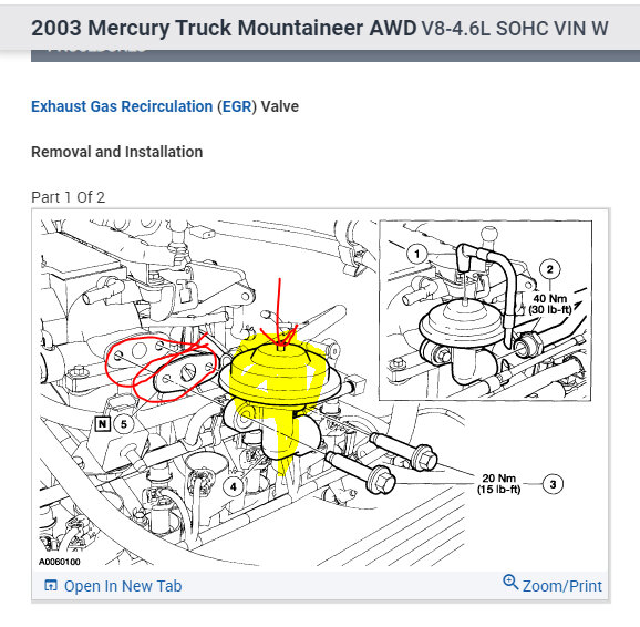

Do me a favor. The EGR valve is mounted to the side of the intake manifold. (See pic 1 below).
I highlighted the component and have an arrow pointing to where there should be a vacuum hose. make sure that it is good and there are no leaks present. If it appears good, check where it mounts (circled in red) and make sure there is no evidence of a leak at that point.
