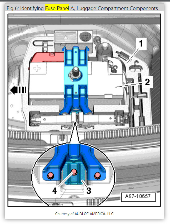

Can you tell me if the rear window defroster is working? If not it looks like you may have a blown maxi fuse 110 amp in fuse panel A near the battery. Here is a guide to check it for power on both sides and the location as well:
