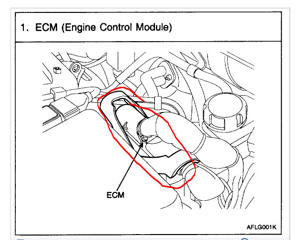

I suspect this is a 4-cylinder vehicle and not the V6. If that is incorrect. Let me know.
If it is the 4-cylinder, the ECM is located right in front of the brake master cylinder under the hood. I attached two pics below.
See pics below.

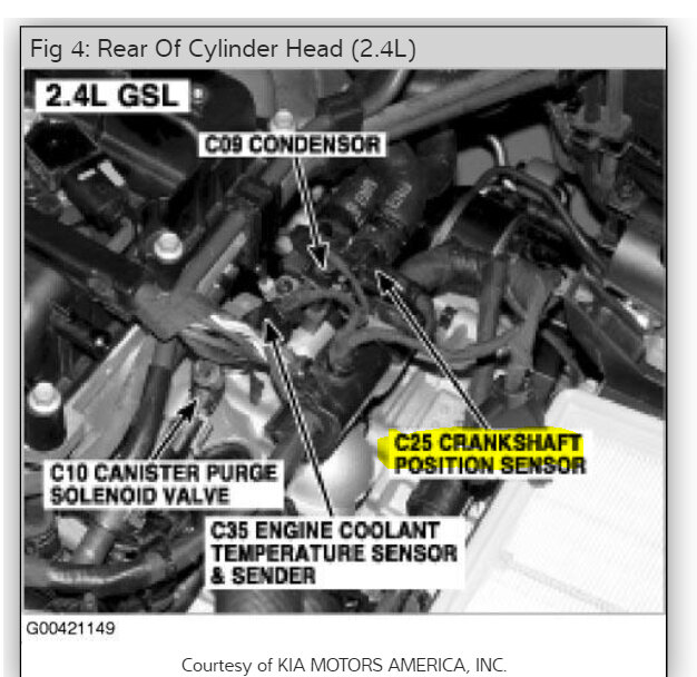

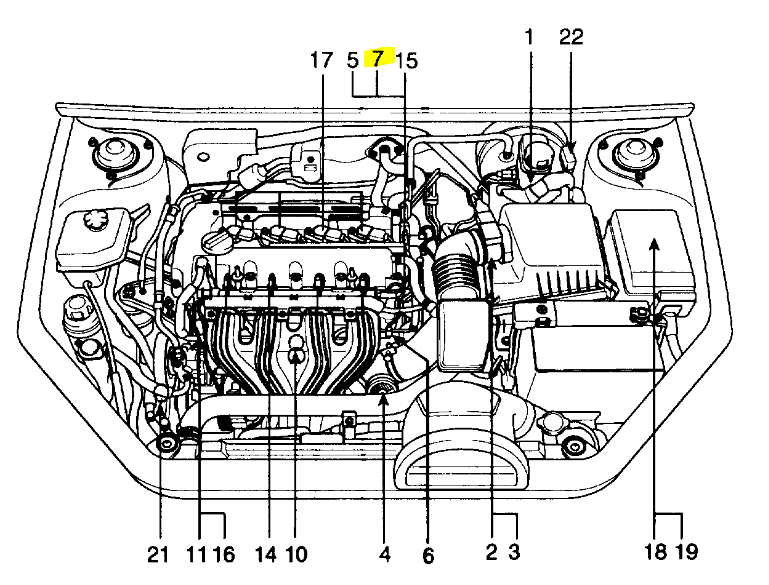

The sensor is at the rear of the engine. I attached two pics below to help you locate it.
Inspect the connector to make sure it is tight. Remove it and inspect the connector pins for corrosion or damage.
Also, inspect the wiring around it to see if there is any damage. If everything is good, I would likely replace it.
