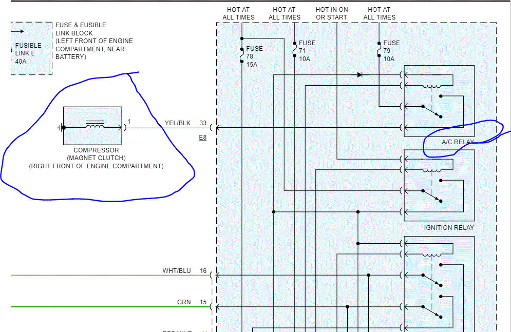

The wire coming from the compressor the I put power. To it and clutch started turning
I spent the day looking for the Location for relay... The location wire diagram

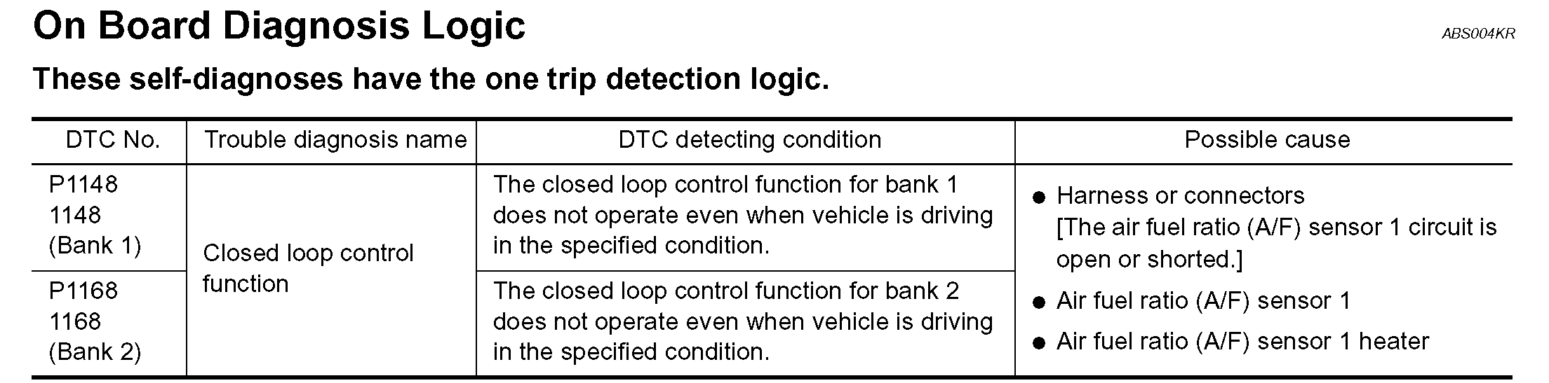

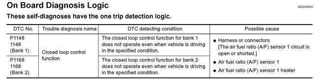

When am driving when reach 2,500 rpm's if try go over it’s like a loud noise is come from the engine.
What you think that can be?
