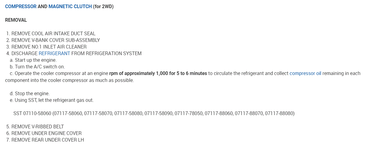

I have attached the replacement procedure below.

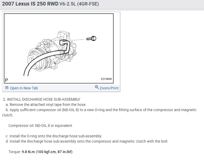

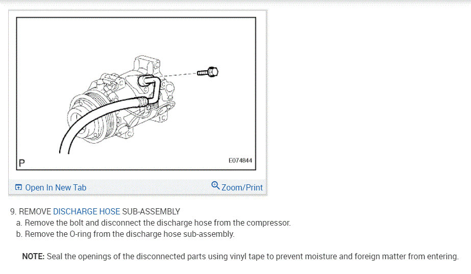

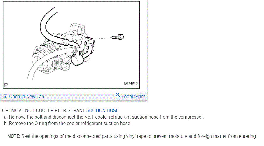

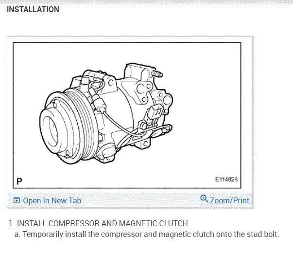

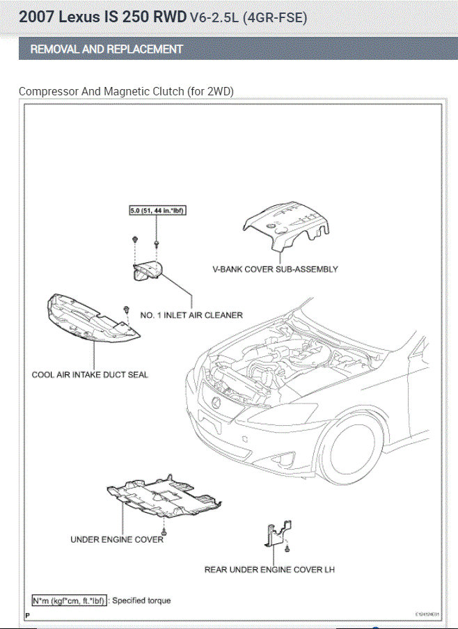

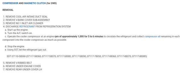

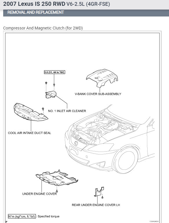

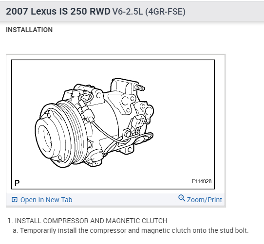

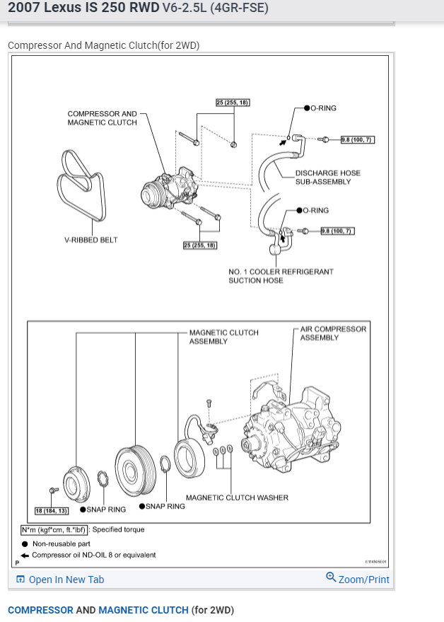

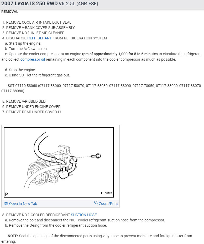

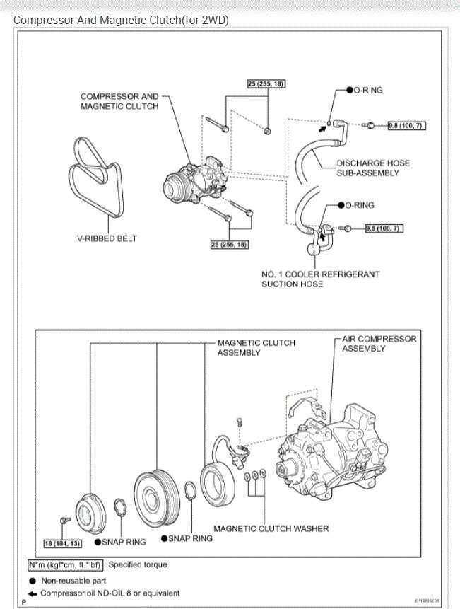

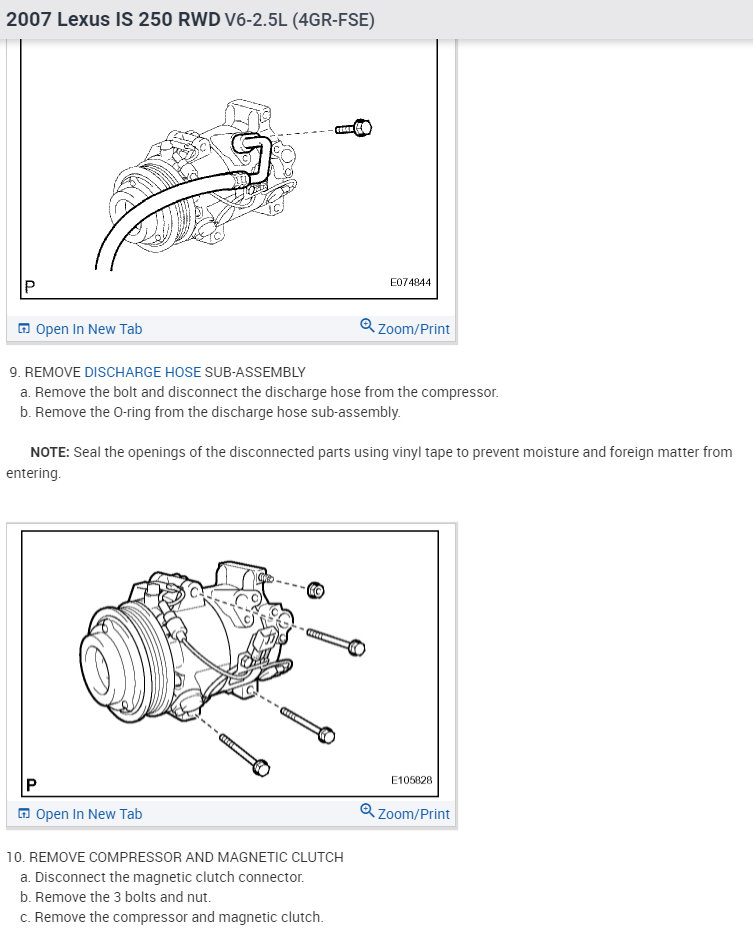

What is stuck? Do you mean the compressor clutch, the pulley won't turn, or are you getting the compressor stuck when installing it? Let me know.

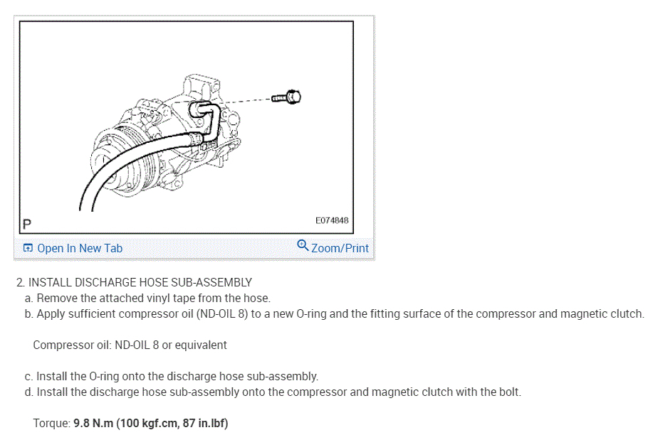

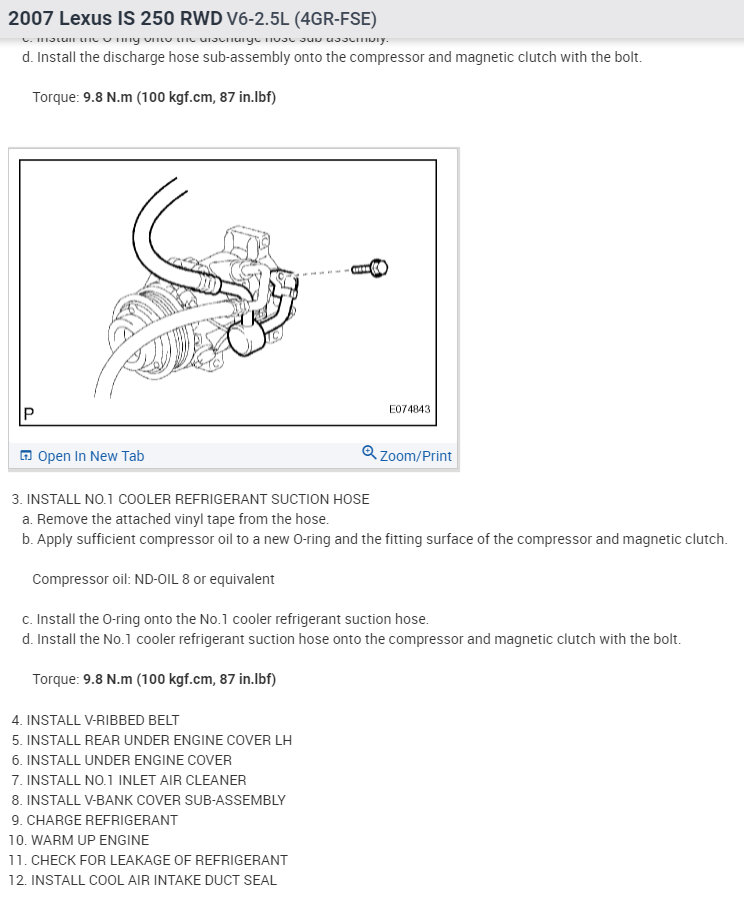

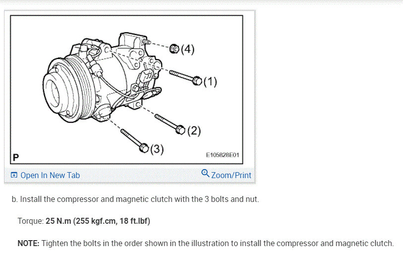

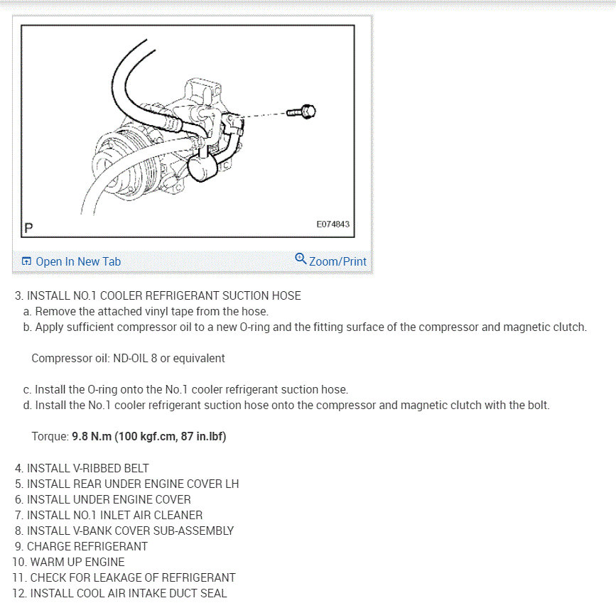

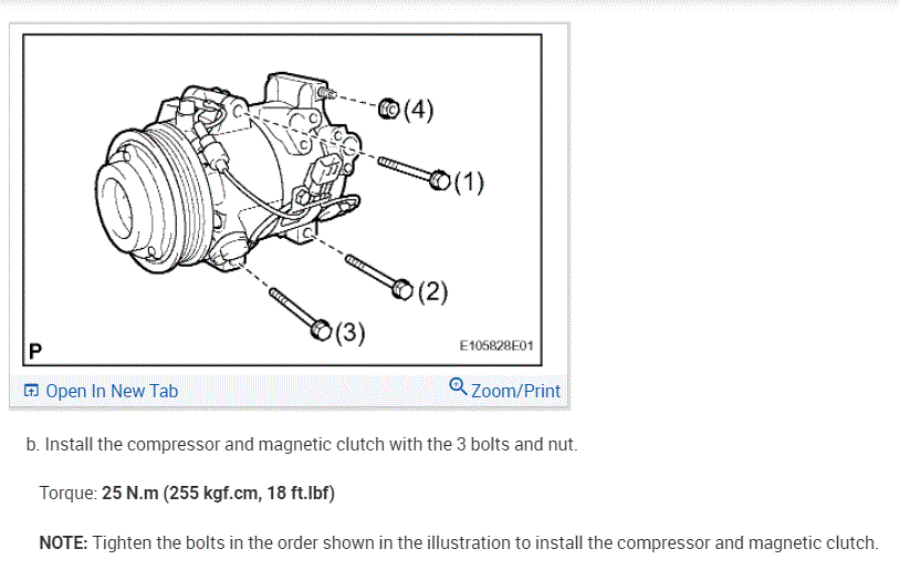

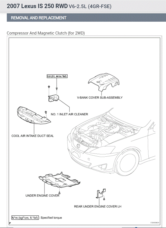

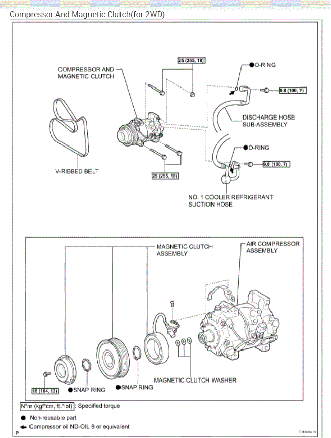

I attached the directions for removal and replacement from my manual. Take a look through them to see if something is missed. See pics below

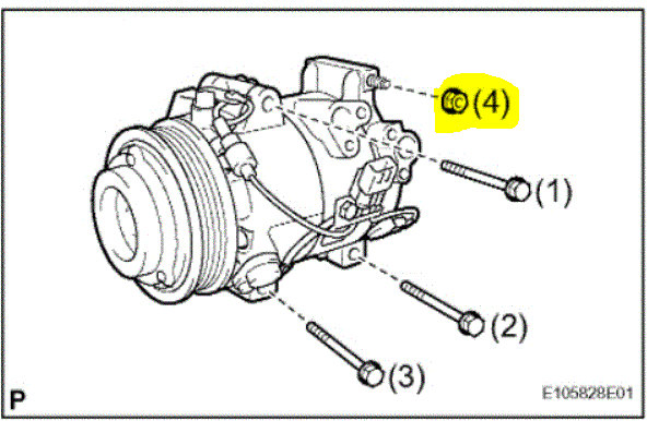

So, I took out all bolts (4 long bolts) and still can't come off feels like its somehow connected somewhere in the back area of compressor. I even pulled out the alternator but still won't come off. Any help will be gratefully appreciated.
Nov 9, 2021 at 10:52 PM

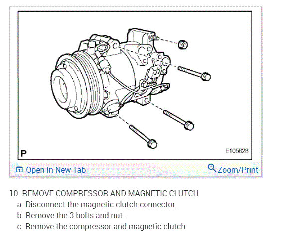

The manual shows three long bolts and a nut. Has the nut been removed? (See pic 1)
Is it possible for you to take a couple of pics of what you are dealing with and upload them for me? Hopefully, I will see where the problem is. Also, have you disconnected everything mentioned in the aforementioned directions?

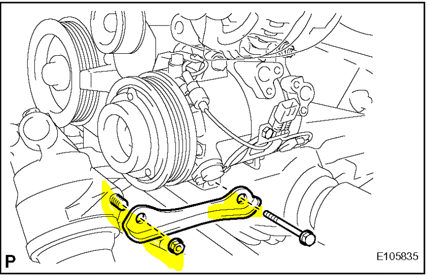

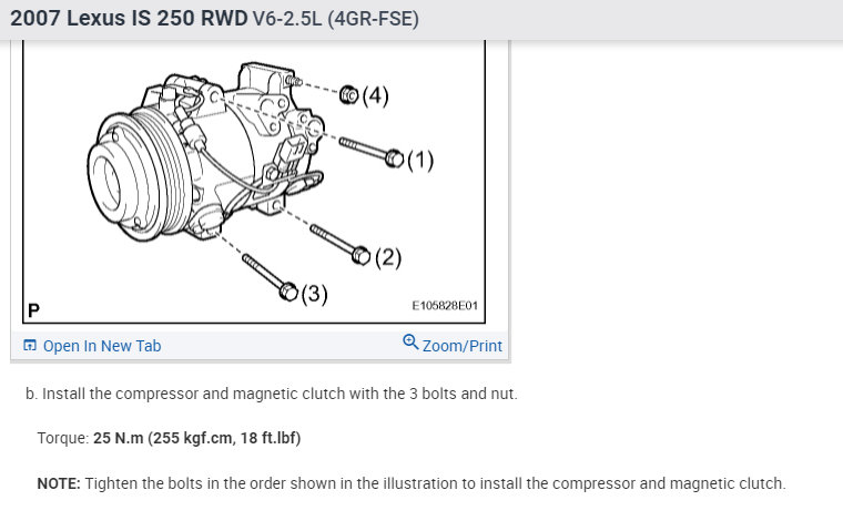

Also, did you remove the oil filter bracket? If you only removed the bolt from the compressor, the bracket will still be tight and prevent the compressor from moving. See pic 2. Note: You should be able to just loosen that bolt and move the bracket out of the way.
See pic below.
