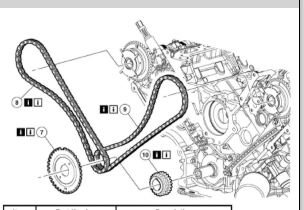

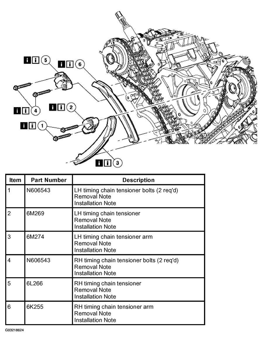

First, if all four of the cylinders with no compression are on the same side, I suspect you may have broken one of the two timing chains in the engine. It is not common for this to happen, but it has. Now, if that is the case, the worse news is that this is an interference engine. Basically, that means there is no room between the pistons and valves if timing is wrong. If one of the chains has broken, chances are there are several bent valves which usually means the head needs replaced at minimum.
I have attached a picture for you to see how the timing chains run. You will see there are two, one for each side.
If you have other questions, let me know. However, if there is "no" compression (0), valves are stuck open or there is a hole at the top of all four pistons.
