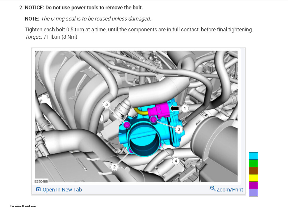

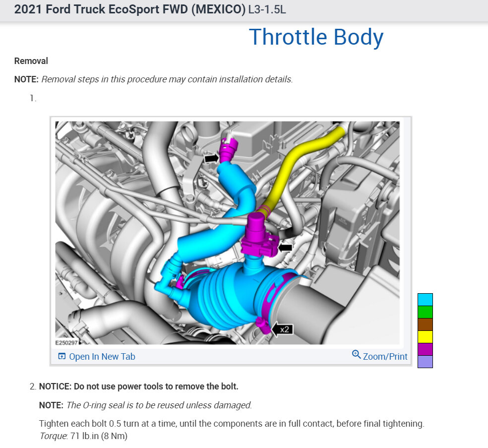

I have seen the throttle body cause this problem and not leave a code. Here is the location and how to service the unit in the images below. Let us know what happens and please upload pictures or videos of the problem so we can see what's going on.

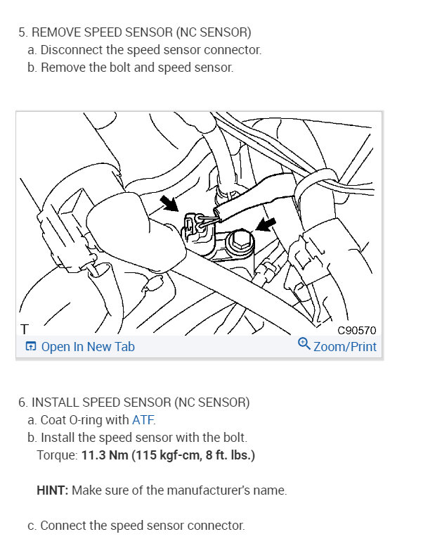

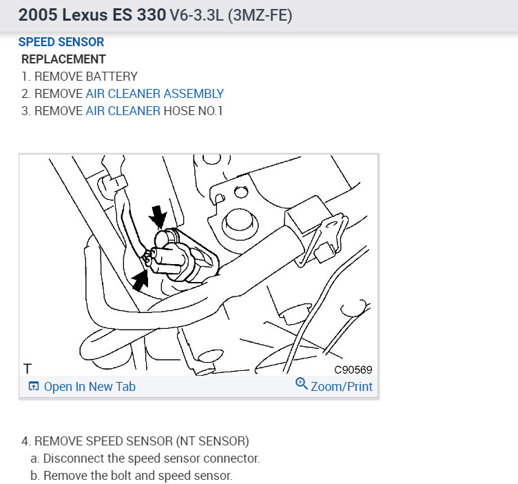

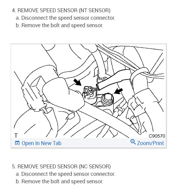

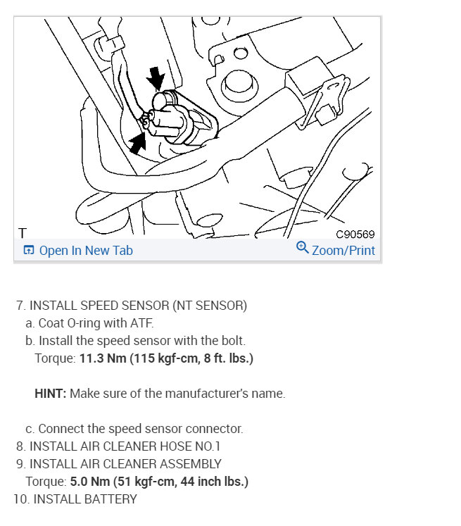

Yep, the P0715 stands for Input/Turbine Speed Sensor "A" here is the location of the sensor so you can check the electrical plug and if it is okay, I would replace the sensor, here is the location. Check out the images (below). Please let us know what happens.
