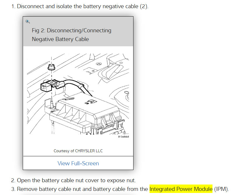

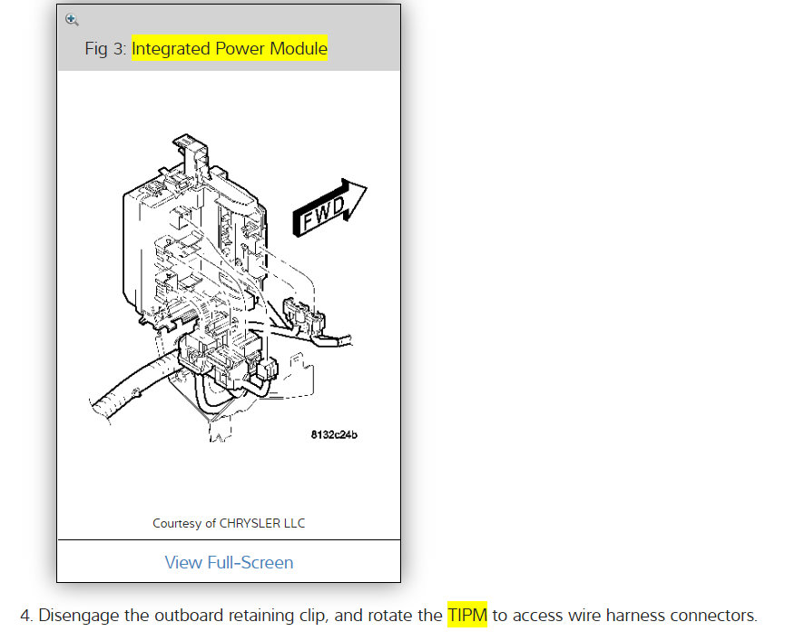

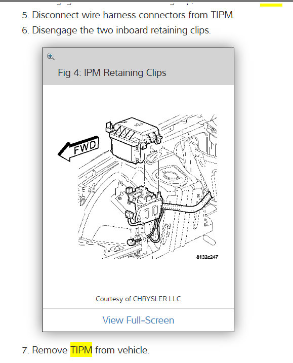

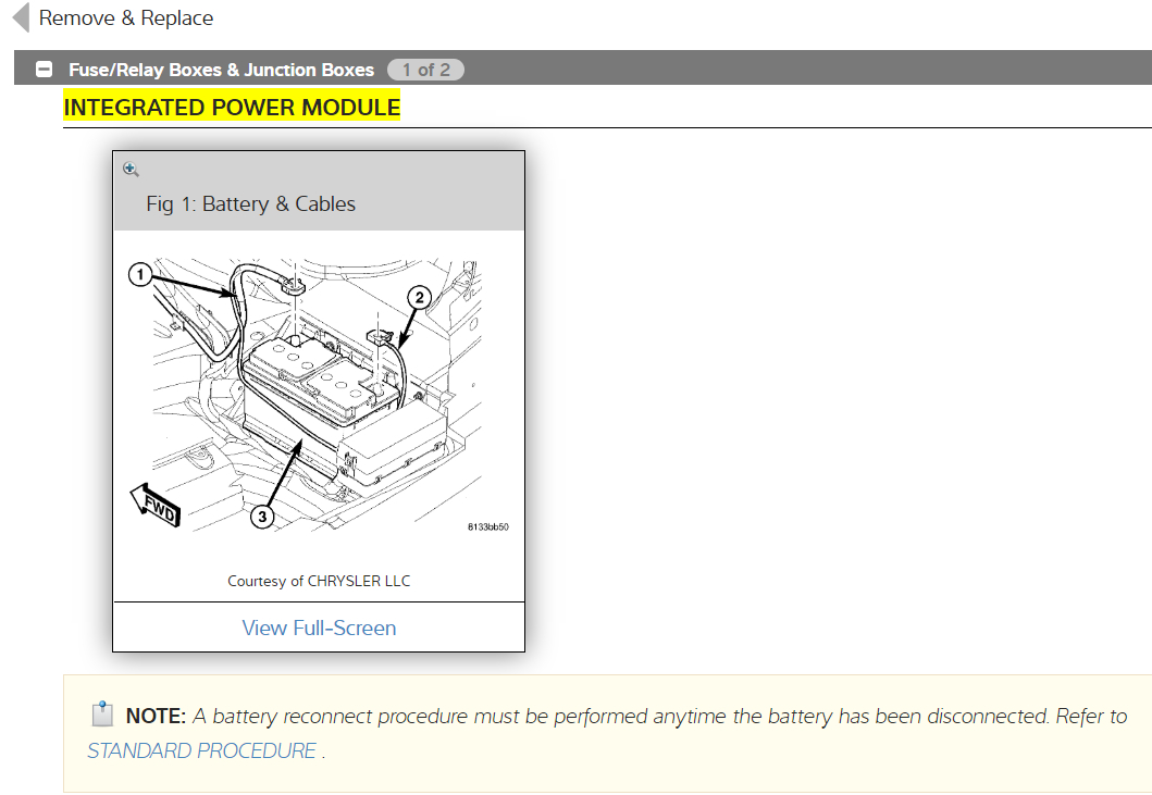

Yep, this happens when the cables are reversed it takes out the car's TIPM which are weak to begin with. We can confirm if you can do a CAN. You can get a CAN scanner from Amazon for about $30.00. here is a video to show you how. I have included the TIPM replacement instructions in the diagrams below, it is easy to replace it because the unit self initializes.
