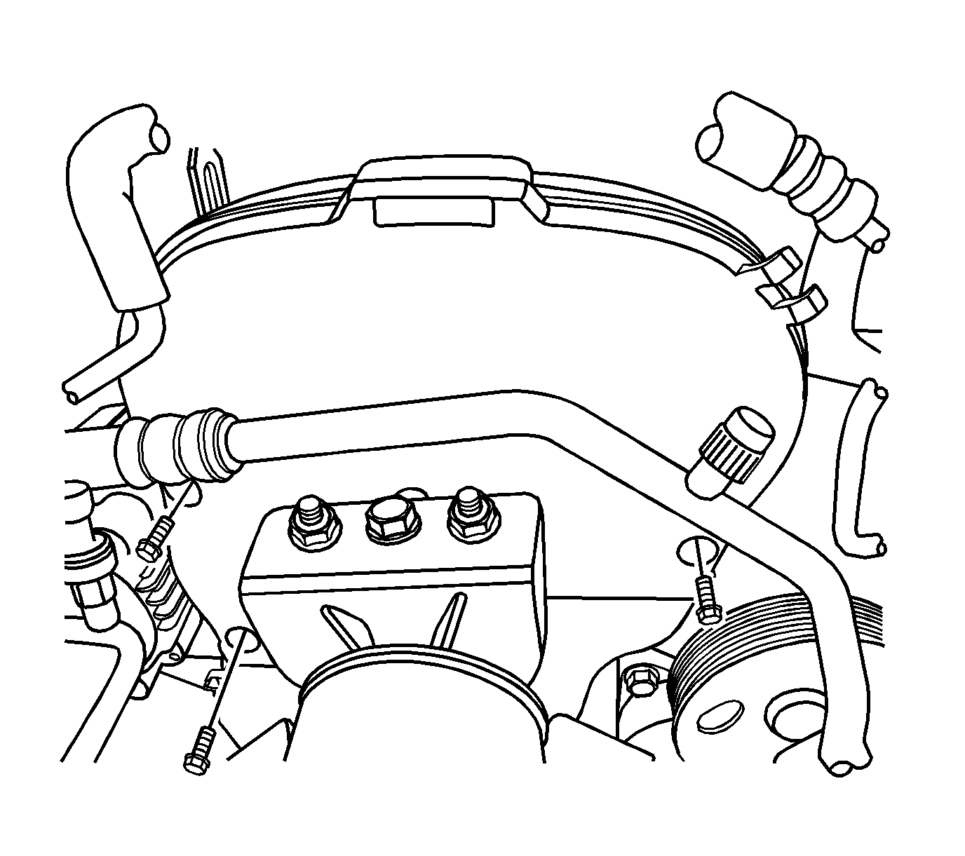

pic 2
4. Disconnect the breather tube from the valve cover.
5. Disconnect the intake air temperature (IAT) sensor connector.
6. Disconnect the air intake tube from the throttle body.

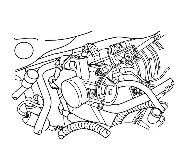

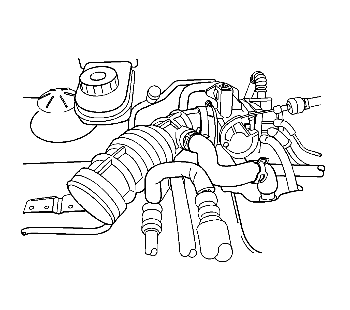

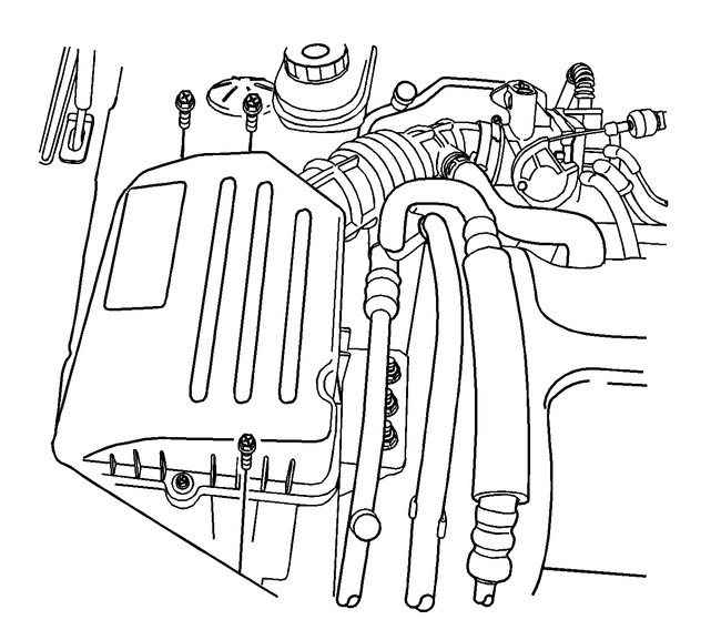

pic 3

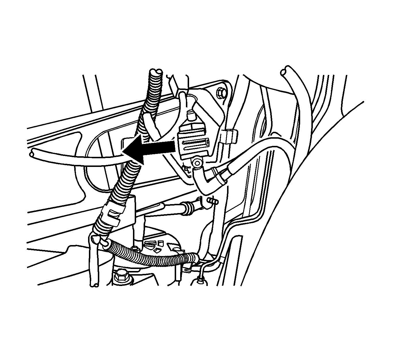

7. Remove the air filter housing bolts.
8. Remove the air filter housing.

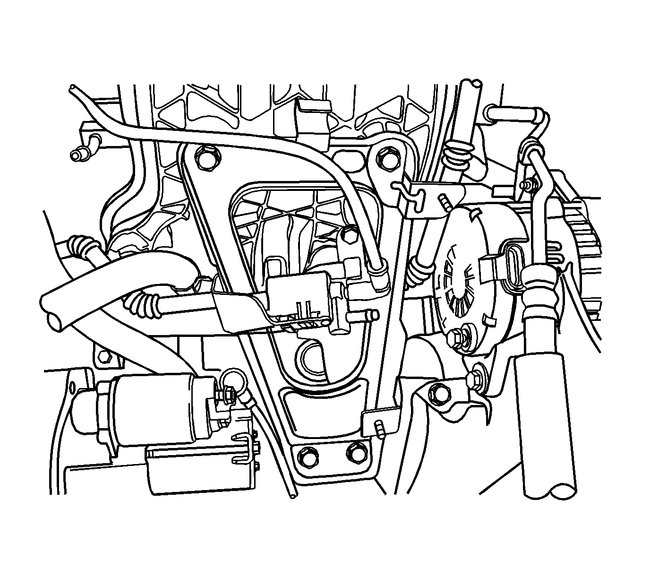

pic 4

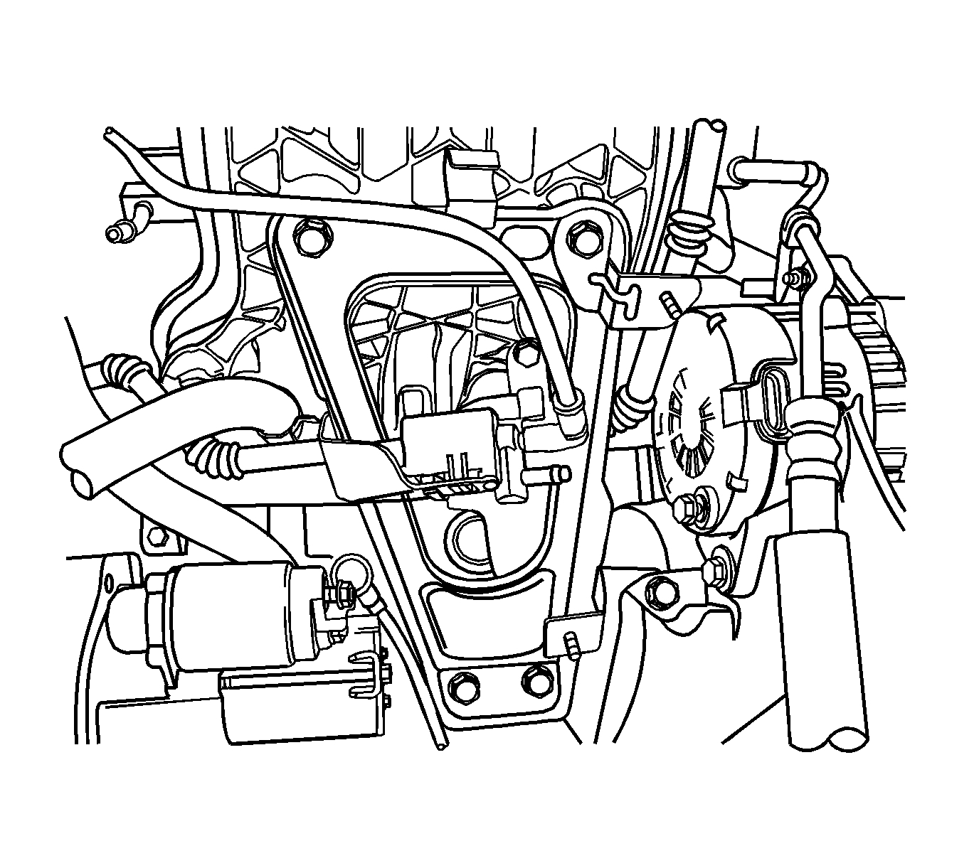

9. Disconnect the A/C pressure (ACP) transducer connector.

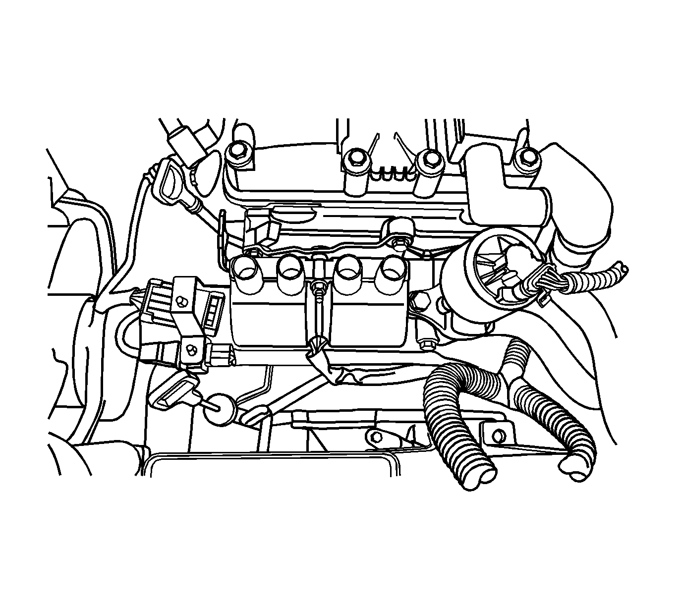

pic 5

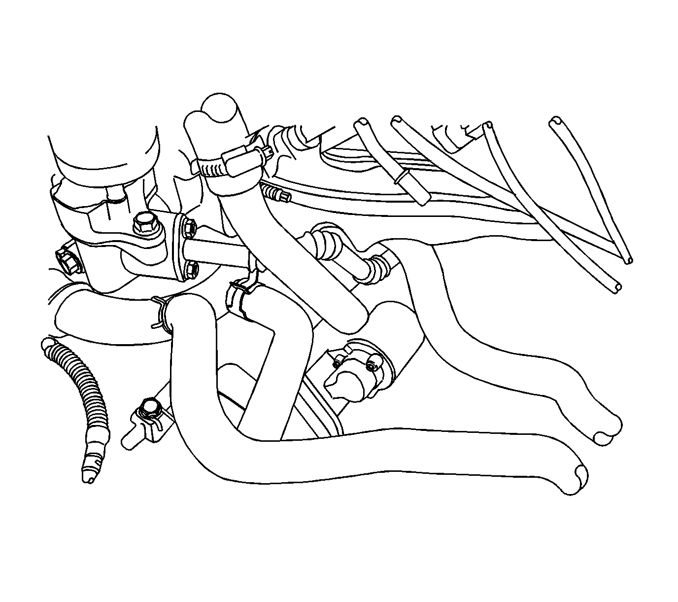

10. Disconnect the idle air control (IAC) valve connector.
11. Disconnect the throttle position (TP) sensor connector.
12. Disconnect the throttle cable from the throttle body and the intake manifold.
13. Disconnect the engine coolant inlet/outlet hose at the throttle body.

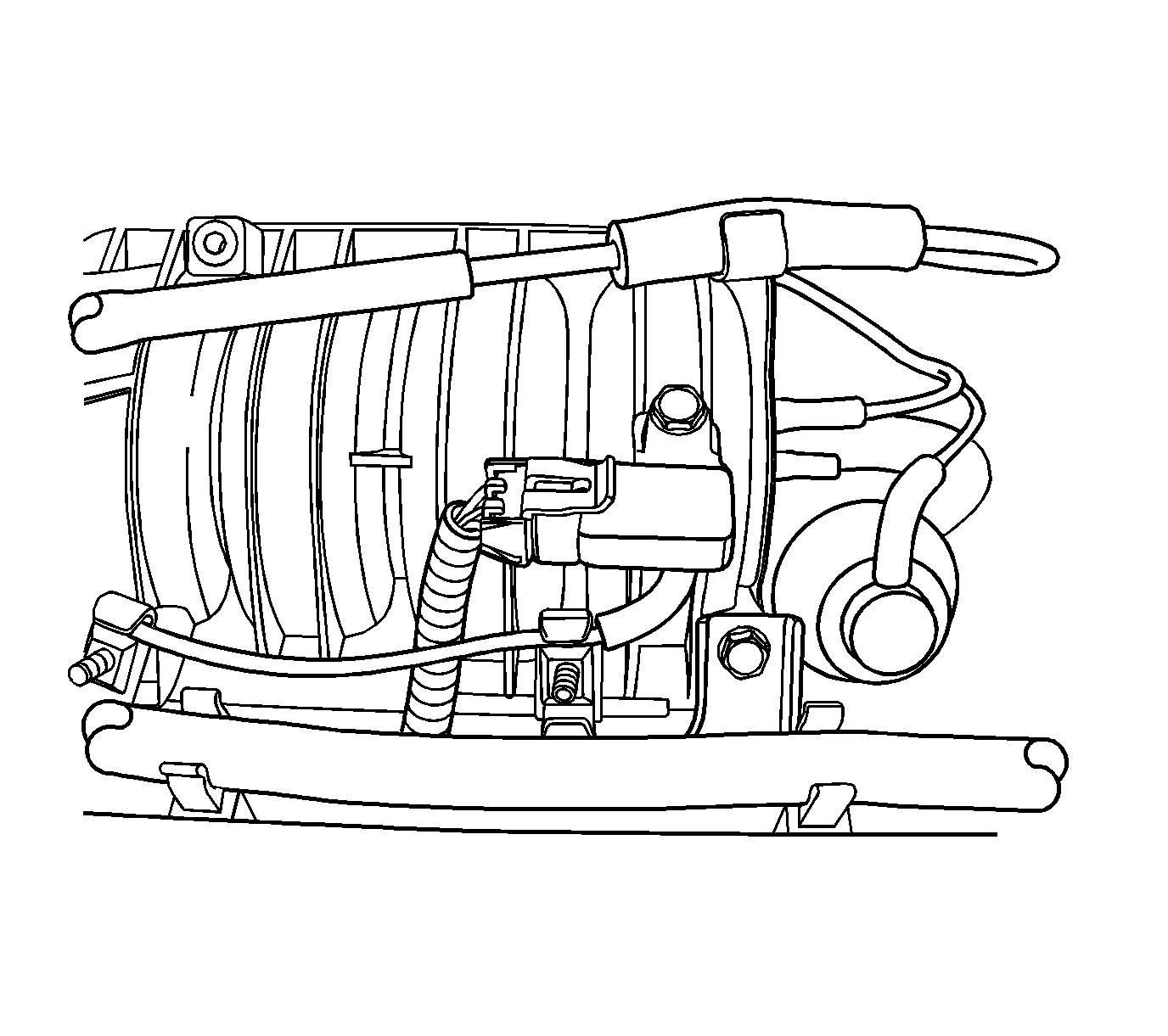

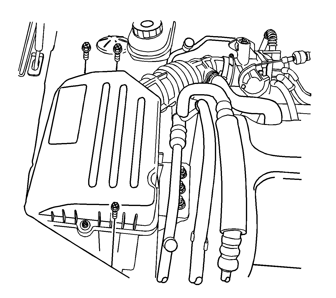

pic 6
14. Disconnect the manifold absolute pressure (MAP) sensor connector.
15. Disconnect the brake booster vacuum hose.
16. Disconnect the variable geometry induction solenoid (VGIS) connector.
17. Disconnect the VGIS vacuum tank hose.

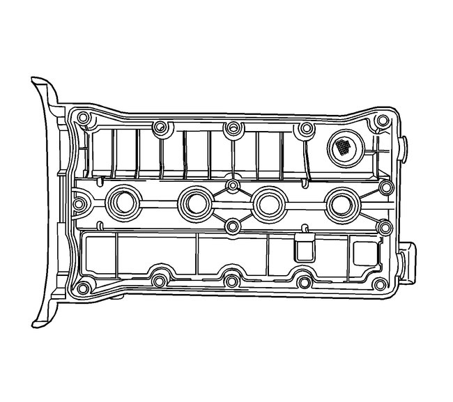

pic 7

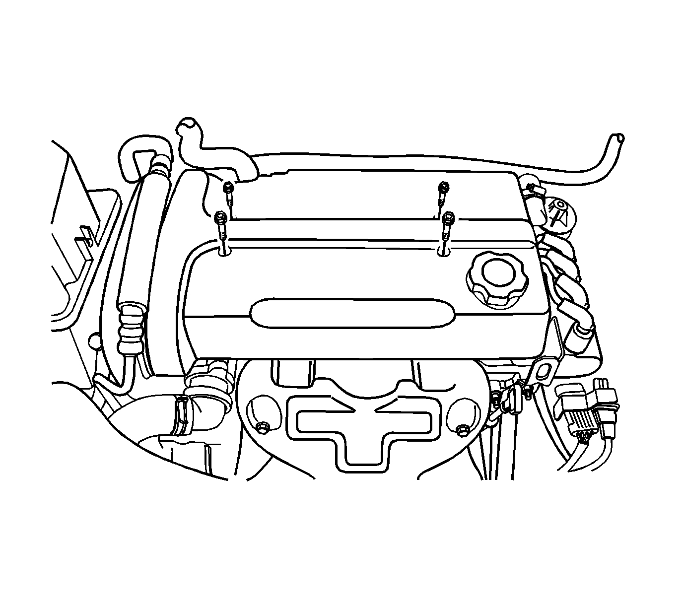

18. Remove the engine cover bolts and the cover.
19. Disconnect the breather tube from the valve cover.
20. Disconnect the crankcase ventilation tube from the valve cover.

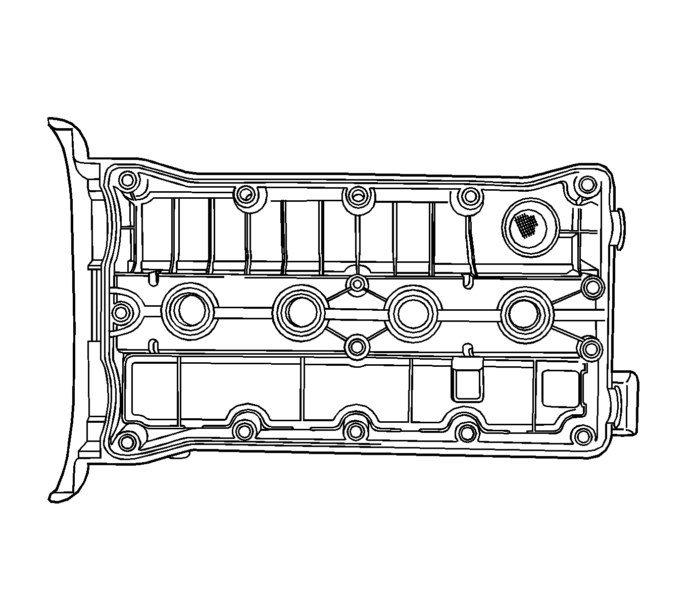

pic 8
21. Disconnect the camshaft position (CMP) sensor connector.
22. Disconnect the ignition wires from the spark plugs.
23. Disconnect the fuel injector harness connectors.

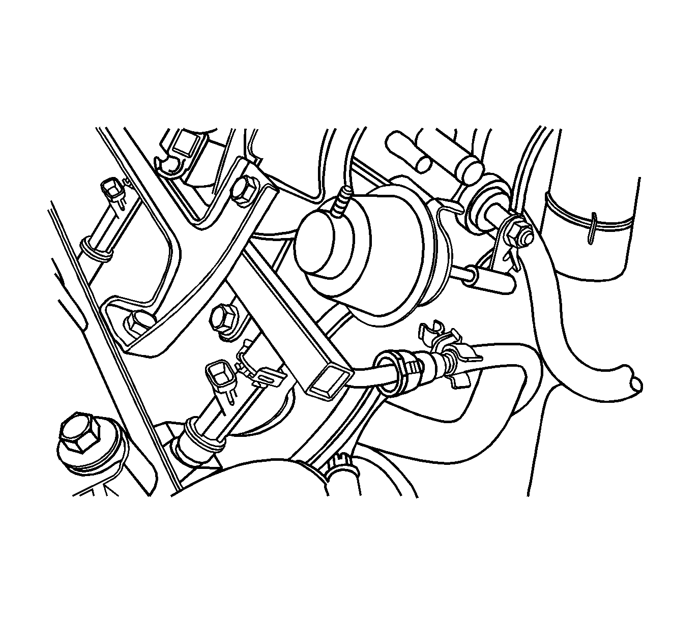

24. Disconnect the fuel line.

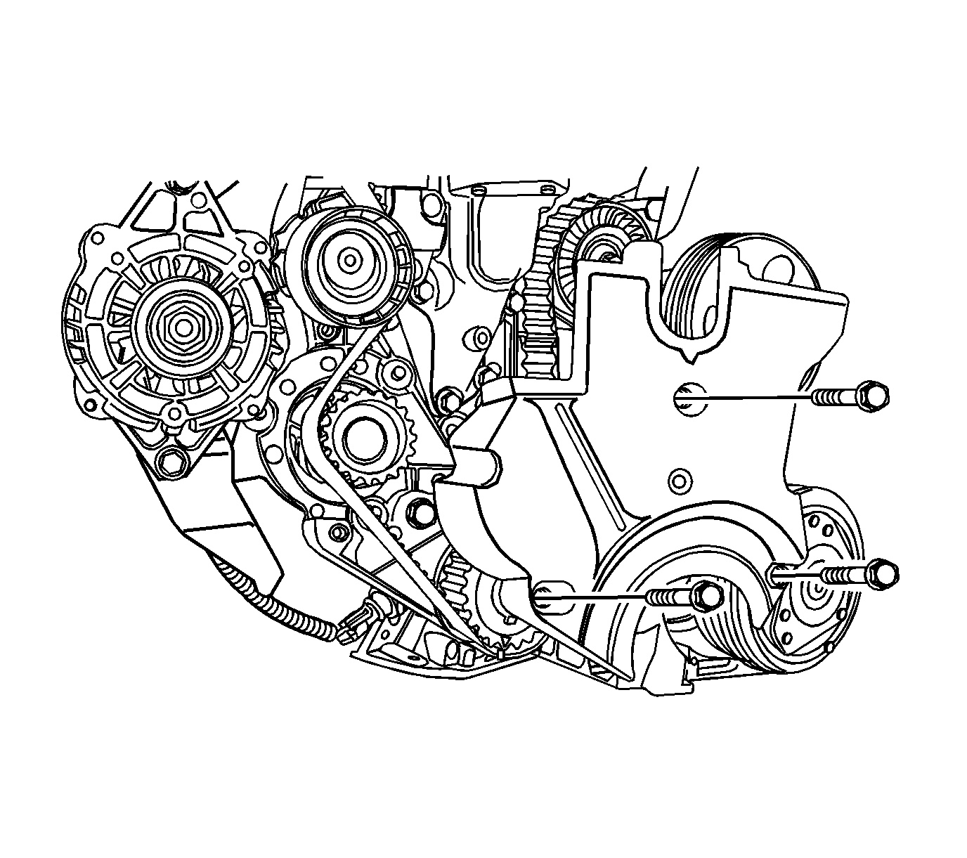

pic 11

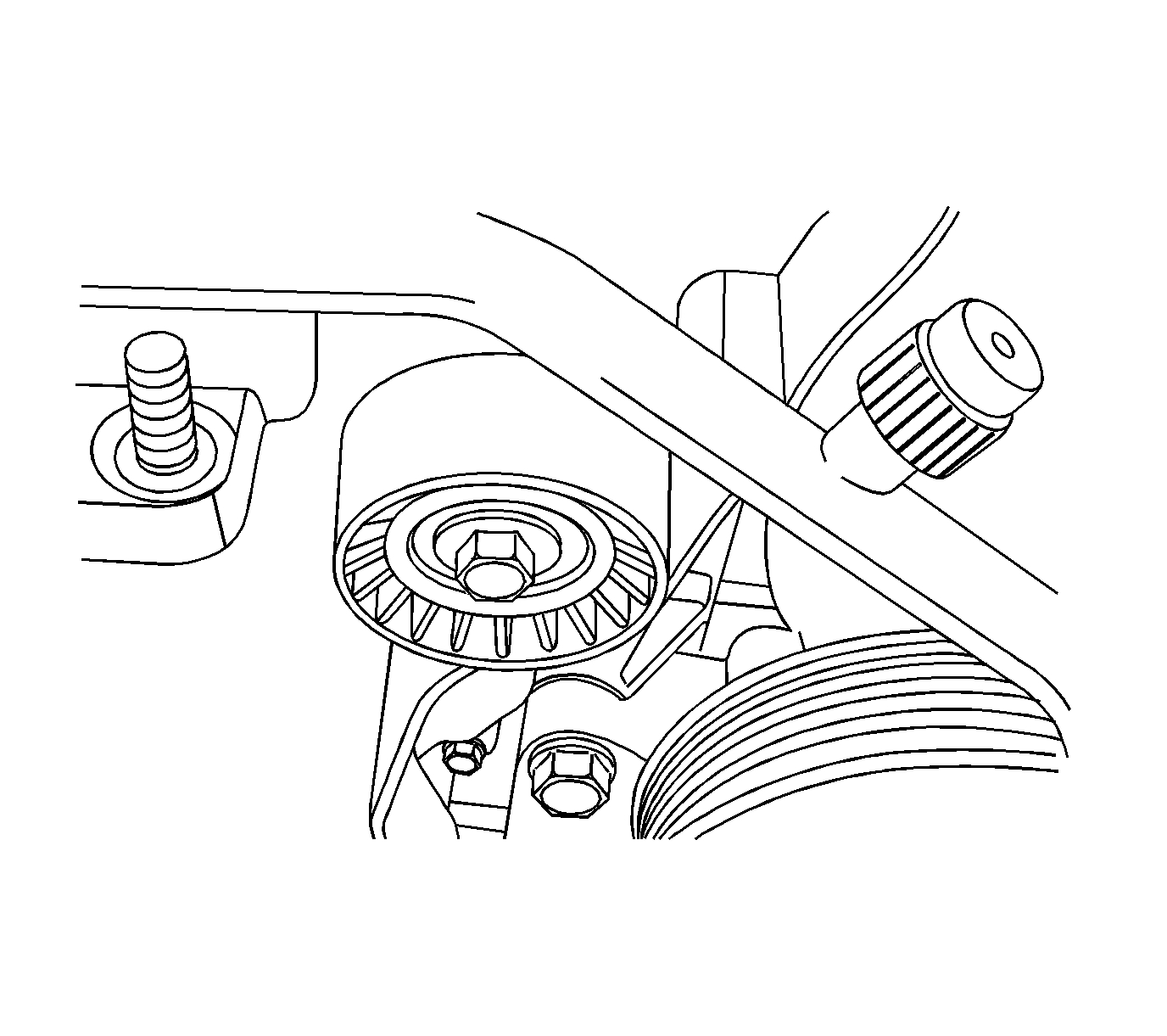

28. Remove the accessory drive bolt.
29. Disconnect the exhaust gas recirculation (EGR) valve connector.
30. Disconnect the ignition coil connector from the electronic ignition (EI) system.
31. Disconnect the front heated oxygen sensor (HO2S) connector.

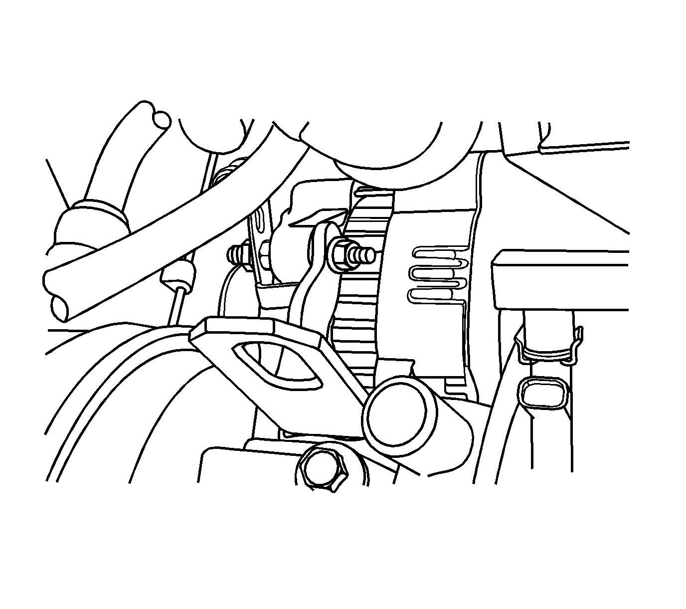

pic 12
32. Remove the right front wheel.
33. Remove the engine under-cover bolt and the nuts.
34. Remove the engine under-cover.
35. Remove the canister purge solenoid valve at the intake manifold support bracket.

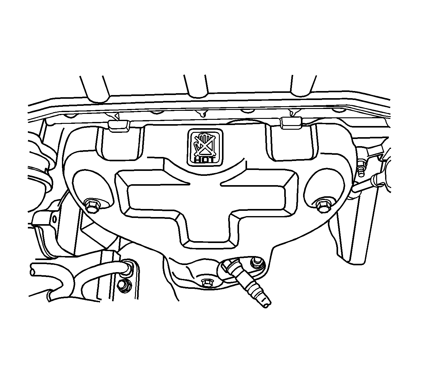

39. Remove the exhaust manifold heat shield bolts.
40. Remove the exhaust manifold heat shield.

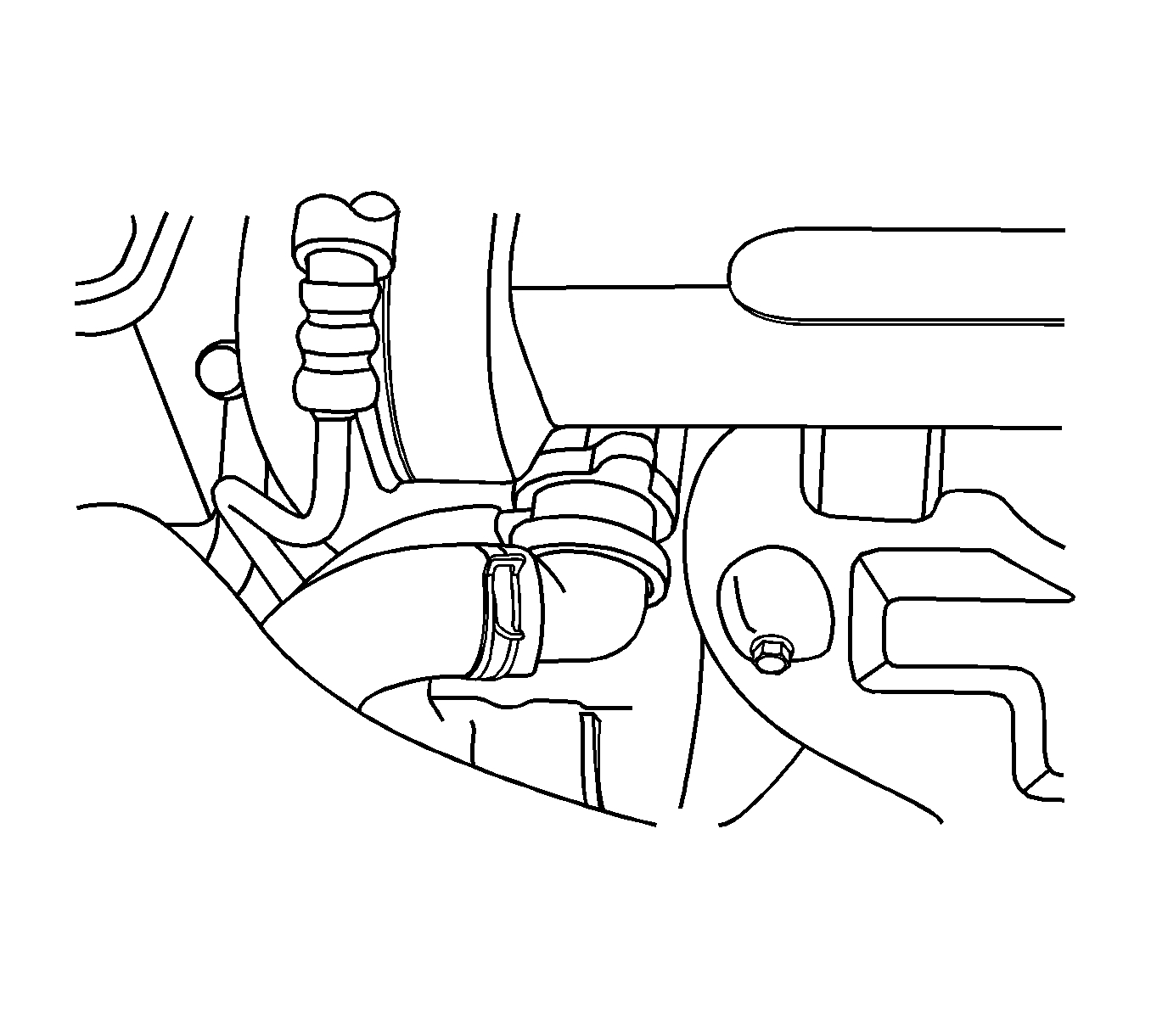

42. Loosen the hose clamp on the upper radiator hose at the thermostat housing.
43. Disconnect the upper radiator hose from the thermostat housing.

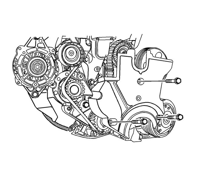

48. Remove the cover bolts from the lower front timing belt.
49. Remove the cover from the lower front timing belt.

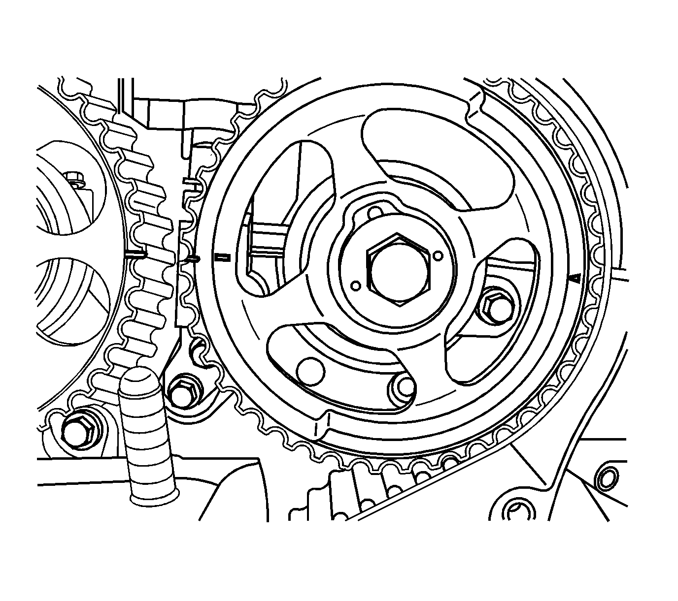

50. Align the camshaft gear timing marks.

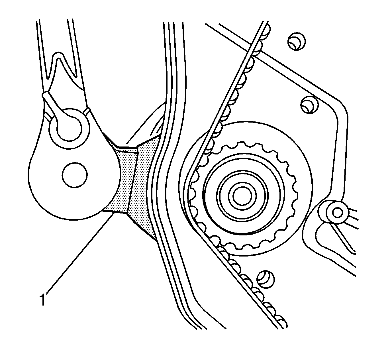

52. Rotate the coolant pump counterclockwise using J 42492-A (1) to relieve the timing belt tension.
53. Remove the timing belt.

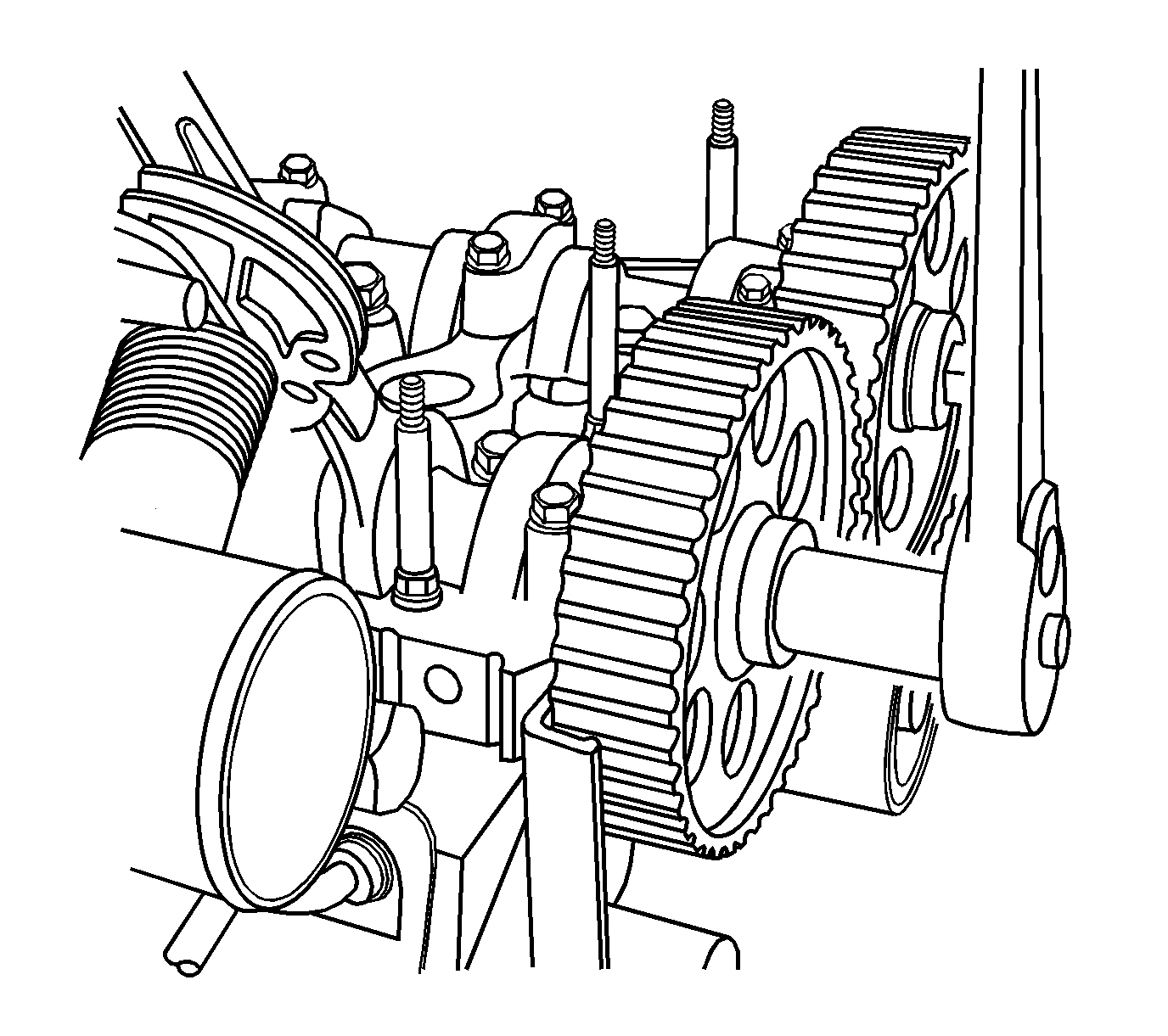

54. Remove the valve cover.
Notice: Use extreme care when installing the camshaft not to nick, scratch, or damage the camshaft lobes or bearing surfaces.
55. While holding the intake camshaft firmly in place, remove the intake camshaft gear bolt.
56. Remove the intake camshaft gear.
57. While holding the exhaust camshaft firmly in place, remove the exhaust camshaft gear bolt.
58. Remove the exhaust camshaft gear.

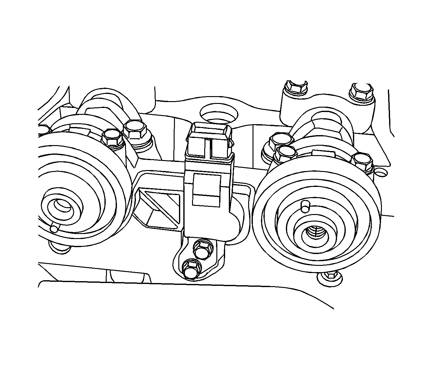

61. Remove the camshaft position (CMP) sensor bolts.
62. Remove the CMP sensor.

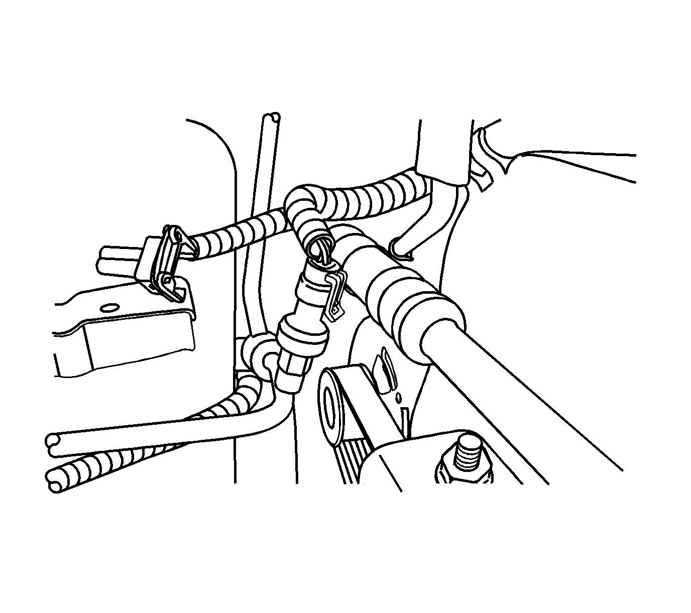

67. Disconnect the heater outlet hose from the coolant pipe.

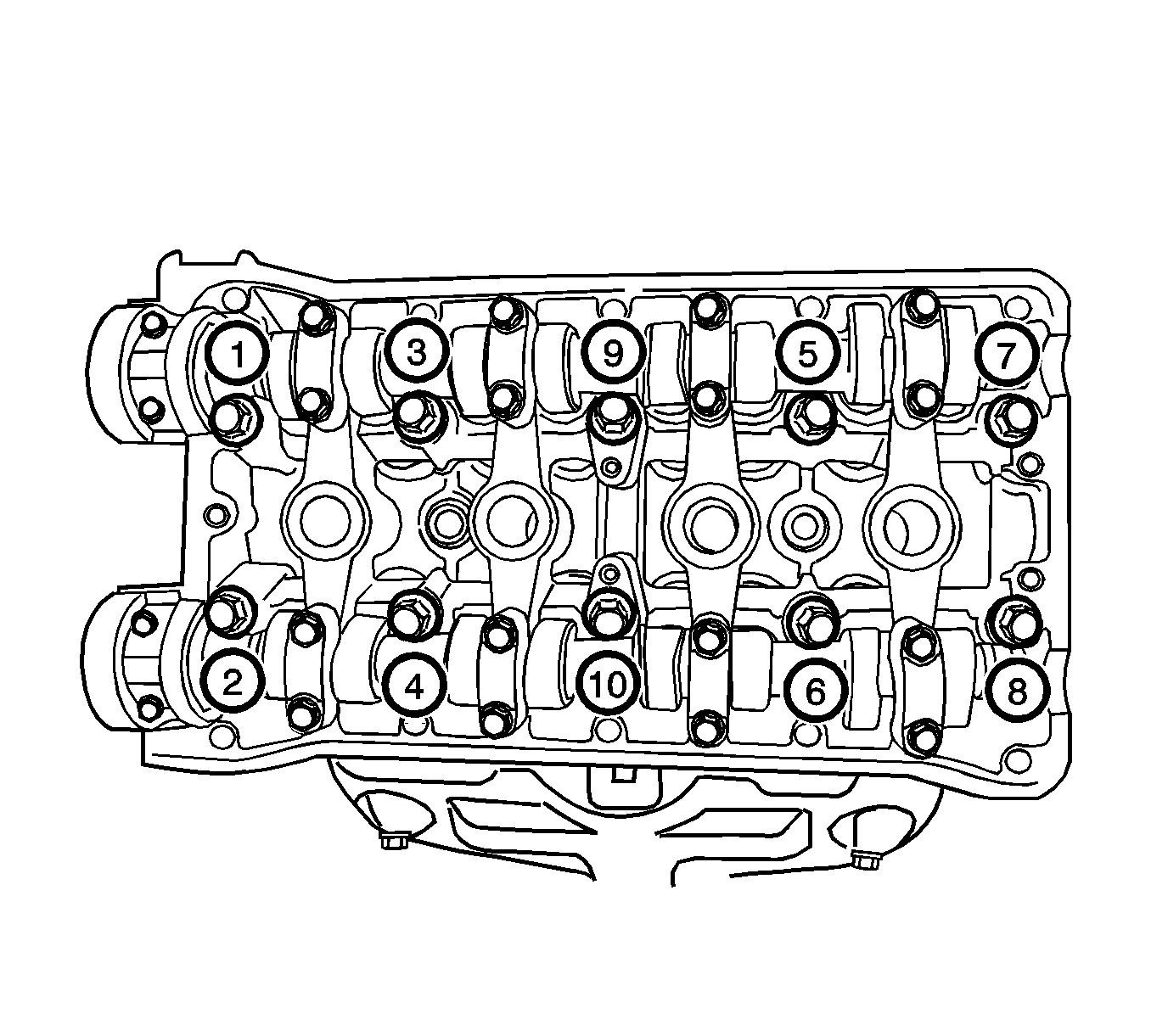

pic 27

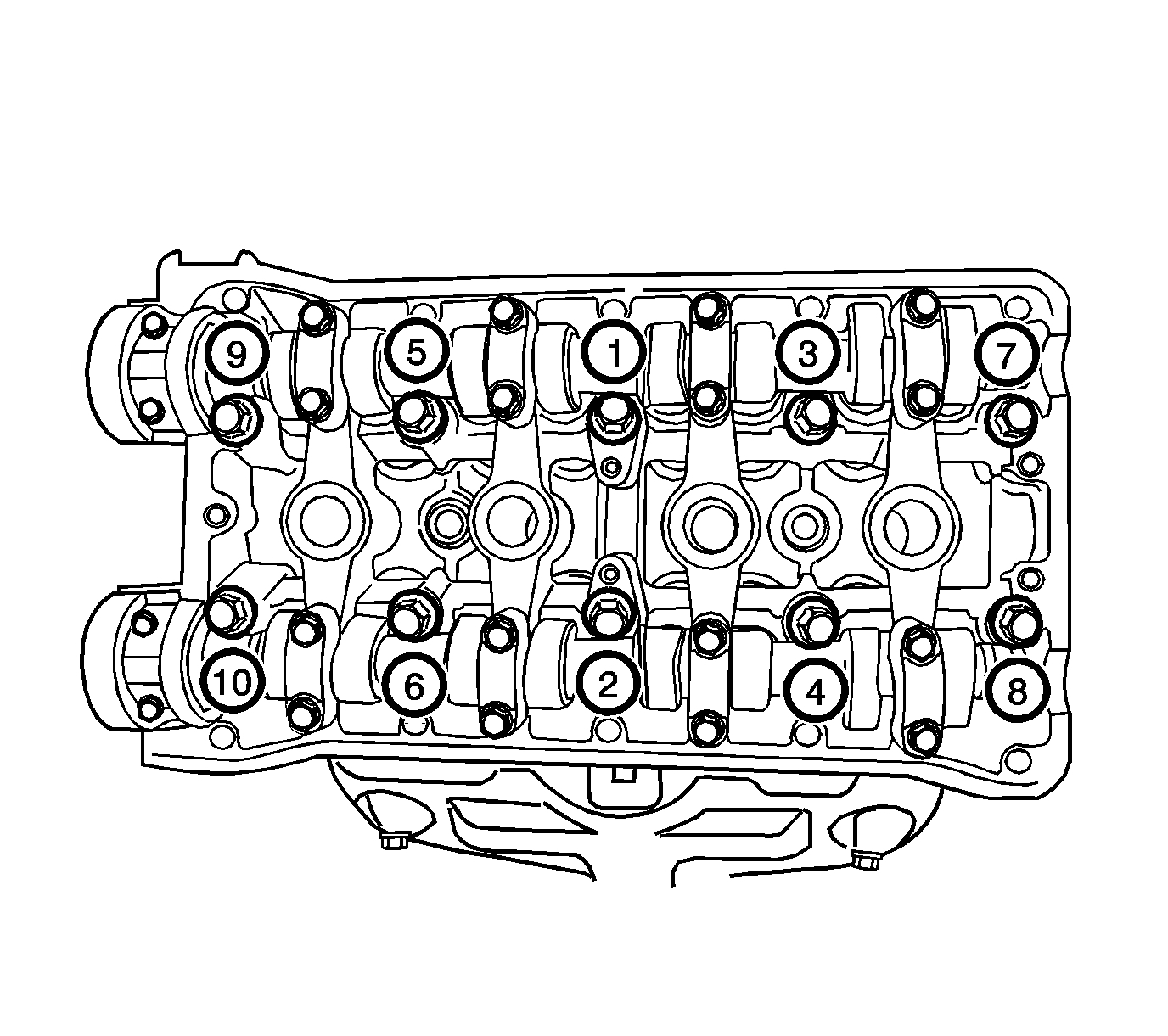

68. Loosen all of the cylinder head bolts gradually and in the sequence shown.
69. Remove the cylinder head bolts.
70. Remove the cylinder head with the intake manifold and the exhaust manifold attached.

5. Tighten the cylinder head bolts gradually and in the sequence shown.
Tighten the bolts to 25 N.m (18 lb ft). Adjust the bolts to 60 degrees plus 60 degrees plus 60 degrees plus 10 degrees using J 45059 or KM-470-B.

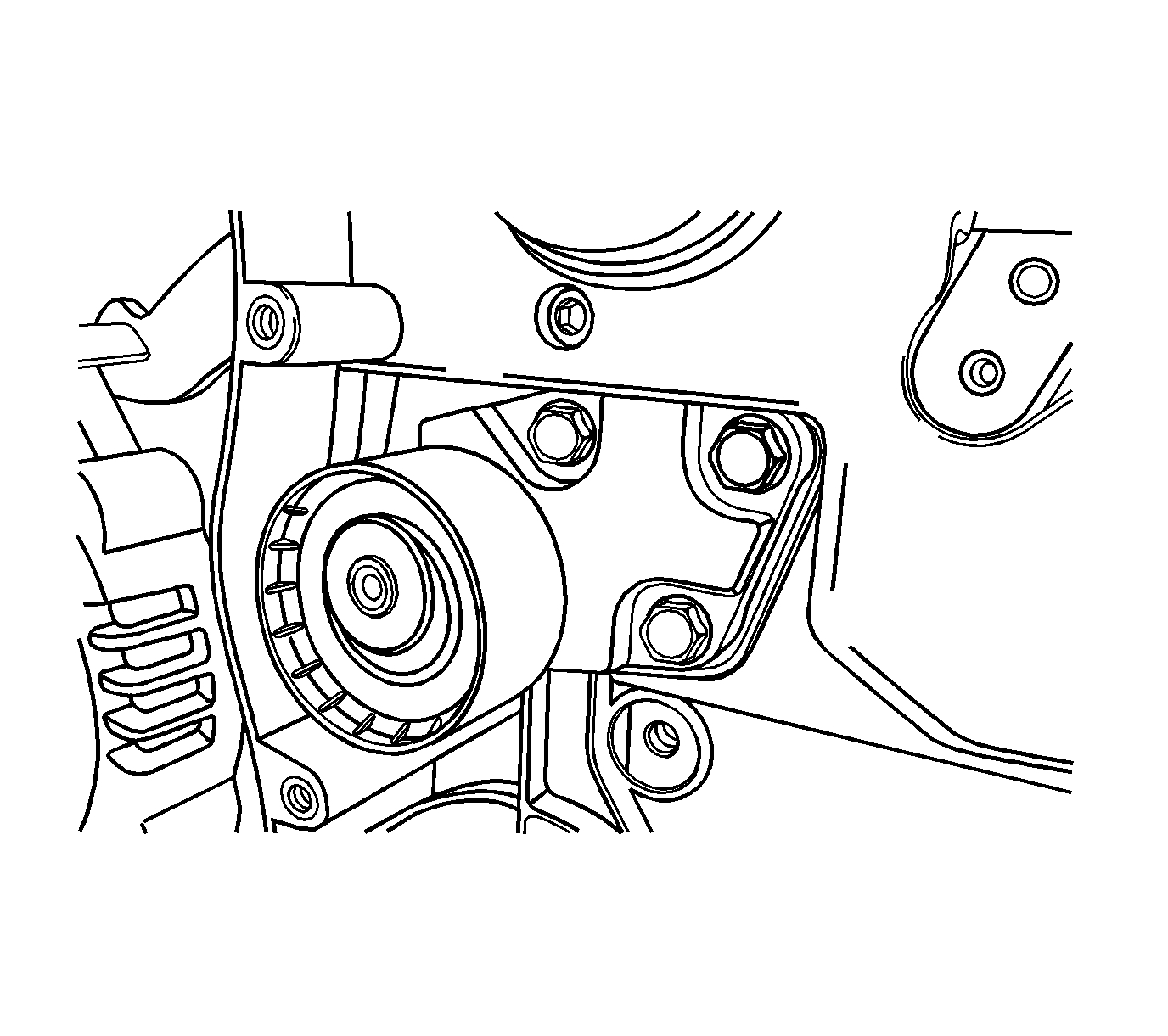

11. Install the timing belt automatic tensioner. Install the bolts to the timing belt automatic tensioner.

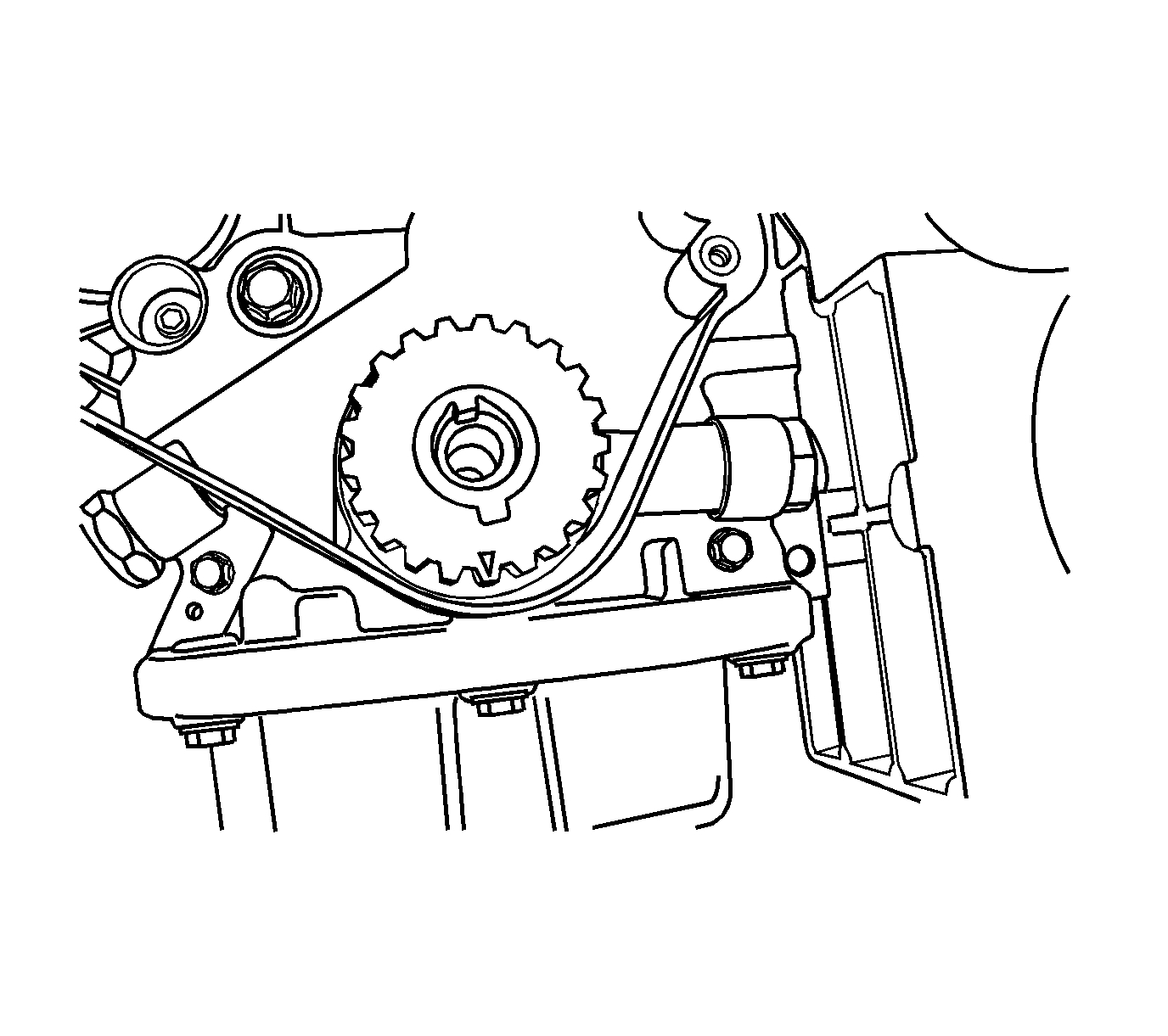

pic 37
20. Align the mark on the crankshaft gear to the notch at the bottom of the rear timing belt cover.
