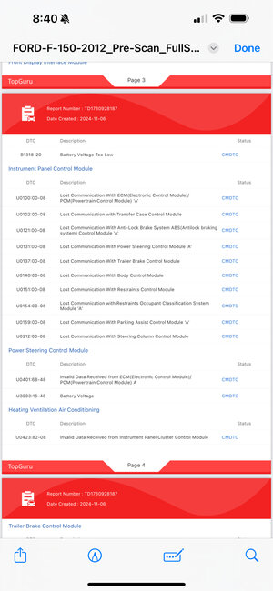

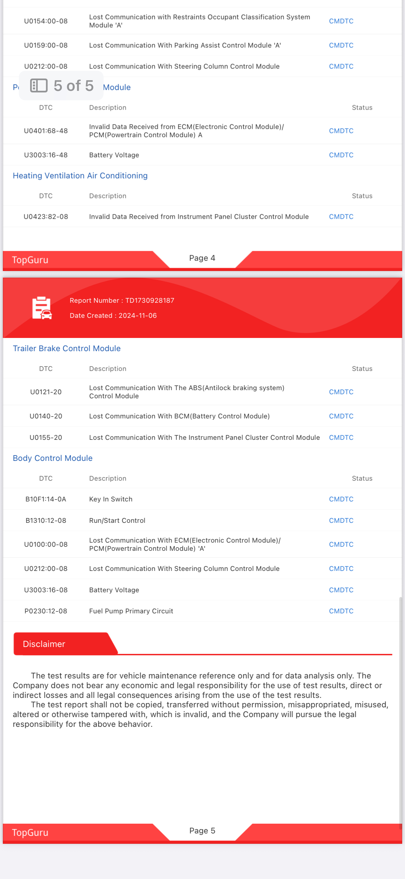

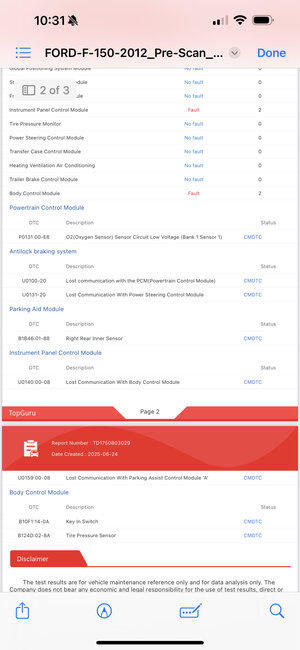

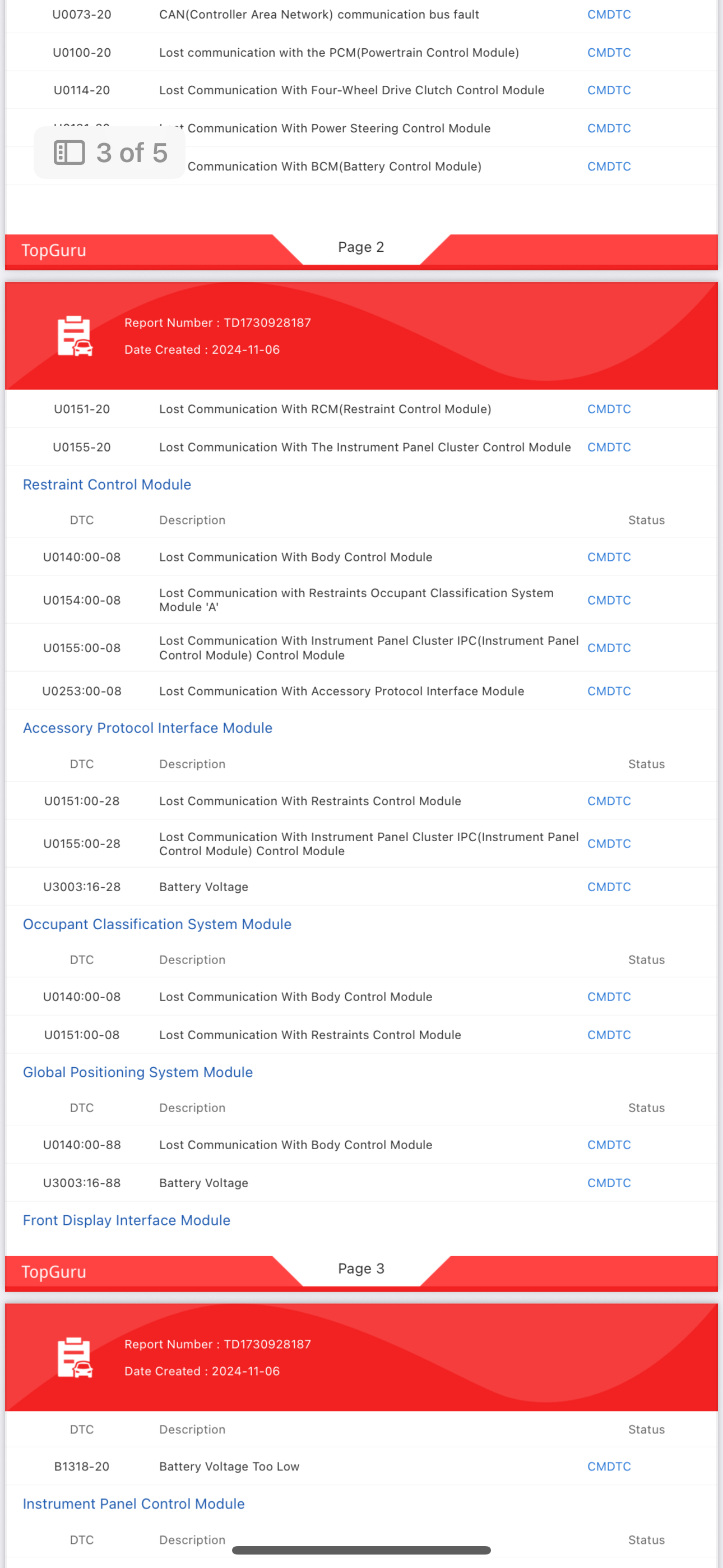

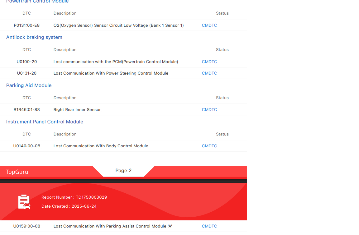

I bought this truck with 90k, and around 110k it started having the most bizzare electrical issues. Dash goes nuts, shuts off/on, stays off, service advanced trac and other warning lights come up, shifts into 4WD randomly. It only really happens when its below 40 degrees. The colder it is, the worse it is. I have to drive in 4WD in the winter time for about a half hour until the truck warms up, then it will stop. If its below 0, my headlights will turn on and off as they please with the lights set to Off and keys out.
I am at 175k now, so it is what it is at this point, just curious what you guys might think. I had it at the ford dealership 5 years ago when I bought it and they were stumped, replaced a bunch of modules, went through wiring/rewrapped it. Here's a video and some codes that it throws:
