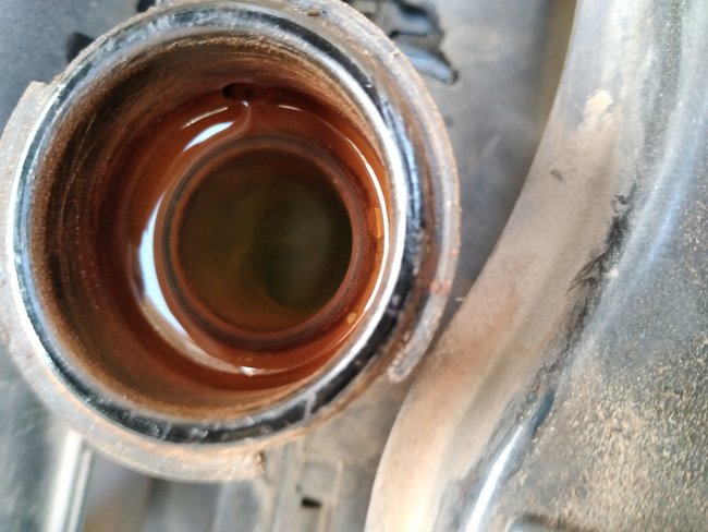

Knowing that my car was subjected to high temperature a year and half ago, but without harm to engine components. Yet, there were remaining residual corrosion particles on radiator internal surface.
Apr 1, 2022 at 7:31 AM
That appears to be rust. Is the fluid itself that color? If it is, I would suggest flushing the system.
Apr 1, 2022 at 1:57 PM

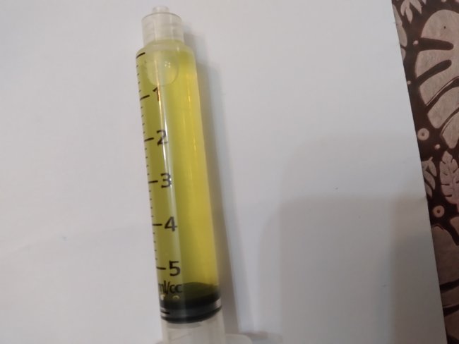

EMAD1964
  • 17 POSTS
No, the fluid color is green.
I have a syringe full of it. I filled this syringe from the radiator now.
Apr 1, 2022 at 5:49 PM
That actually looks really good. I would leave it alone. The next time you plan to change the fluid, simply follow the link I attached above for flushing the system.
