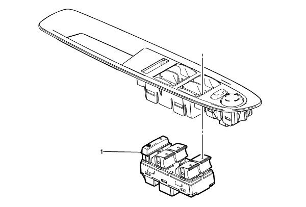

I might try to clean the swith before heading back to the dealer. How is driver door taken apart on 2012 GMC Acadia SLT?

You do not have to take the door apart. The switch pops out from the top. Do not try to take it apart though. Spring loaded parts will fly out everywhere.
