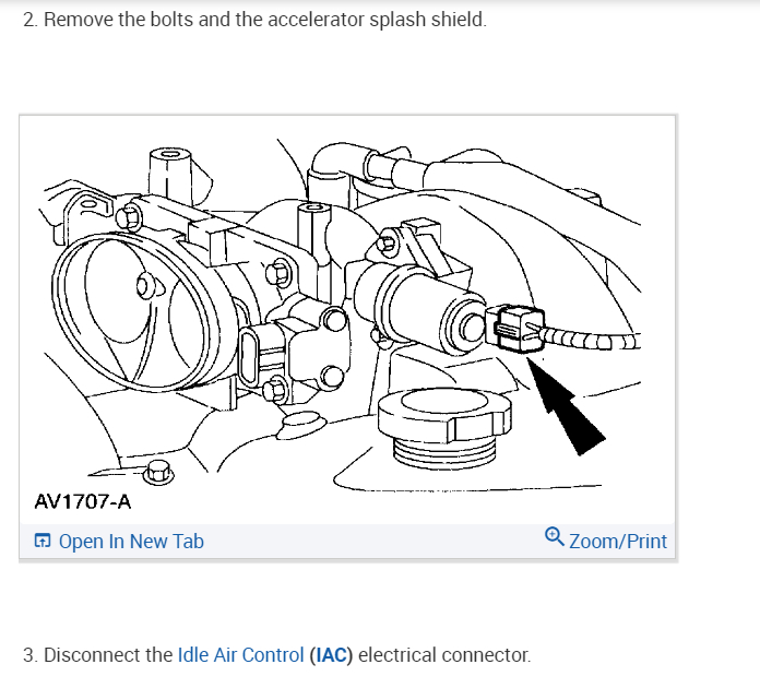

While sitting at idle the cold air intake tube will start to make a noise, like blowing into a bottle, and pretty loud. If I give it gas it'll stop. I put my hand on the intake tube where the intake manifold temperature sensor is, and it vibrated pretty good when the (sucking?) noise started. I've changed the mass air flow sensor and the air filter. All the connections are tight but it's making this noise. I'm trying to get a video, but it doesn't always happen.
Apr 20, 2023 at 5:23 PM

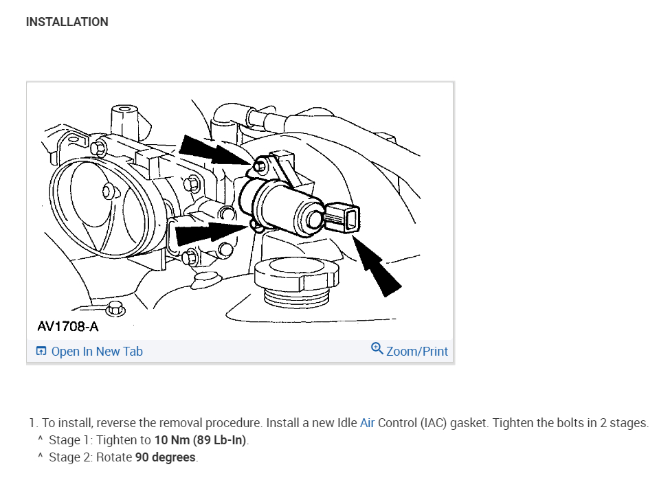

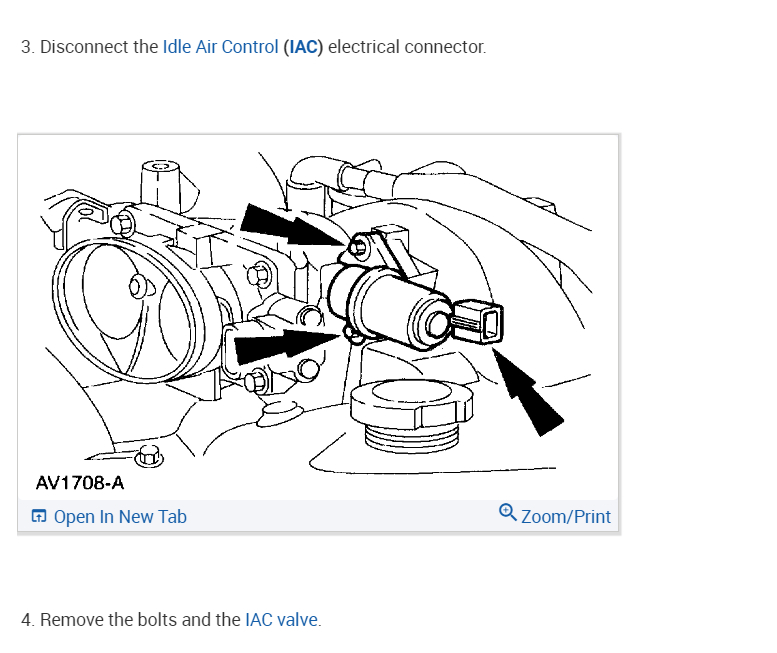

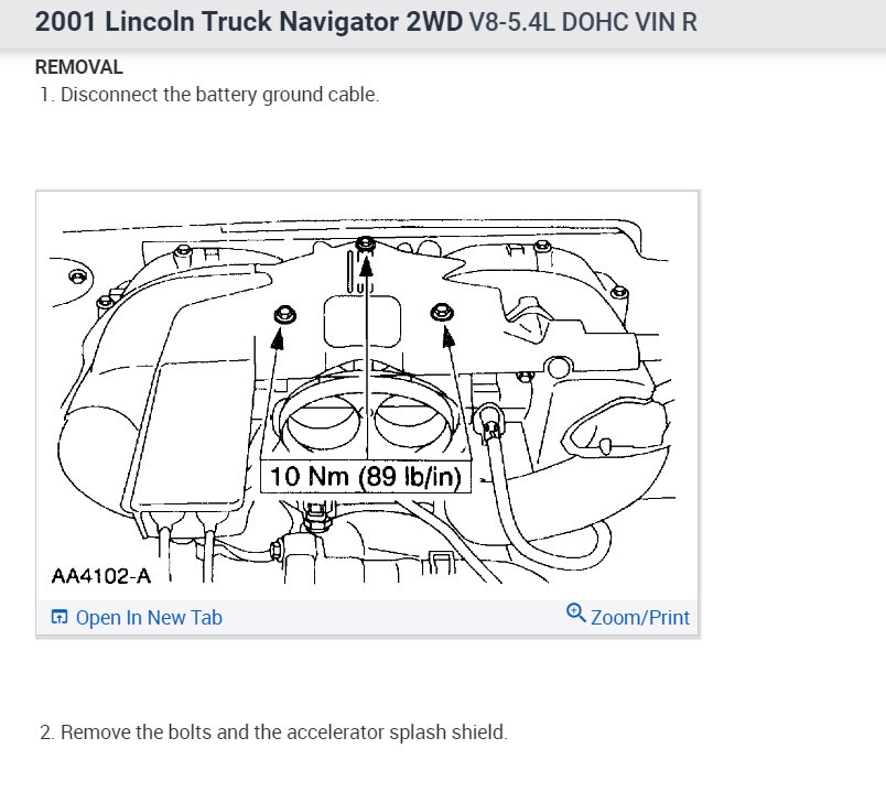

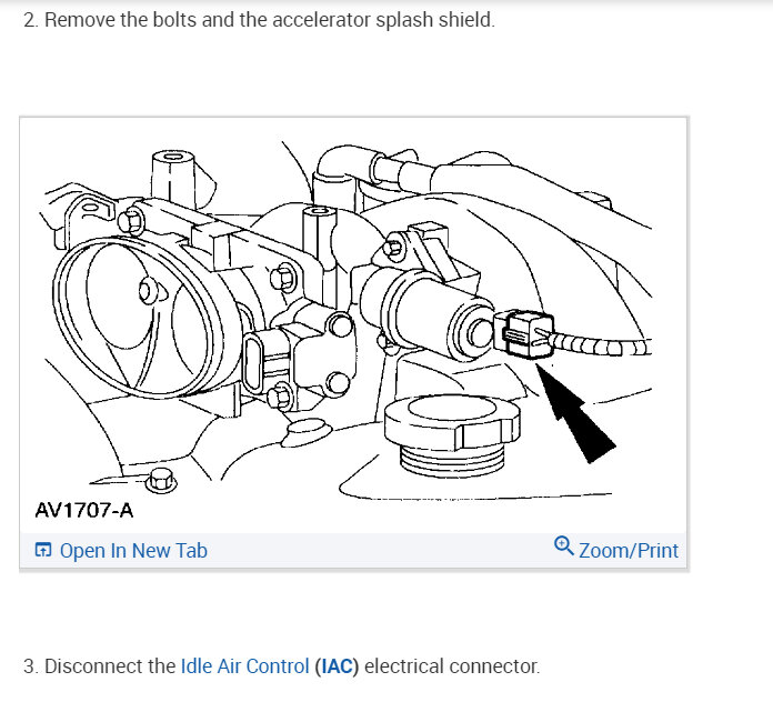

Yep, this honking noise is caused by the IAC motor that needs to be replaced. To be sure, can you please shoot a quick video with your phone so I can hear the noise? That way I can tell for sure what's going on. You can upload it here with your response. Here is the location of the IAC in case you need it. Check out the images (below). Please let us know what happens.

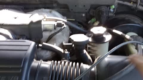

Guess what fellas I finally got the cold air intake noise on film. I hope you guys can figure it out.

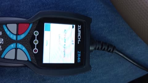

I know i can be frustrating but hang in there. I cant see the scanner screen in the video you uploaded. Also did you use an OEM part?
Here is the part I would install:
https://amzn.to/44hxm2U
The noise definitely sounds like the IAC, did the noise go away when you changed it?

The IAC will not cause lean conditions in bank one or misfires, I can't see the screen on the scanner. If we are going to address the misfire issue you will need to start a new question because we only handle one problem per thread.
