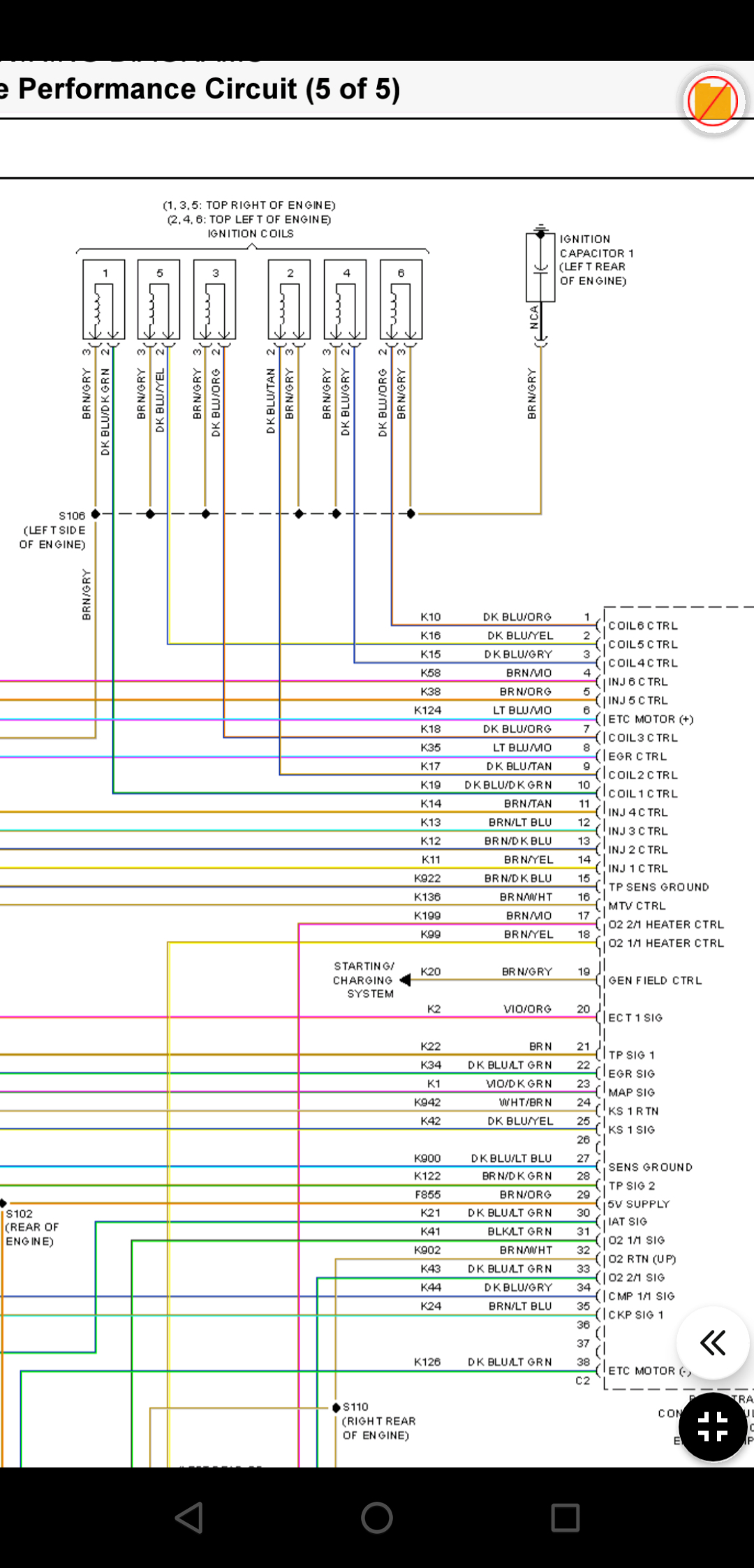

I have the vehicle listed above that triggered the engine light on and it started running rough. I turned the car off and then back on, and it was running like normal.
I checked the code with one of those AutoZone $50.00 code readers, and it showed as the coil F and D weren’t working. (code p2311 and p2317) I replaced them Even though the engine was working completely fine, I did the unplug and plug test, all coils were all working, the wiring doesn’t look bad or anything, spark plugs were replaced too. I cleared the code on the ECM with the code reader and i turn off the engine light with the “put the key to on three times” method but every 100-200 miles the engine light turns on, which makes the engine run rough (literary just when the engine light turns on, I literary turn the car off and on, and it runs perfectly, smoothly, like all coils are working perfectly!). Help, I’m running out of ideas.
