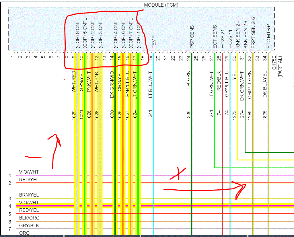

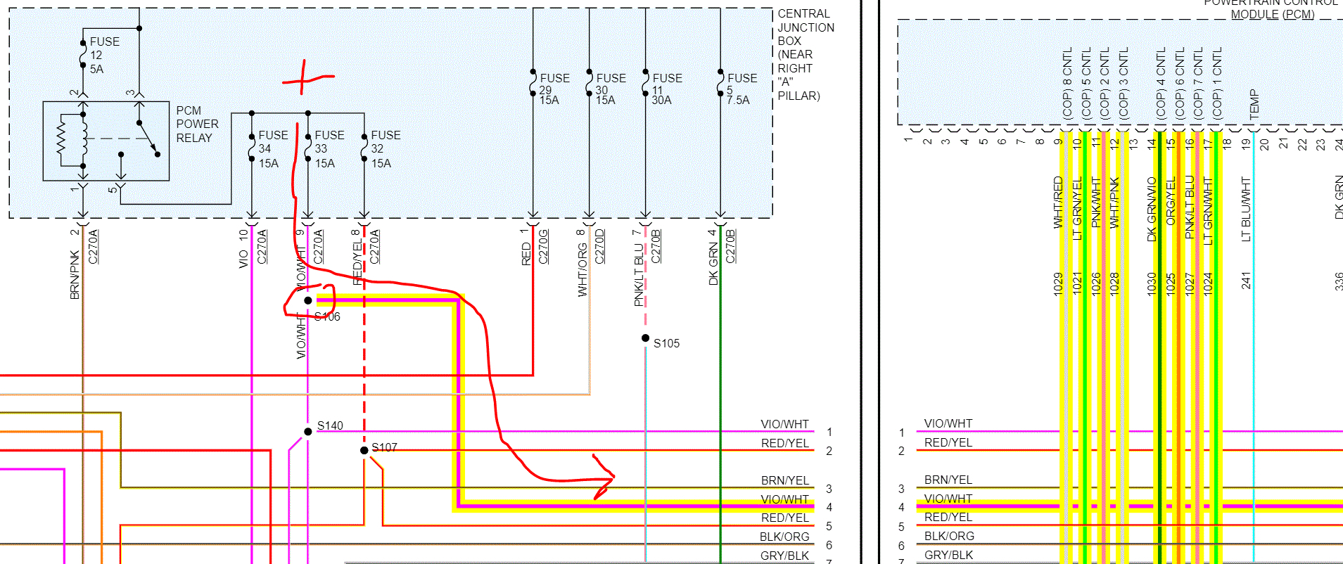

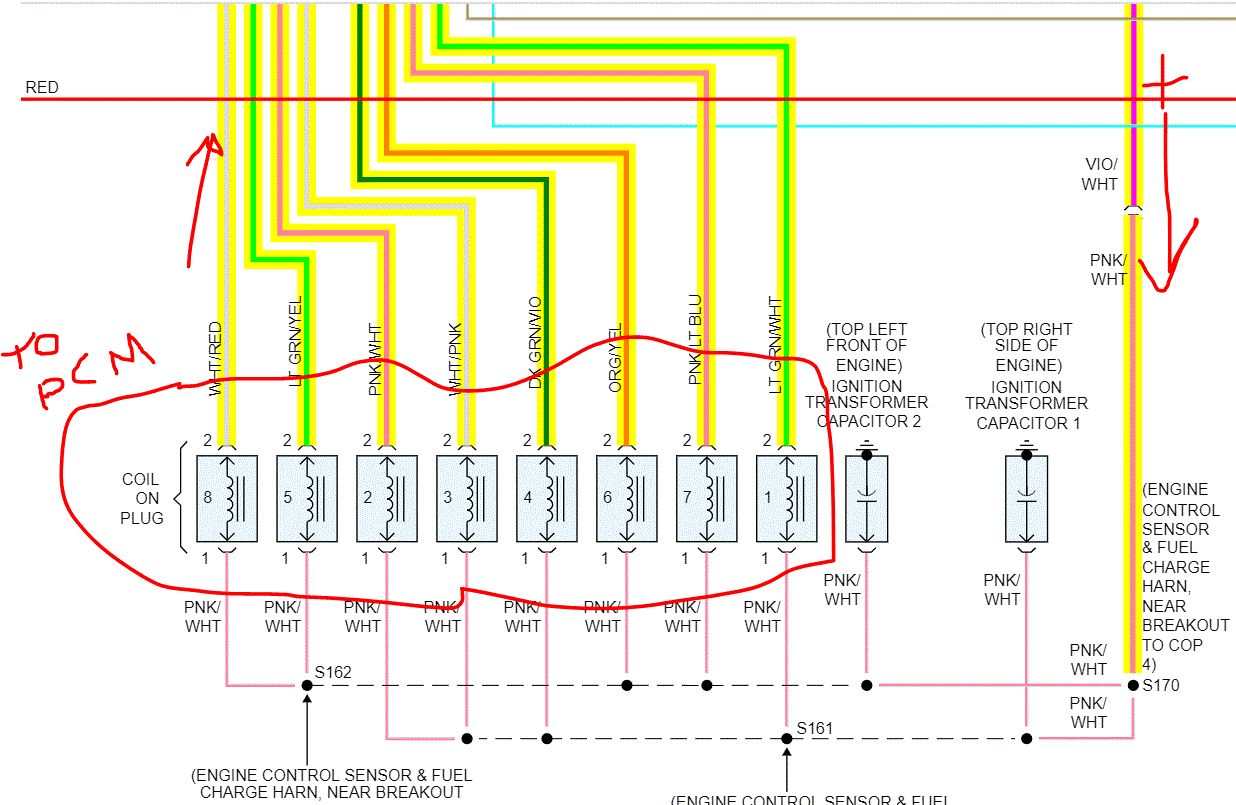

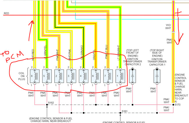

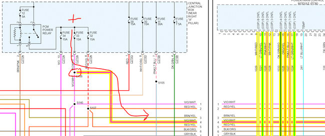

Are all 8 going bad? What codes are stored when this happens? As far as possible issues, that's tough if all go bad. All coils have power all the time and don't fire until a ground path via the PCM is provided. If you take a look at the attached pics, I copied portions of the system to show you how it functions. I guess a weak ground due to corrosion at the PCM can cause coils to overheat, but I can't imagine they all go bad at once.
Check to make sure there isn't oil laying in the plug wells causing them to short.
Let me know if that is the case (they all go bad at once). Also, take a look at the pics and let me know if you have any questions.

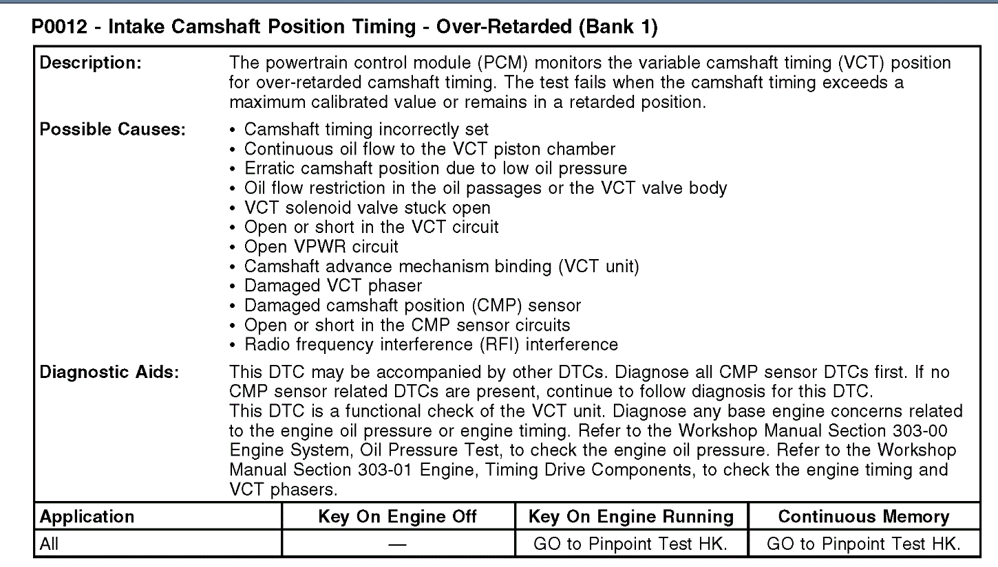

The code indicates the camshaft timing is over retarded. That has nothing to do with the coils, but that is an odd to get and then have go away. Take a look at the attached pic for possible causes for that code to exist.

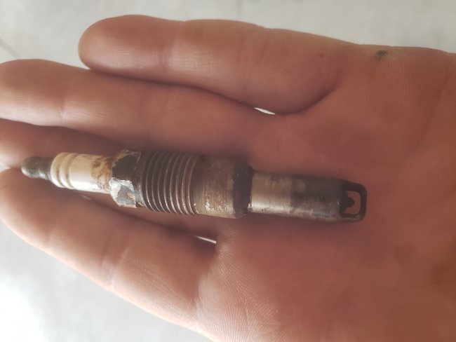

Oh yeah, you can definitely feel the misfire, the whole truck is shaking and barely able to stay running at idle, if I shift it into gear the idle drops and it stalls out, yes that is the only code being shown, I've scanned it with 2 different scanners, the last one was the Apollo from snap on and the misfire on cylinder 3 is the only code showing, this is the spark plug I pulled from that cylinder, all cylinders now have the new 1 piece Motorcraft spark plugs with correct gaps, and all the coils have tested good both on another truck and an ohmmeter.

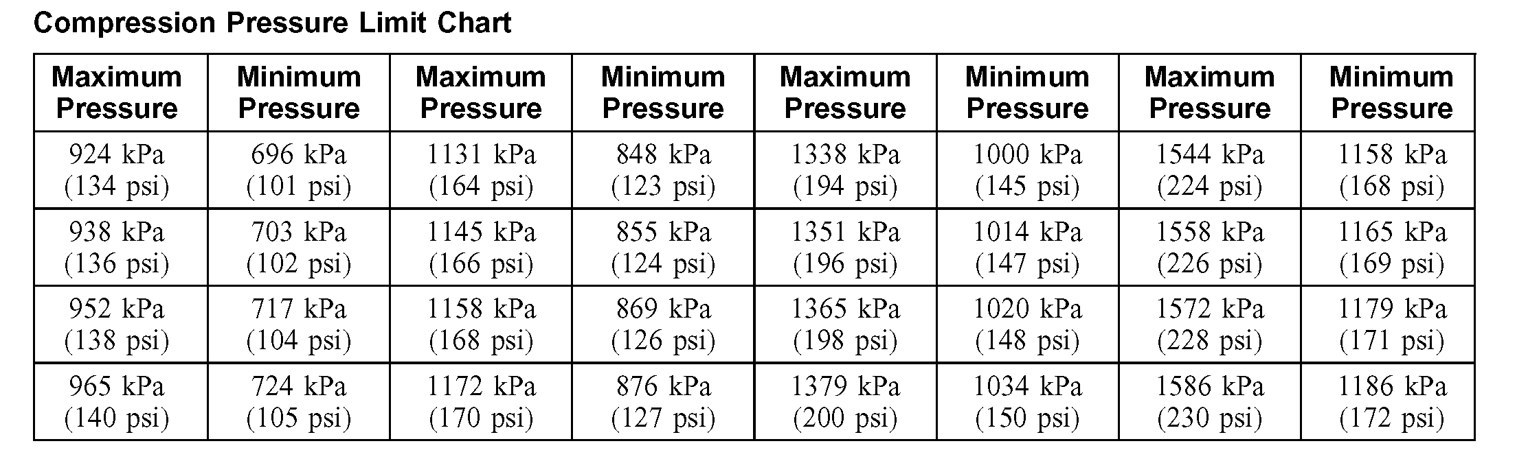

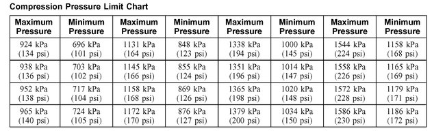

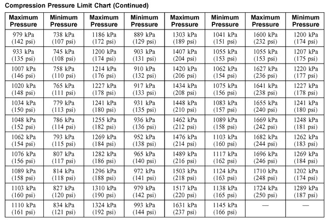

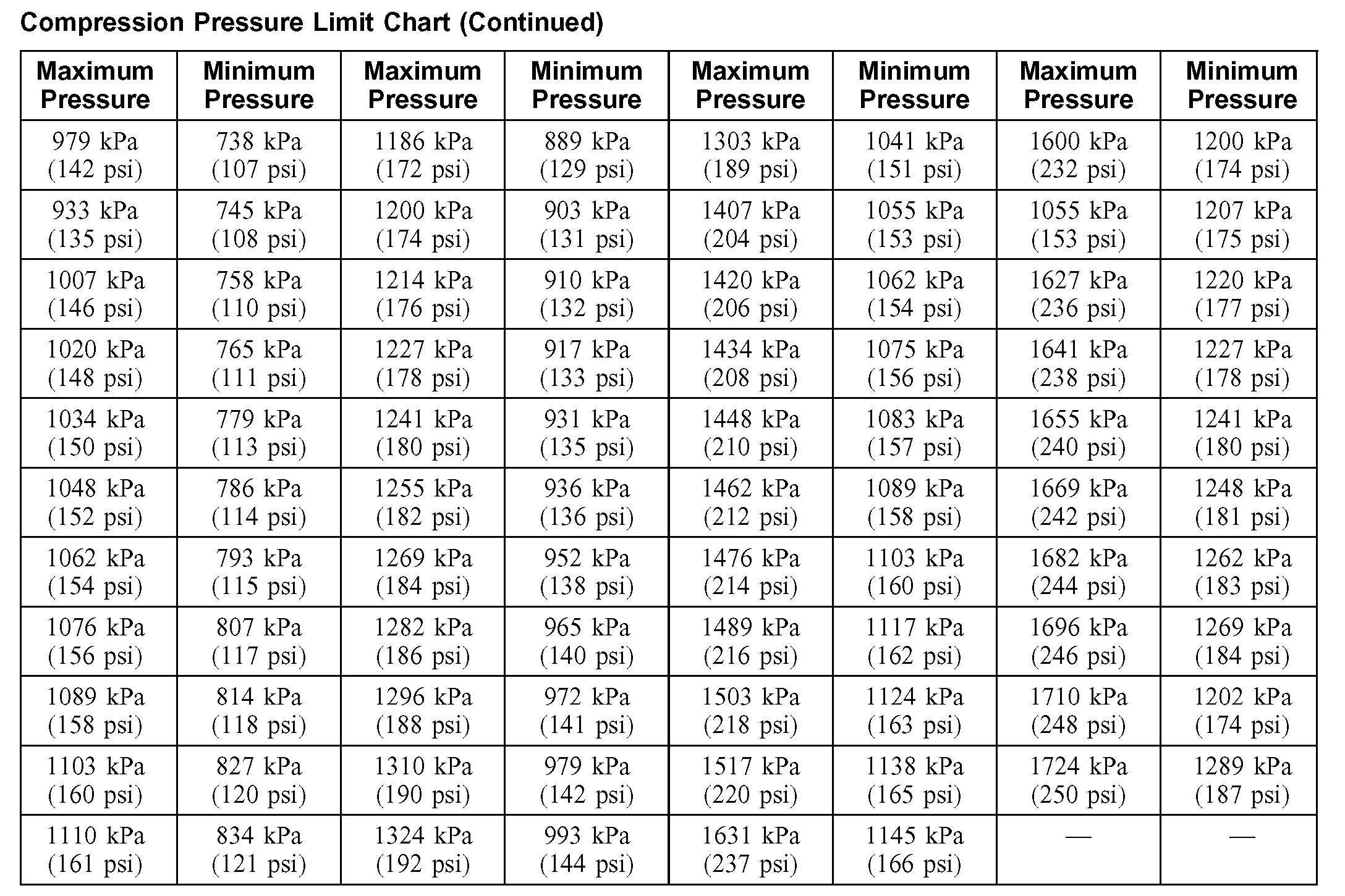

That is a good idea. If the injector isn't the issue, then we need to do a compression test on that cylinder. Here are a couple links that you may find helpful:
https://www.2carpros.com/articles/how-to-test-a-fuel-injector
Here are the directions from Alldata. That attached two pics correlate with the directions.

Compression Test - Test Results
The indicated compression pressures are considered within specification if the lowest reading cylinder is at least 75 percent of the highest reading. Refer to the Compression Pressure Limit Chart.
pic 1
pic 2
If one or more cylinders reads low, squirt approximately one tablespoon of engine oil on top of the pistons in the low-reading cylinders. Repeat the compression pressure check on these cylinders.
Compression Test - Interpreting Compression Readings
1. If compression improves considerably, piston rings are faulty.
2. If compression does not improve, valves are sticking or seating incorrectly.
3. If 2 adjacent cylinders indicate low compression pressures and squirting oil on each piston does not increase compression, the head gasket may be leaking between cylinders. Engine oil or coolant in cylinders could result from this condition.
Use the Compression Pressure Limit Chart when checking cylinder compression so that the lowest reading is within 75 percent of the highest reading.
