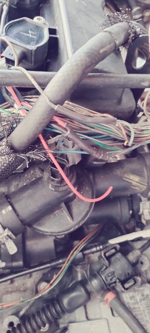

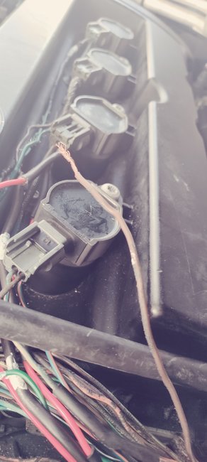

I opened up the harness in this area and made the mistake of not taking photos of the wires now what I'm up against is this. Each connector has two wires with a three-prong female end. There are all different colors no two are the same color. So, A cylinder or number 1 has power when using a test light. None of the other cylinders have power. I cut the wires because I had intentions of replacing all the connectors using a kit. Sold for $70.00
Here's the thing there is one brown wire which is hot. If I take one wire from each of the other three connectors 2, 3, 4, and touch them to a bare spot on this brown wire which by the way was already bare except there was glue I scraped off the other connectors become hot, and the car runs. problem in is I feel this not the way these wires should be. But I see no corresponding wires of the same color as the ones coming out on of the connectors. That is further down the harness so I could splice new wires together. The brown wire that's live goes to number 1 cylinder. Do all the other connectors get power from this one wire?

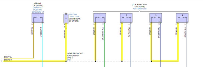

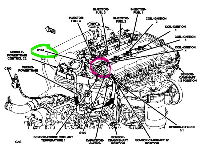

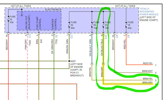

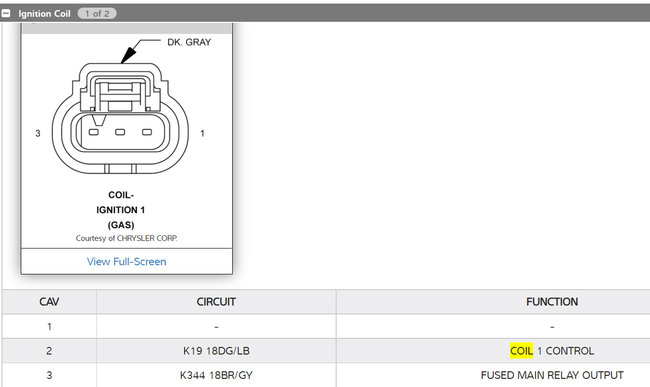

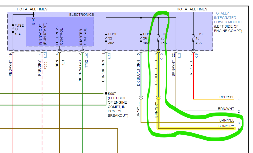

Hello, that brown/gray wire does power all the coils, as well as the Fuel Injectors. It comes from Fuse # 23 (15Amp) in the fuse panel in the engine compartment. The diagram below will show you there is a splice pack to check. Where the wire comes together and goes out to the Capacitor. Thats where you need to check and see if there is an issue with corrosion or other broken wires, even a small pin hole is a wire can cause a lot of corrosion inside a wire. It can infect feet of a wire like an infection. It can end up being all green and corroded inside. So, if the wire had some glue on there, someone else would have been in there trying to fix something and didn't do it correctly. I'll post the wiring diagrams below for you, if you find more corrosion and/or broken wires, the best thing is to fix them correctly, so this doesn't happen again. If you have to replace a section of wire. Buy the heat shrink connectors, these connectors when heated will shrink around the wire and prevent any moisture from getting inside. I will post a picture of them in just a minute.

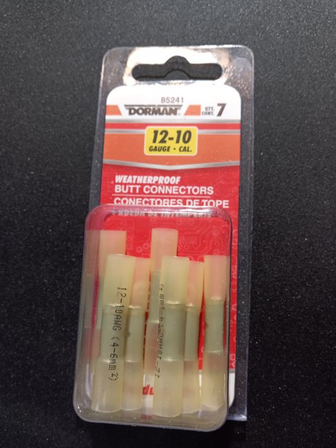

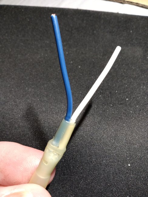

These yellow ones are for a bit larger wire size, you will probably need the blue ones. After you use these to connect wires together, heat them lightly, don't overheat them, just enough so you see them seal around the wire. A heat gun is best, but you can get away with just using a lighter if you go easy on them.

Hello AL514, is there a junction where the 4 coil wires tie into the brown, grey hot wire? I'm not sure how to reconnect these wires all back together there's one hot wire per coil
Do they all connect together at the same spot on the brown wire? That doesn't seem right. JC

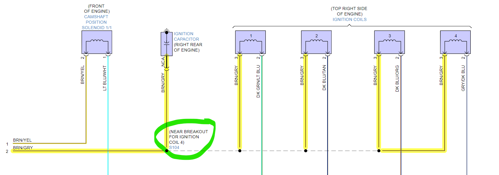

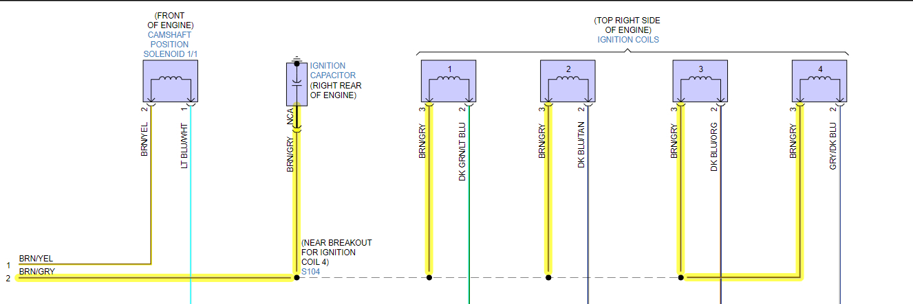

Yes, they all tie together at the point where the Ignition Coil Capacitor meets up. The capacitor is that little square looking thing that is bolted to the ignition coil pack. It's a one wire device. No i wouldn't replace the whole harness, you'll be there forever doing that. I will go out and take a picture of my capacitor on my truck and post it in a minute for you. Can you follow the wiring diagram, okay?

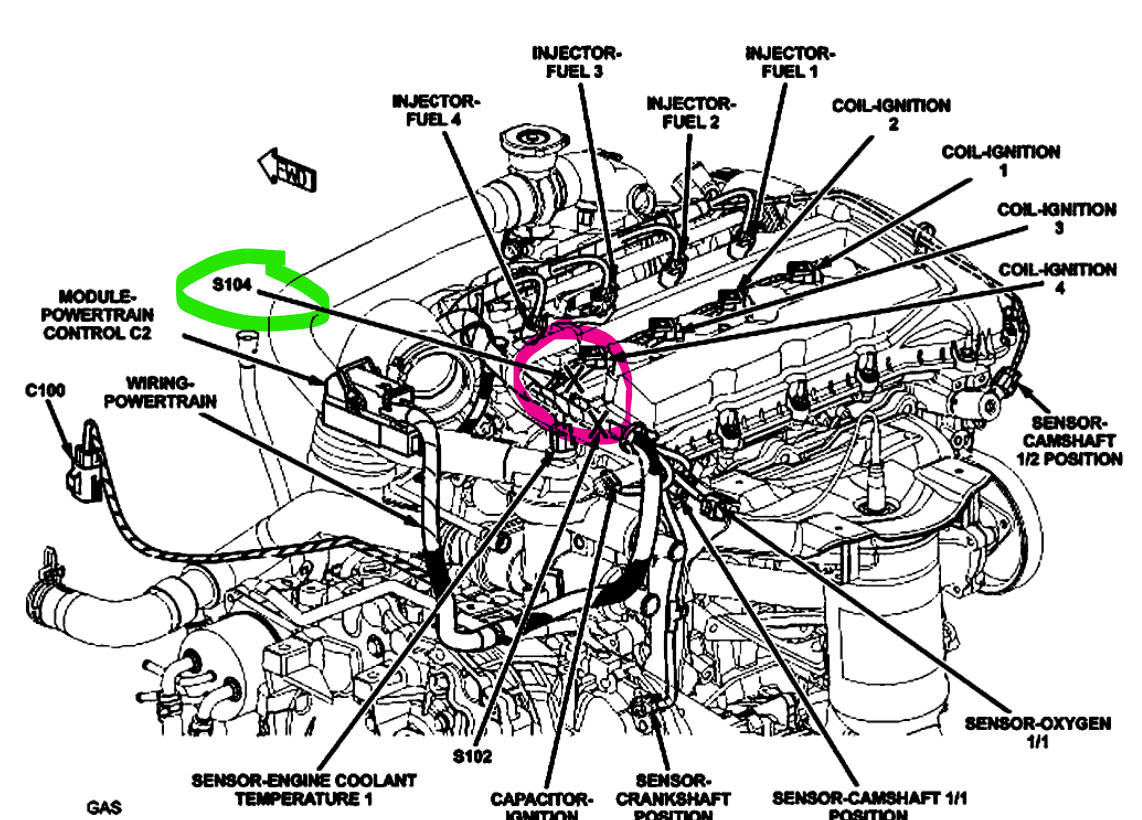

Here's the splice, its S104 circled in purple. Thats where the 4 wires for the coils meet up.
All of these brown/grey wires are on the same circuit. The dotted line just means they're attached together.

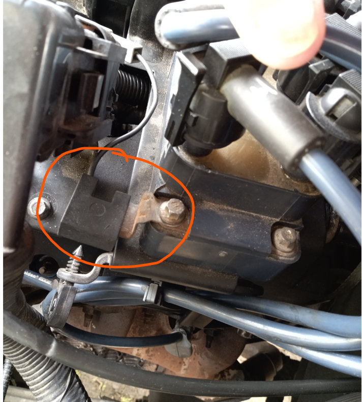

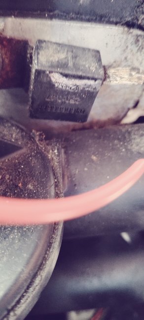

Hey Al, is s a little box mounted at top of the thermostat housing? If that's it mine only has two wires and the plug. I'm trying really hard to do this right. I just can't come up with a plan on the hot wire for each coil. I'm almost to the point of jumper wires to ign. Acc.

I don't know if you got my last message but are we talking about the caliber SE? And is the capacitor the little box with a one wire connector? Back side engine. Driver's side. Above the thermostat housing? If so I don't get it. There's only one wire connecting
To that box. I have run new wires for all the grounds see if I can get you a picture of what I'm talking about. I sent you 3 photos.

Do you have the brown/grey wire? What I circled is where the splice is for those brown/grey wires. It branches off there to each coil and to the coil capacitor. What exactly did you take apart? Where I circled in purple is the wiring harness, it will be wrapped up in a plastic shielding. Inside of that is where these wires splice together. There's no need to run wires from anywhere else. That wire powers the Fuel Injectors and Ignition Coils. If you can take a picture of what you have going on there so I can get a better idea of what you're asking. I'm not sure what you really did to begin with.

Okay, so someone before you may have replaced the coil power feeds is what you're saying. I went back to your original post. But yes, that wire that feeds the #1 coil also feeds the other 3. it will be the same wire on each connector for the coils as the #1 coil. The other wire on each coil is a different color because that is the control wire for that coil going back to the ECM.

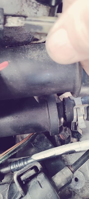

Sorry the picture of the engine was to give a general idea of the location of the splice. In your first picture it looks like someone has made a mess of the wiring harness. The third picture does look like the Capacitor.
So, the brown/grey wire that is powering the first coil, you can power the rest off of that wire. The Capacitor is on the same power wire as the Ignition Coils because it cuts down the noise on the circuit. The Ignition coils produce thousands of volts of electricity, so the capacitor absorbs a lot of the electrical noise that is produced on that circuit, without it you would hear the coils firing through the vehicles' electrical system and through the radio. It could also send high frequency signals that could distort signals from other sensors that the engine computer is monitoring. So that's the purpose of the Capacitor. Is your concern about how to splice the wires together? I can see it looks like quite a mess there.

Yes. And with the engine running you can grab the harness feeding anyone of the coils and it causes the engine to misfire. So now that I have the concept
Of what needs to be done. I think first I need to buy four new harness connectors. Do you agree? Secondly, I need to know what's the best method to splice these new connectors? I'm Mainly interested in the hot wire on each connector because all of pulsating wires are all easy to locate and reconnect. My main issue is in this one brown wire and tying four coils into that one wire. What's best here? Cut the brown wire at different spots and connect the hot wire of each connector to the brown wire? That's a lot of cuts in wire that's only approximately 2 ft. In length. Any input is greatly appreciated. I'm not good at electrical issues but I'm slowly understanding ... This car has never run without a misfire on number 4 cylinder since I bought it a year ago. It comes and goes. But it's gotten worse.

Well, whatever that glued spot was on that wire is not the correct way to fix a wire and my concern would be corrosion building up inside the feed wire for those coils. All it takes is a pin hole in a wire and after 6months to a year you will have green corrosion inside that wire, and it just keeps going up right inside the wire. You are smart to replace part of that feed wire. I will put together a small example really quick to show you how I would fix this. It would be difficult to splice 5 wires together especially in that case they should be soldered together, then heat shrink wrapped. give me just a minute.
This connector is the one I showed you in the first picture up top. Notice on these connectors when the heat is applied the connector end shrinks down around the wire, and if you can see it, there is glue that comes out as well. These insulate the wires from weather and moisture. The yellow ones are the larger size, these are made by Dorman and I got them at my local AutoZone. I think without soldering this is the best way to repair the wiring you need to. You may want to replace the wire from the 1st coil where you have power but make sure the Capacitor is included in the circuit before the coils. I know you have a mess of wiring there, but just do your best to sort it out and be sure you only connect to that one Brown/Grey wire and run to the other coils from there.

Where can you buy those? What's the manufacturer's name? I have never seen a connector like that, but I like it very much. Thanks. JC

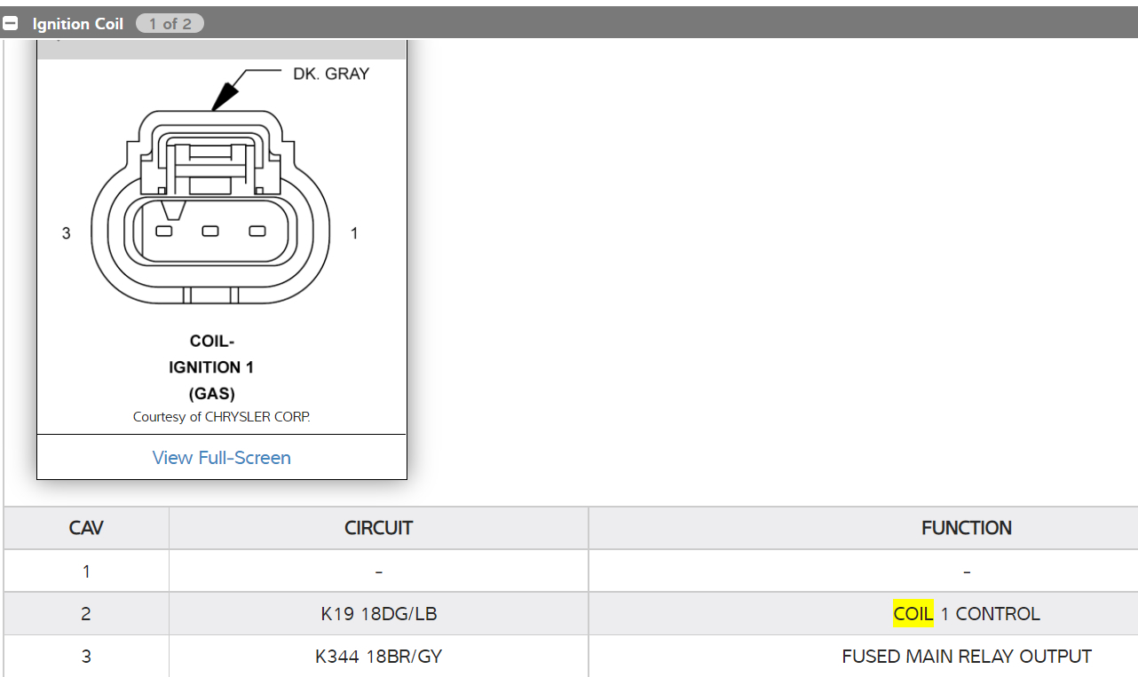

You may not need to replace all the connectors, are all the power feeds to the coil's different colors? The only coil wires that should be different colors are the ones that control the coils going back to the ECM.
The connectors are heat shrink butt connectors, AutoZone or Advanced auto has them. Or your local parts store, just ask, tell them that's what you need.

okay, if it's the inside wire, the power wire is same on all the coil connectors.
Dec 27, 2021 at 8:22 PM
JC-842
  • 181 POSTS
That's correct brown/grey.
