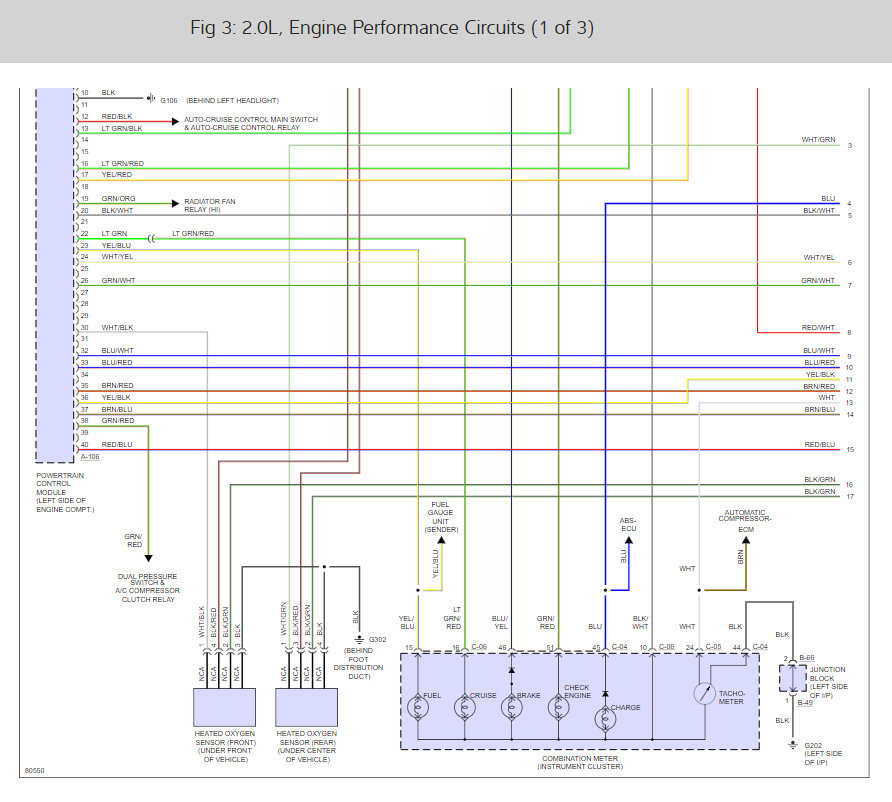

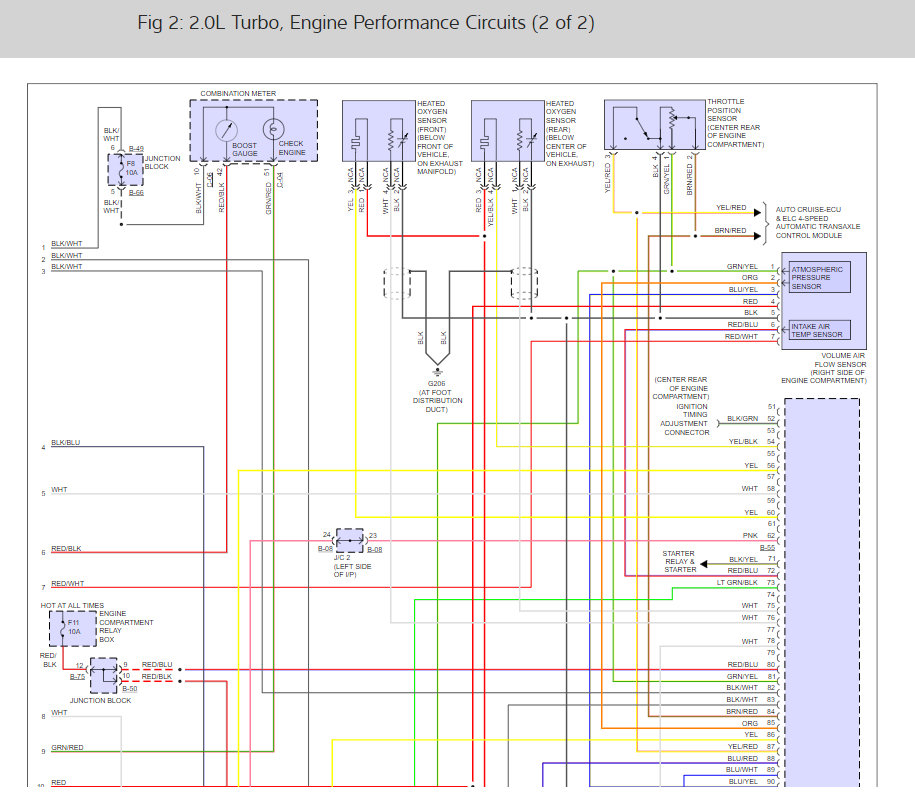

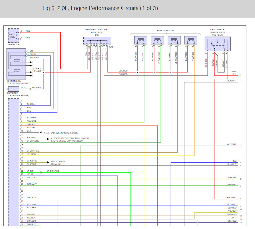

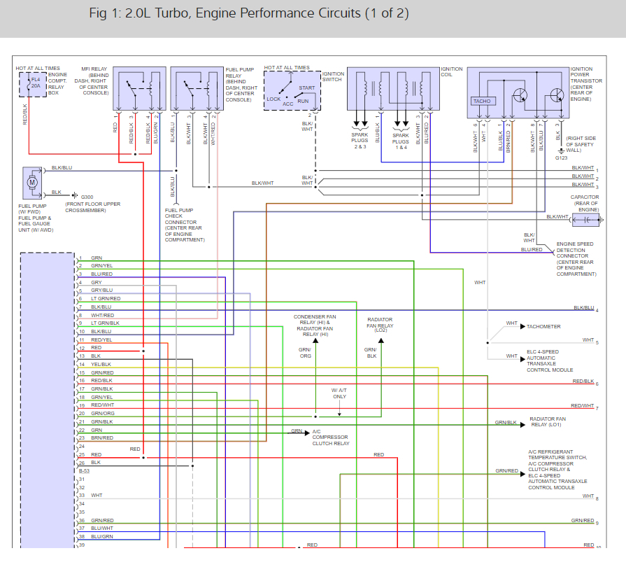

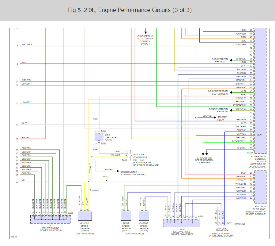

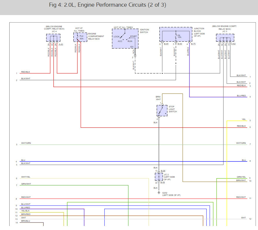

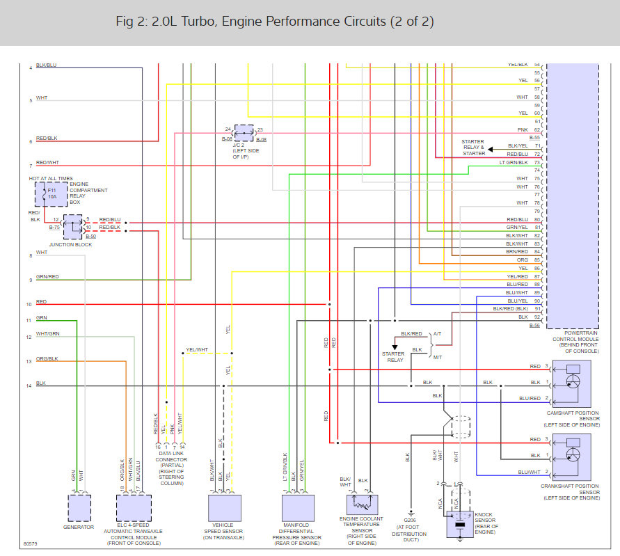

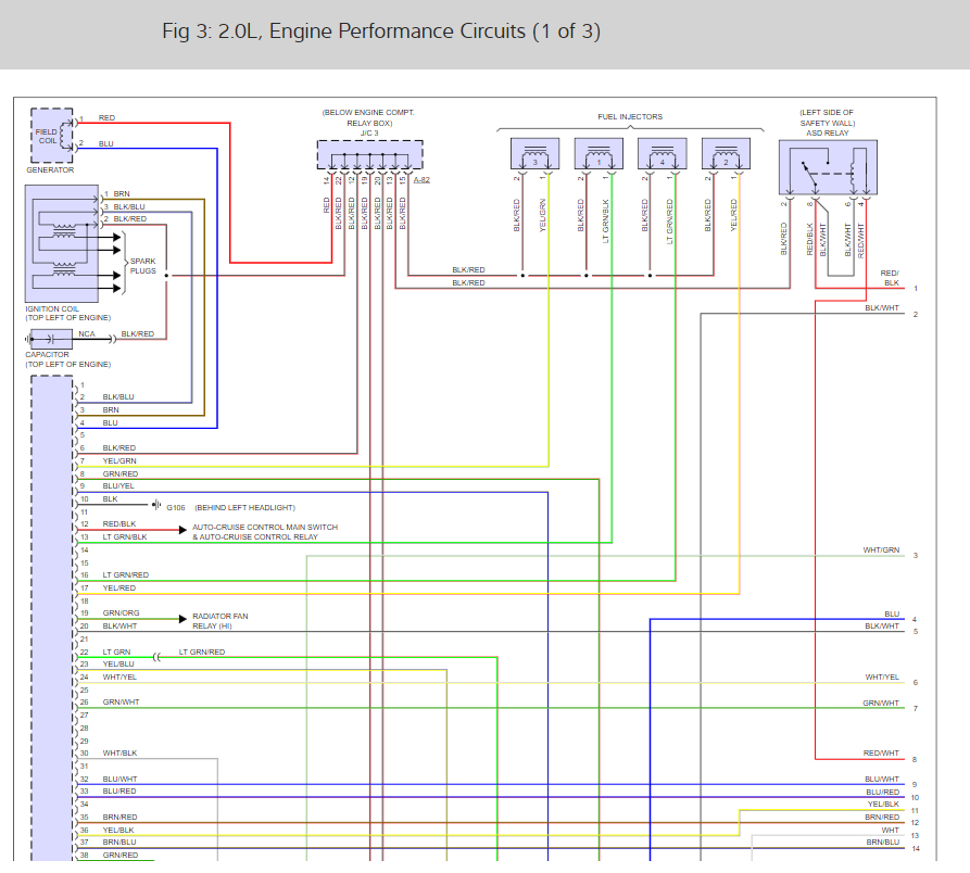

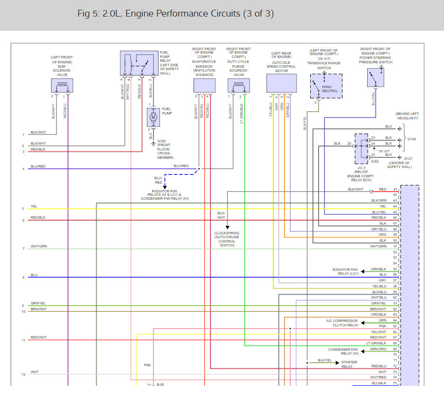

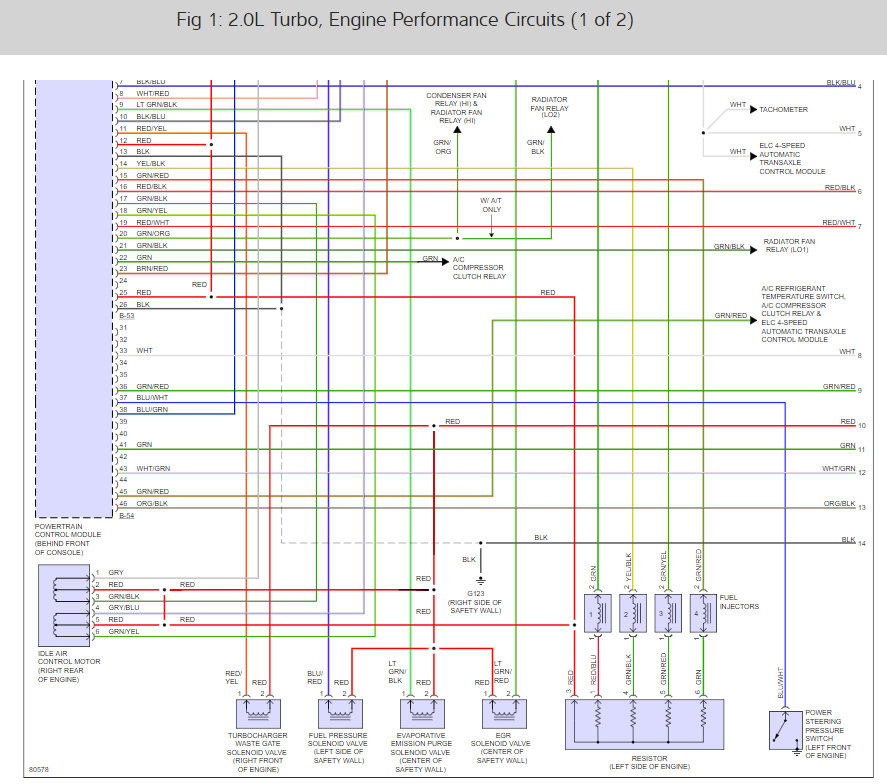

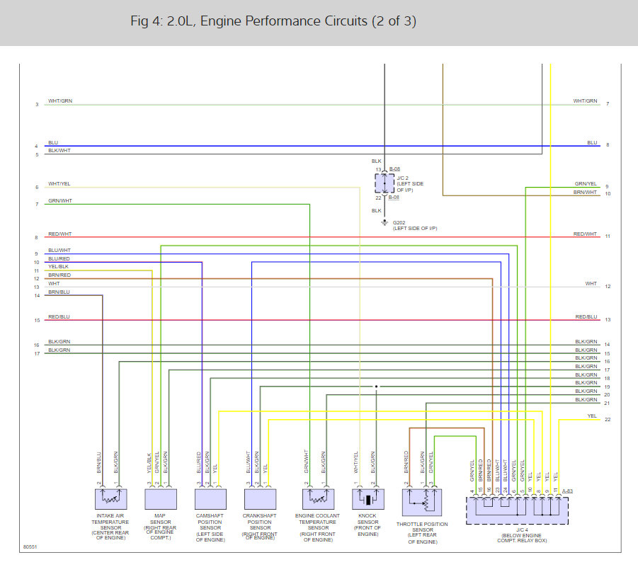

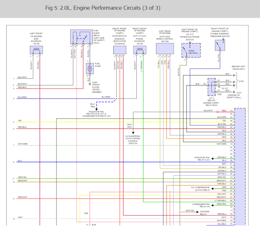

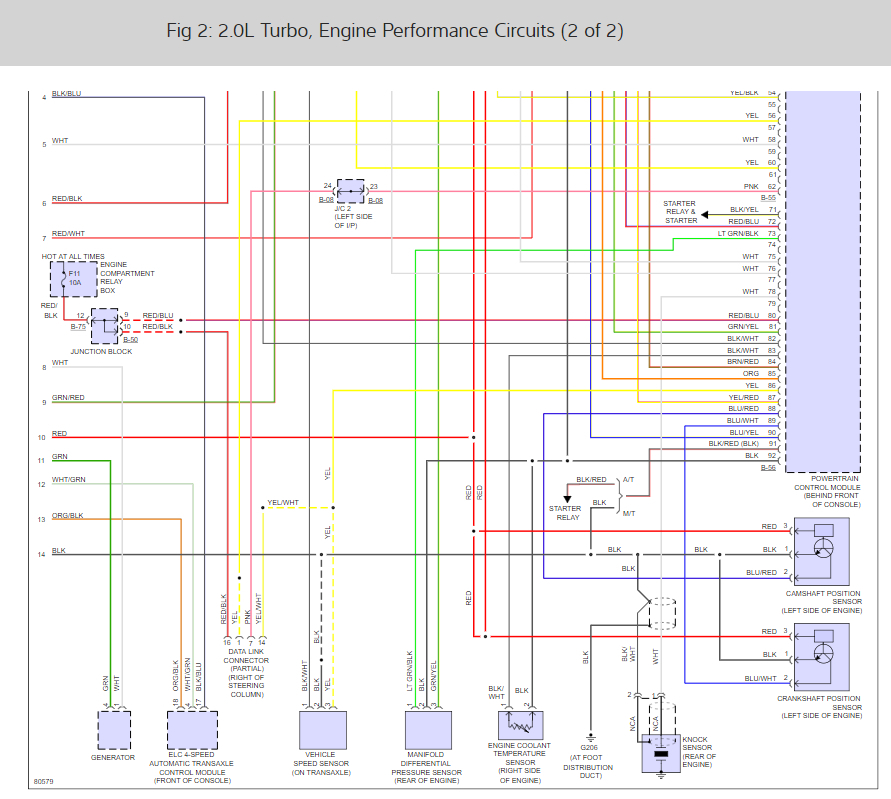

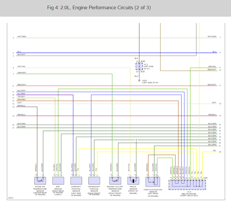

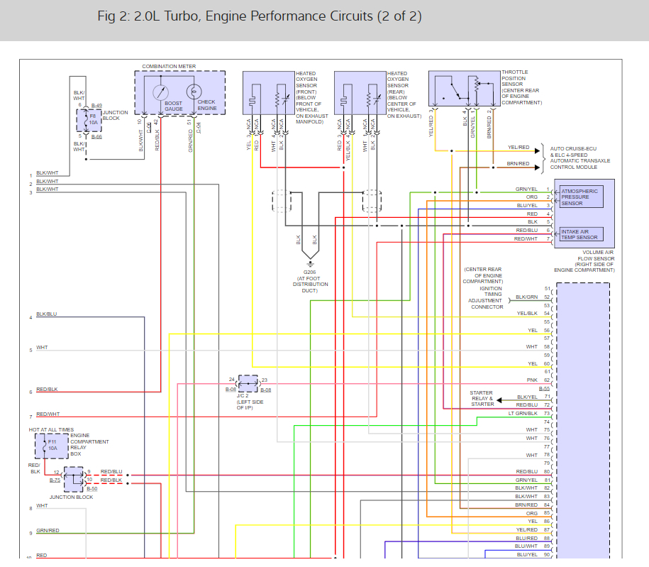

I found you both turbo and non turbo engine wiring diagrams. If you have any problem please upload a video or picture of what you are looking at.
Oct 17, 2018 at 11:05 AM
96RS
  • 7 POSTS
It is a 420a n/t. Which diagram do I use ?

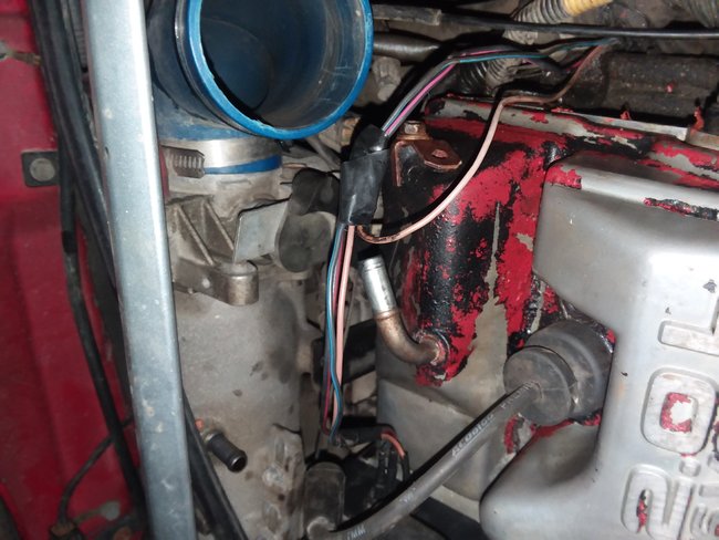

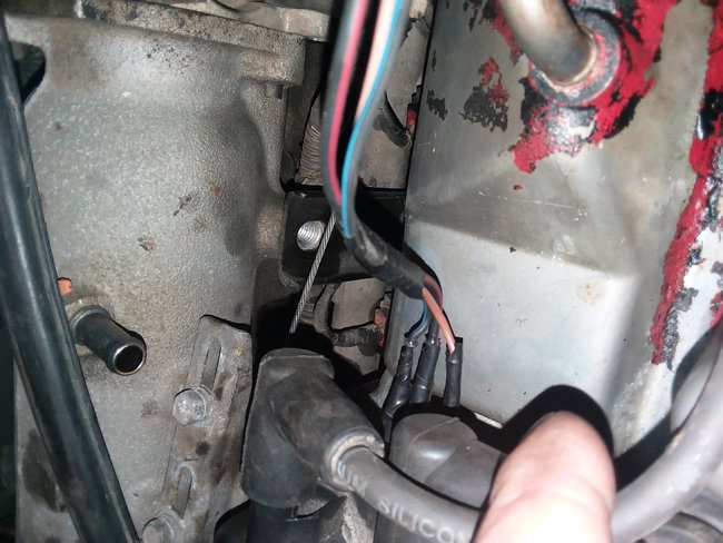

This is the wiring that I have extended.
Oct 17, 2018 at 7:06 PM
Nice work, do you have a turbo? If so use the first set of diagrams of not use the last set.
Oct 18, 2018 at 9:41 AM
