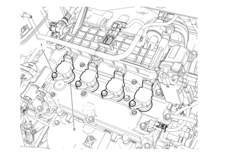

I just need to know which cylinder is cylinder number two. Had a code p0302 which means misfire in cylinder two. While looking at the engine. From the top. Does the cylinder go 1234 or 4321. Basically which one is cylinder 2?

I attached a picture for you to view. cylinder 1 is marked for you.
https://www.2carpros.com/articles/engine-misfires-or-runs-rough
it goes 1-2-3-4,
