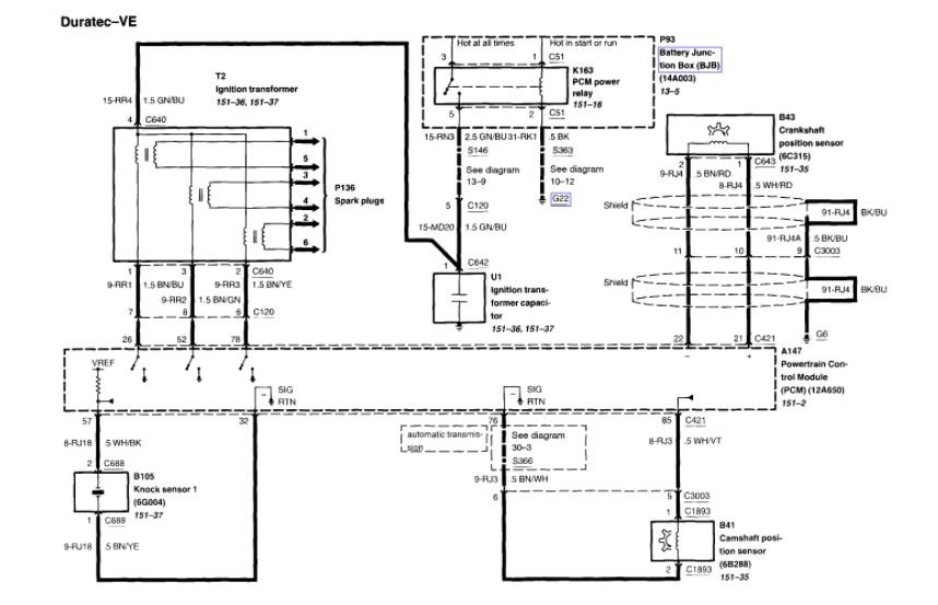

Good afternoon.
I attached the test below for you to view for testing for no spark.
