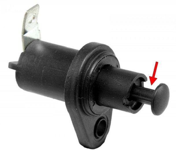

Once everything is hooked up and the computer has gone to sleep, you'll need to remove one fuse, then look at the meter to see if current dropped significantly. It's customary to start at the fuse box inside the vehicle, so you'll need to do something to prevent the interior lights from turning on. That could involve removing the driver's door switch and unplugging it. A lot of them now are built into the door latch assembly. For those, just use a screwdriver shank to trip the latch closed.
