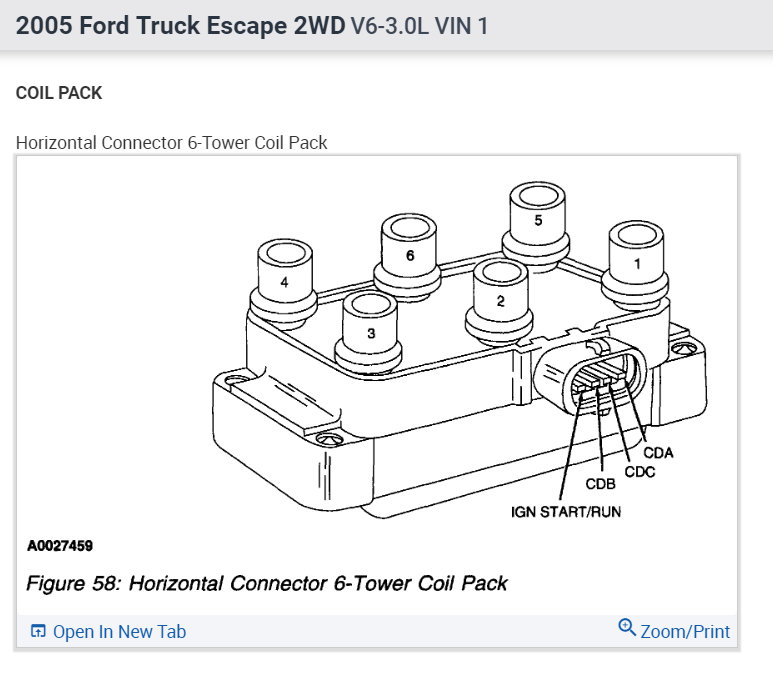

That would be bank 1, cylinder #1 firewall side front of engine, the intake will need to be removed to access it.
May 6, 2019 at 2:40 PM
CERTIFIED EXPERT
53,854 POSTS
Here is a diagram of the ignition coil and a video on a similar car to help you change the coil out with diagrams below:
https://youtu.be/iDgXwKA-IIc
Check out the diagrams (below). Please let us know if you need anything else to get the problem fixed.
