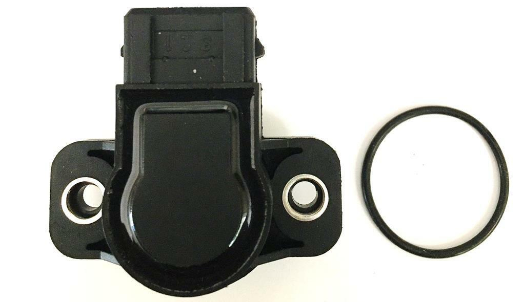

I would suggest first checking the TPS connector. Ensure that there is no corrosion, and the pins are in good condition. The TPS is located on the side of the throttle body, image 1.
It has a 3-wire connector.
Pin 1, blue wire TPS signal back to PCM pin D14.
Pin 2, pink wire 5V power supply.
Pin 3, black wire ground/low reference.
Using a voltmeter, you can check 5V supply and ground, also check signal wire back to PCM.
