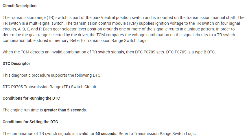

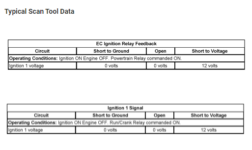

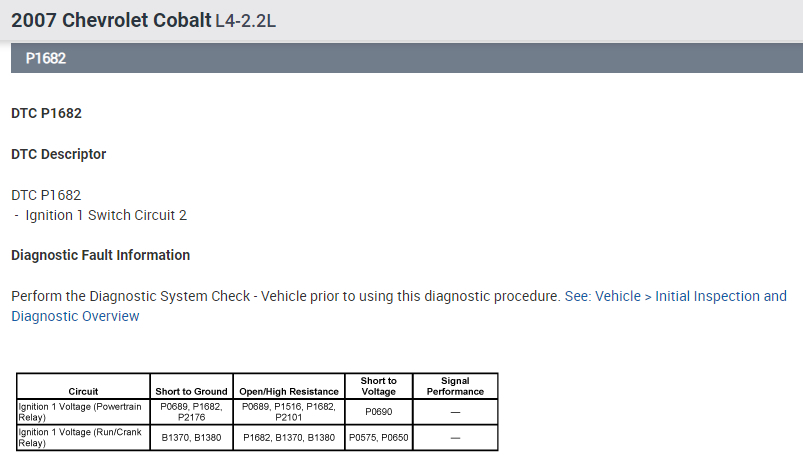

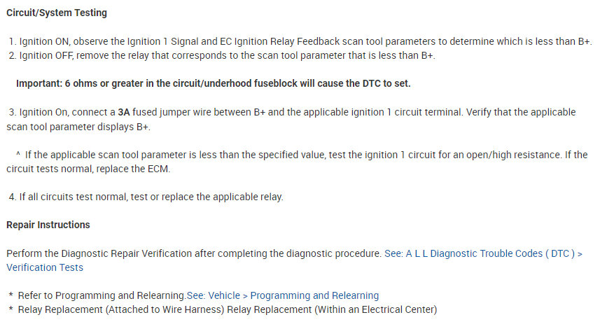

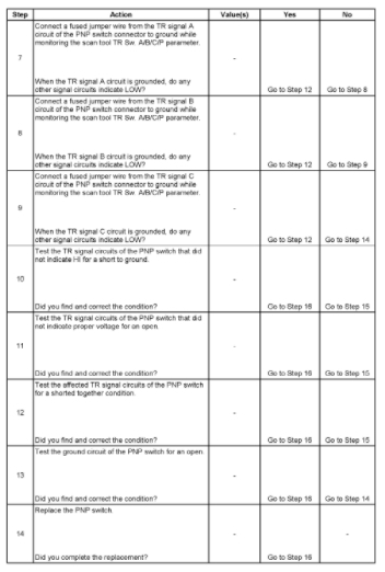

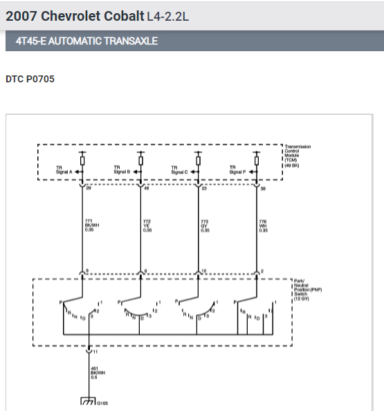

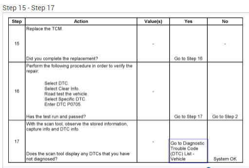

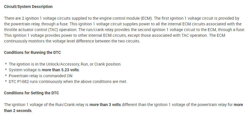

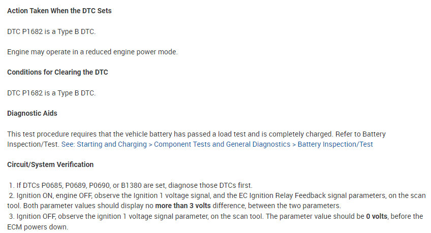

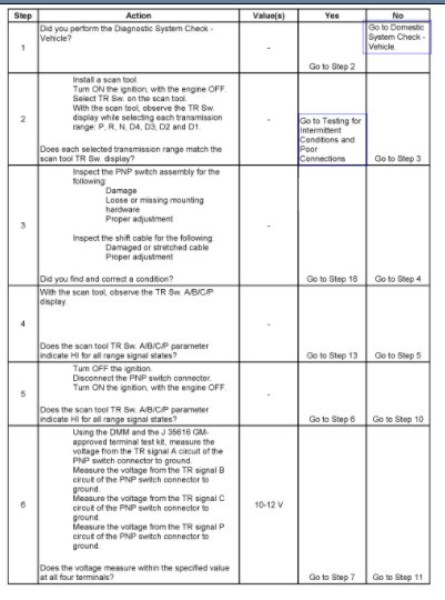

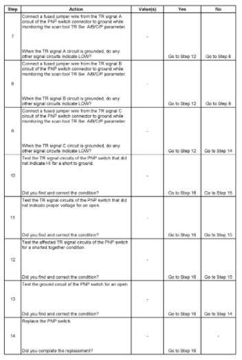

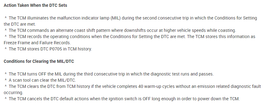

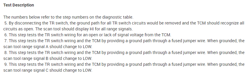

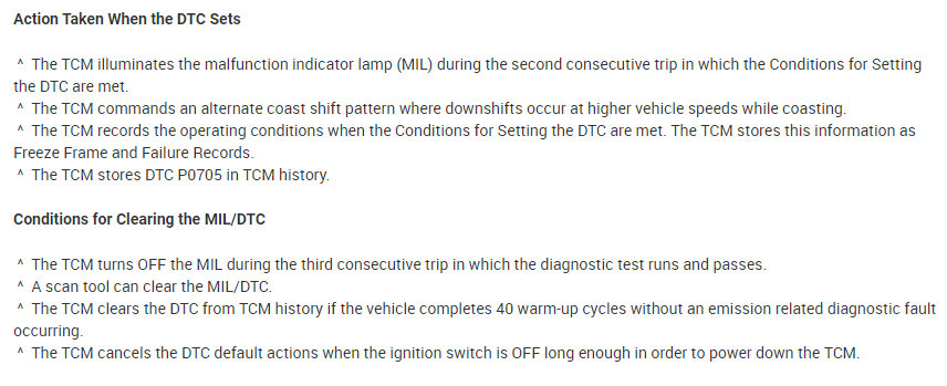

I've attached below the code information for both code P1682 and P0705. Code P1682 has to do with ignition voltage being supplied to the ECM-engine control module via a fuse controlling the throttle actuator control operation. Code P0705 has to deal with the transmission range selector and shifter operation. I've attached the code information below with picture diagnostic flowchart steps for your car. Get back to us with anything you find and we'll go from there. Hope this helps and thanks for using 2CarPros.

You obviously took the time to thoroughly read the information provided. I want to thank you in advance for your quick response and the information that you've provided. I will review everything and let you know how things are progressing.
