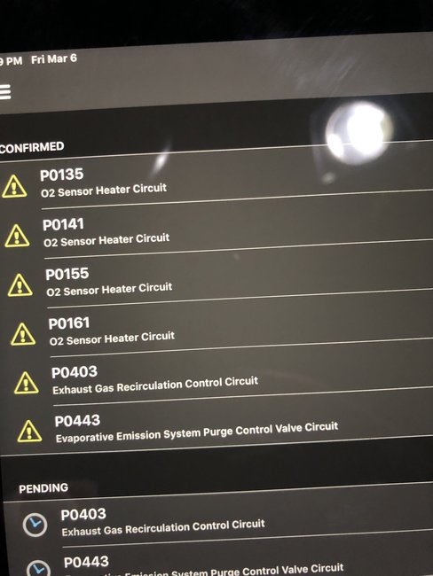

I have an issue with all the sensors on the same circuit: all four O2 sensor heaters, EGR and PCV, see picture for codes. I checked the fuse (#42) and it's okay.
I replaced all four o2 sensors and the EGR only to discover that they weren't the problem!
I recently pressure washed the engine, maybe a connector got wet and corroded?

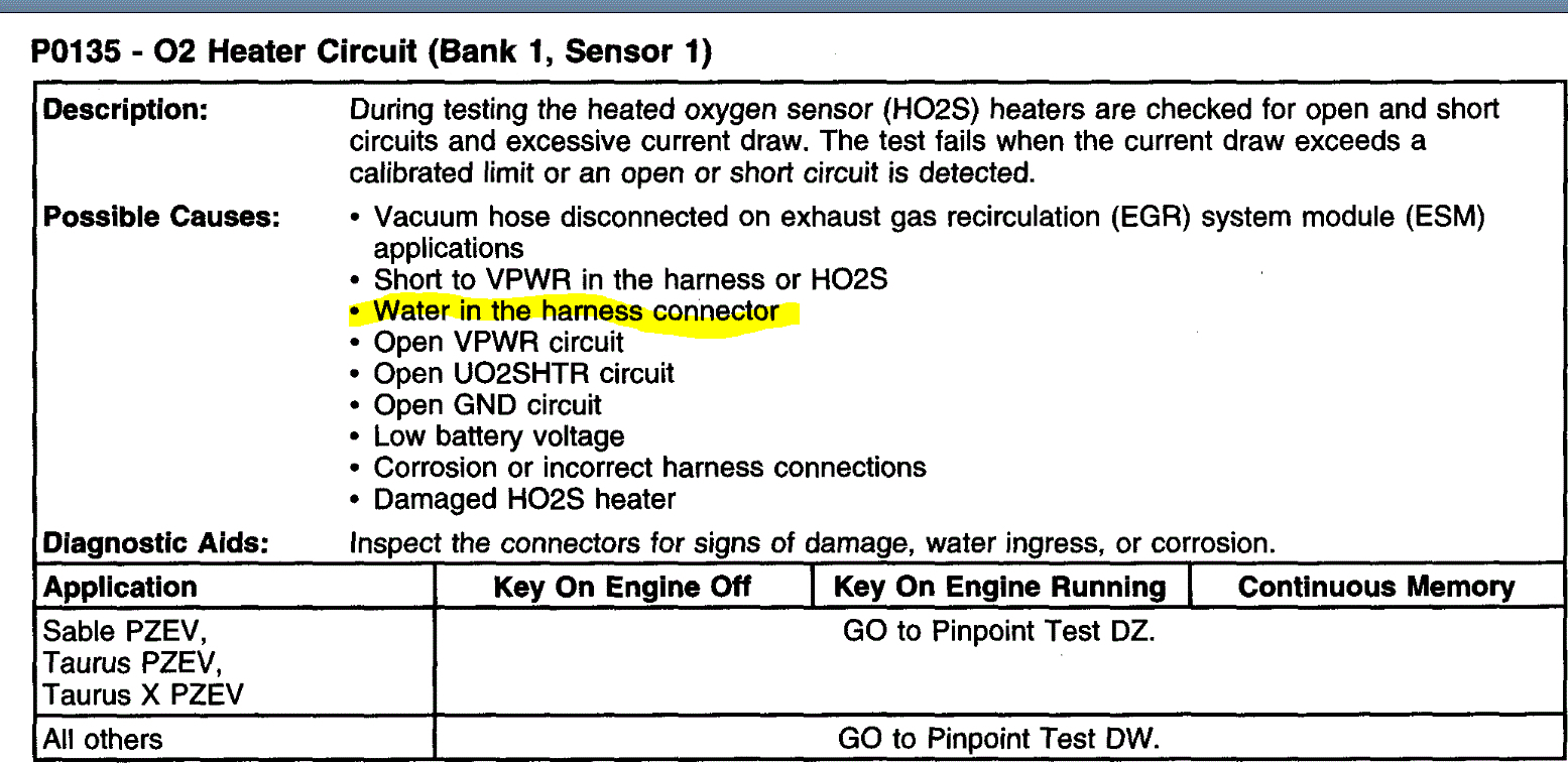

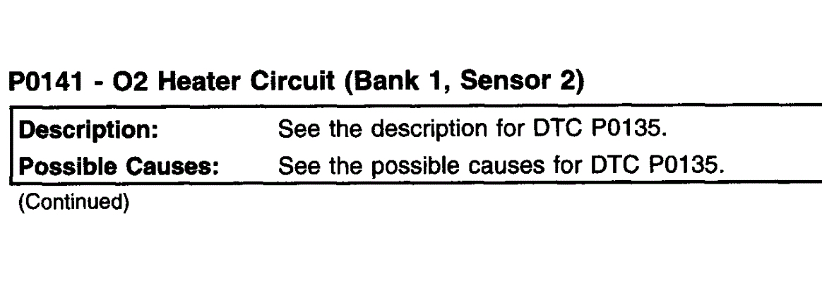

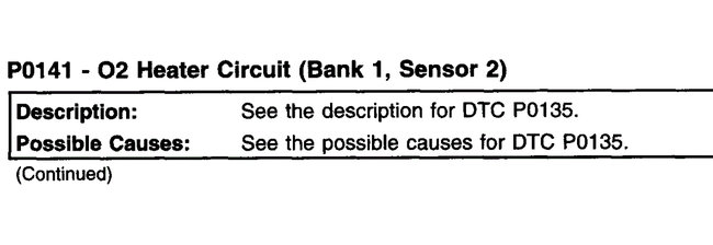

Did this start after pressure washing? If so, check all connections for water. I looked up every code. I looked up each code and the P0141, 155, and 161 start with saying check for possible related causes to P0135. See picture 1.
Now interestingly, if you look at pic 2, it shows the possible causes of a P0135. Note the one I highlighted. This is where I think you need to start. I feel water is causing a short and setting all of the codes you have.
Do this and let me know what you find.

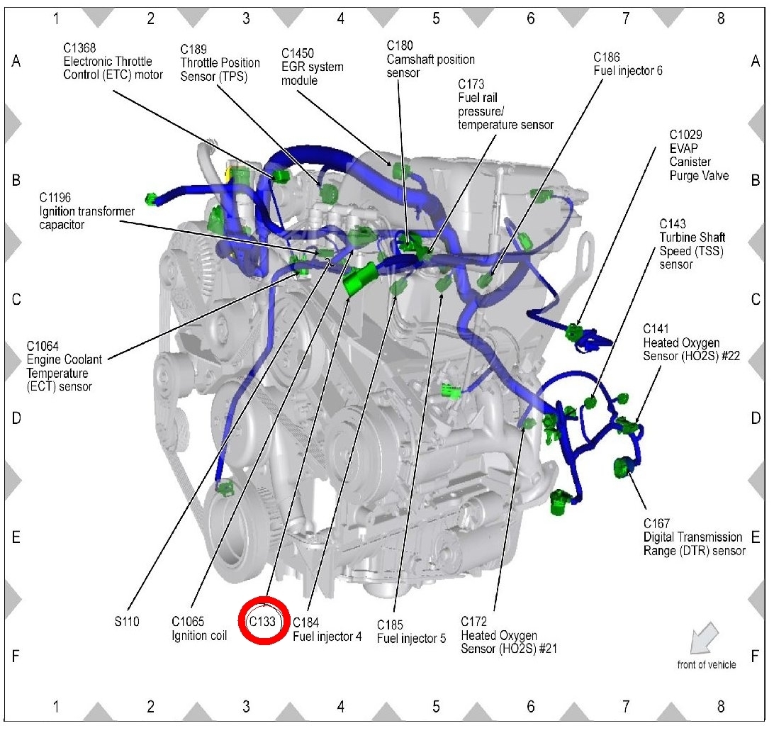

I was thinking that one of the connectors got water in it, according to this picture could it be connector #C133?

And where is that connector? I can't see it on the drivers side of the engine.
Apr 24, 2020 at 10:34 PM

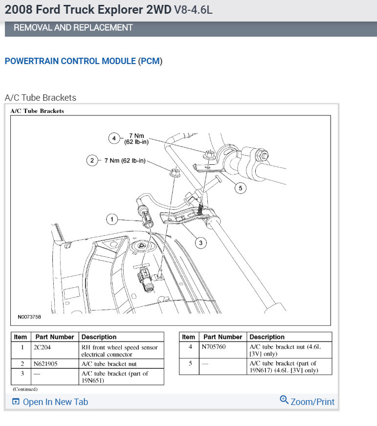

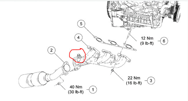

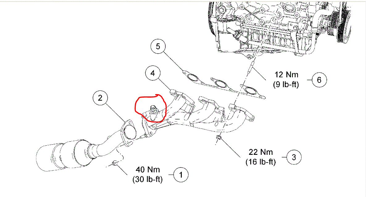

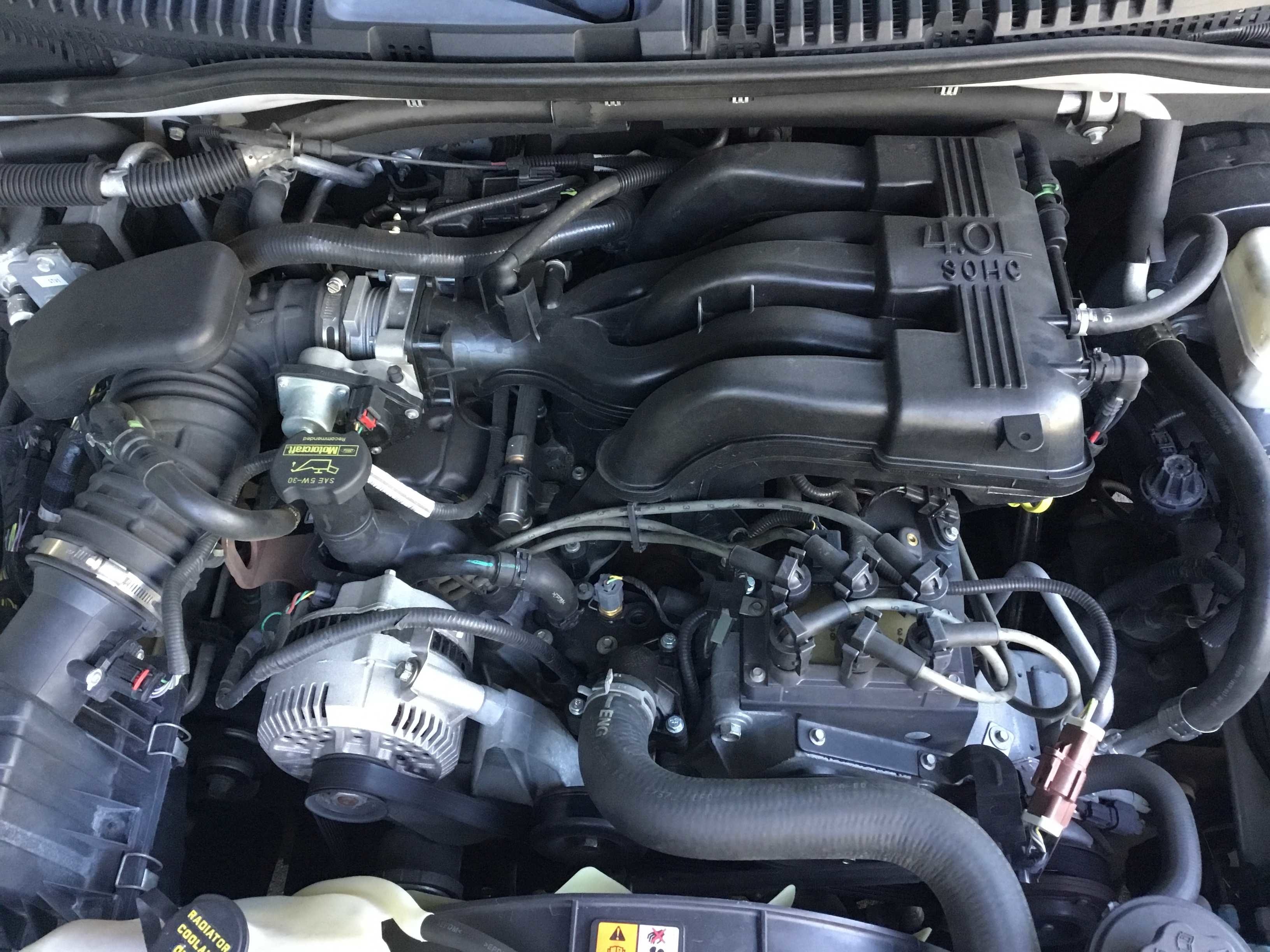

Bank 1 will be on the passenger side of the vehicle. I attached a picture of where sensor 1 will be located.
Let me know if this helps.

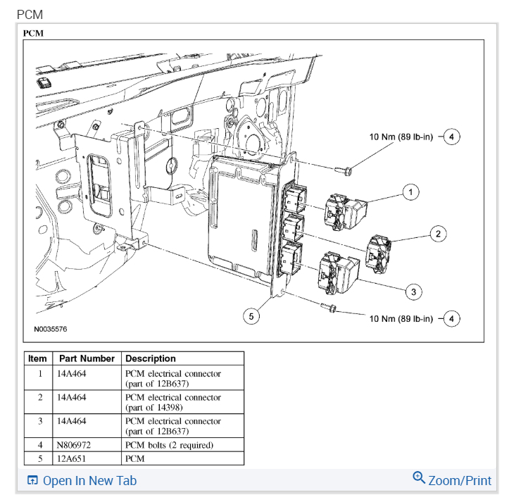

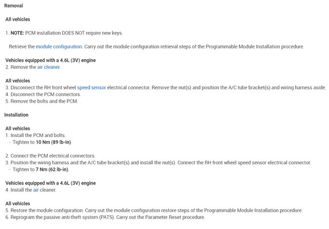

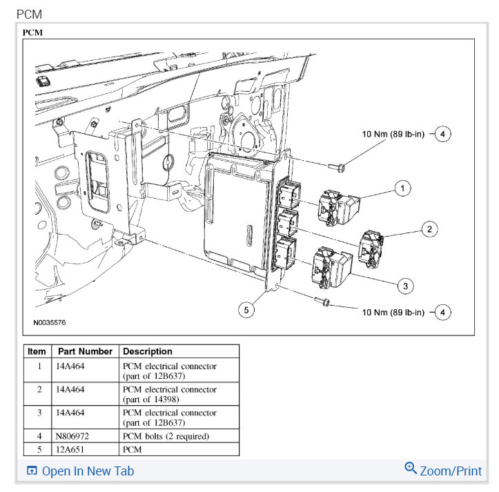

I have seen this before. please check the PCM connector and if okay the PCM is bad. What happens is the oxygen sensor heater driver goes out. Here is how you replace the PCM in the diagrams below:

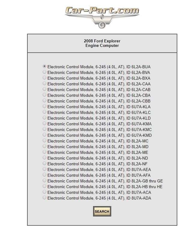

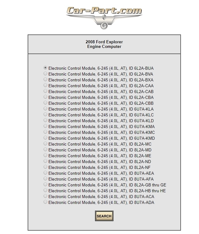

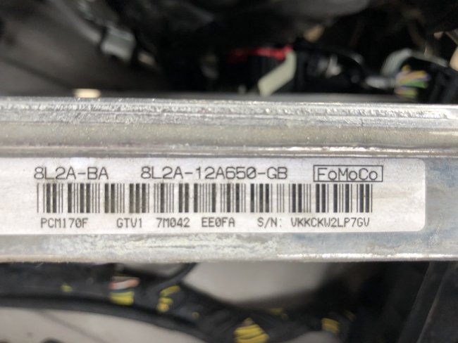

If I need to replace the ECM, how do I know what version I have?
Apr 28, 2020 at 4:47 PM
TYPE85
  • 24 POSTS

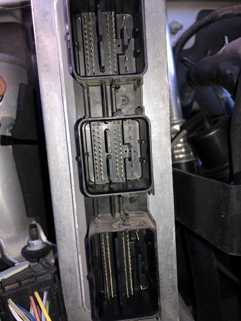

Also, connectors and pins look good on the ECM, no corrosion.
When you remove the PCM it will have a version number on it. If you can upload a picture of it so we can see.
Apr 29, 2020 at 9:46 AM
TYPE85
  • 24 POSTS
Pulled the ECM, looks like it's an "8L2A-BA".

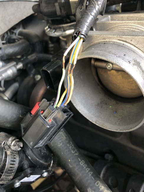

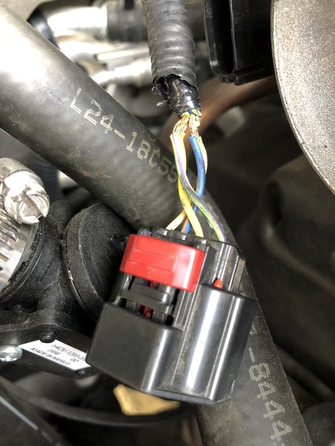

More importantly, I think I found the root cause of the issue: in February, I had replaced the heater valve (before the check engine light came on) and had to disconnect the rear sensor on the throttle body. Today after removing the ECM, I noticed the insulation on the wiring was crumbled, there was a spot where all the wires were exposed. I'm sure they were touching and shorting out! The insulation must have fallen apart when I was replacing the heater valve and causing the issue with the ECM.
The question is, did this burnout the driver for the o2 heaters, EGR and PCV valves??
PS, I re-wrapped the bare wires, installed the ECM, the engine runs fine but after a few cycles of the ignition, the same codes came back.
Apr 29, 2020 at 9:15 PM
yep, that will do it. I would check the rest of the wiring harness as well, if no other issues replace the PCM. When wires are shorted like that it will cause the PCM to go out. Let us know what happens.
