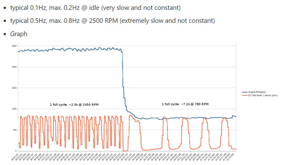

The picture below shows the oxygen sensor signal, in the first half you can see the switching is fast, but the 2nd half is an example of a slow, lazy switching sensor.
With both Banks of the engine setting the same code, it is either something affecting the entire engine, or some just affecting both front sensors, i.e. the heater circuits.

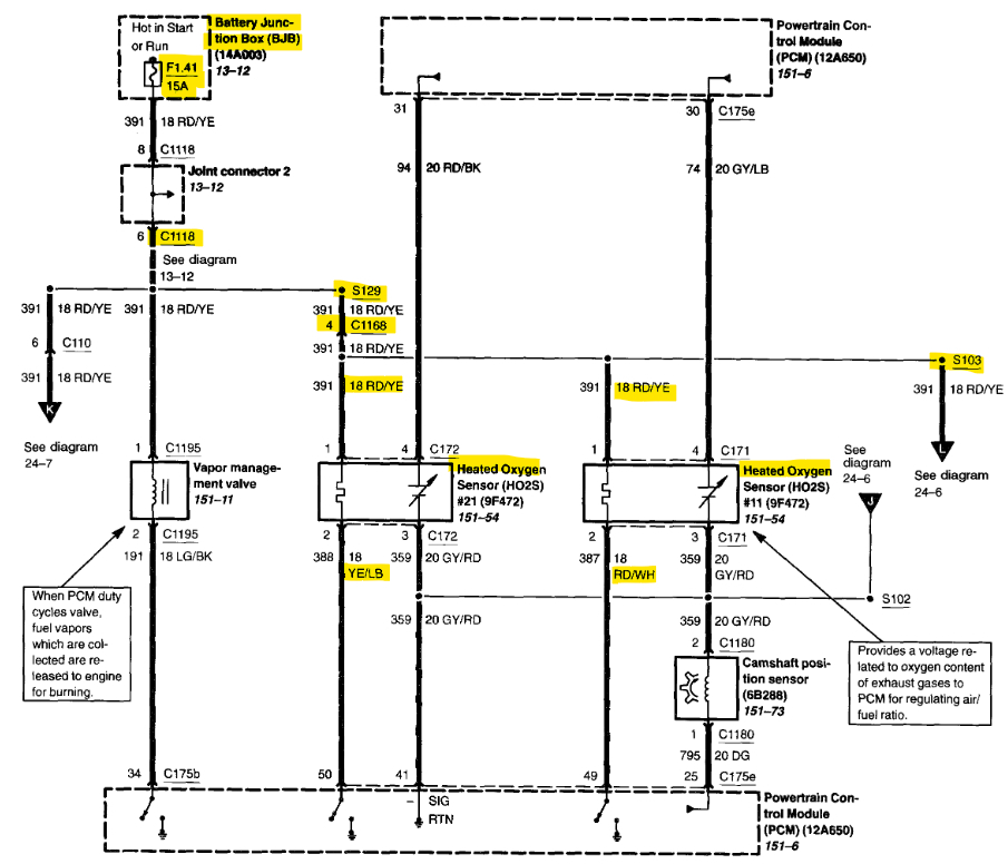

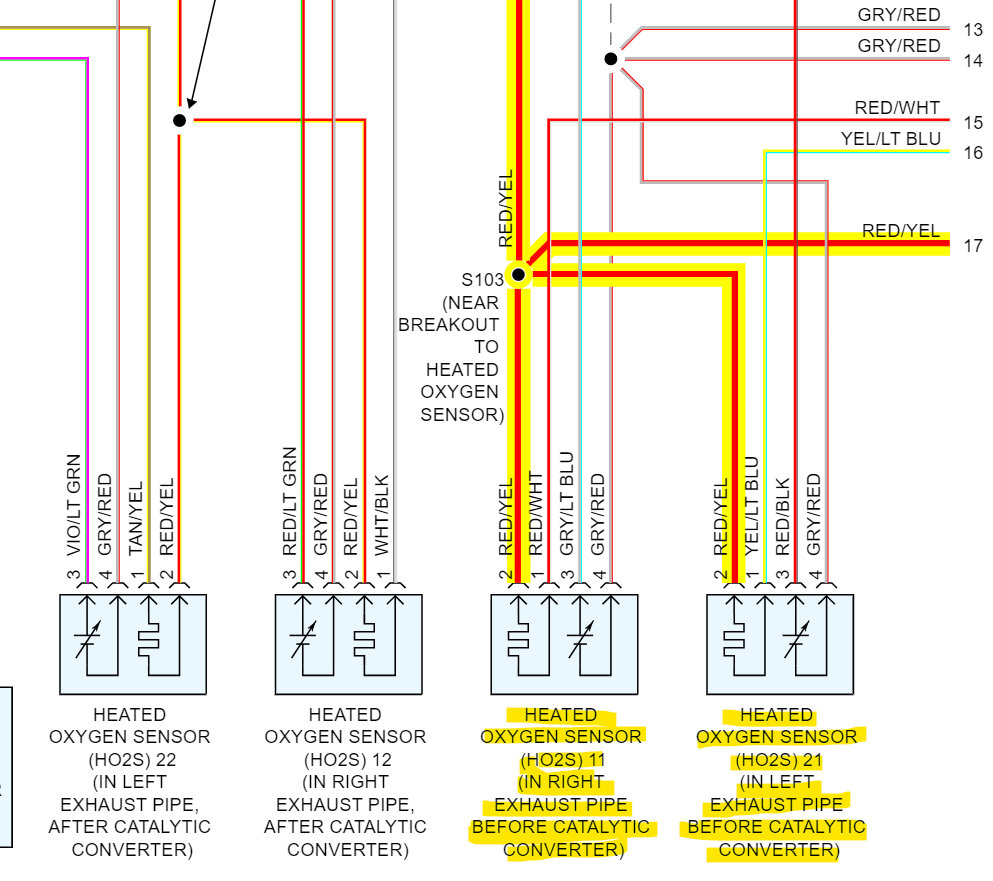

The diagrams 2 and 3 below are for the Oxygen sensor heater circuits that are setting the codes. The 3rd diagram is the same as the 2nd one it's just the manufacturer OEM diagram to verify the wiring colors were correct. The 3rd one also shows that there are a couple of connectors and splices in the wiring going to those sensors, so a corroded connector can cause issues like this as well.
