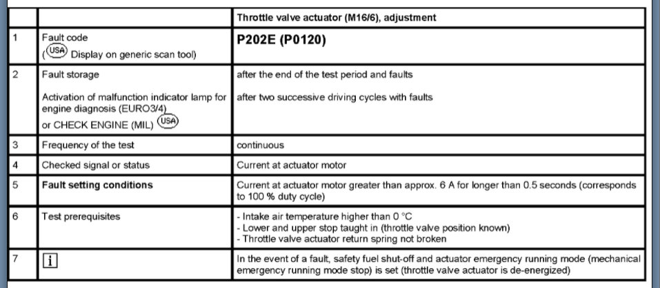

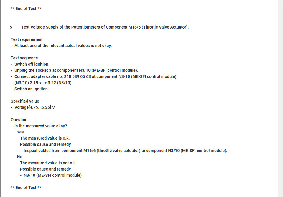

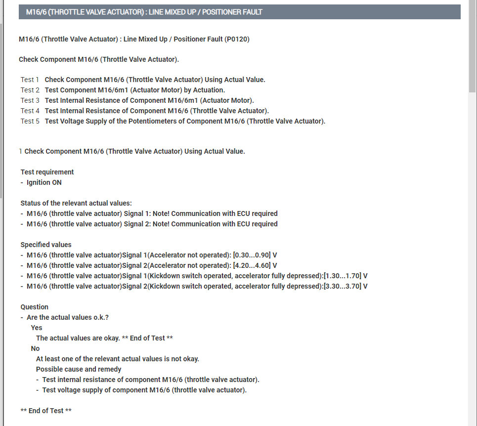

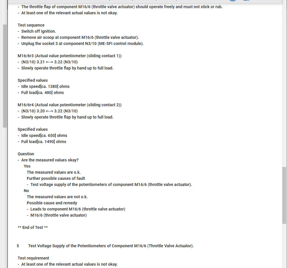

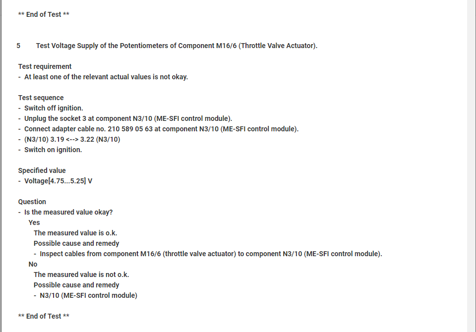

This car have no acceleration more than 2000 rpm's. Throttle body and throttle pedal has been replaced with used. same problem continued!
Any advice please.
